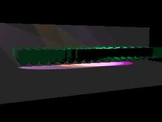

Image showing light refraction of inverted lenticular, but
Even though I have color set up white, my transparent material turns green.

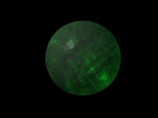

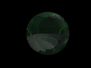

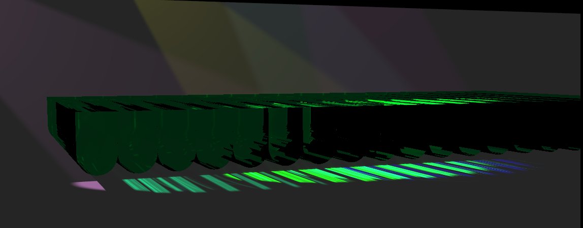

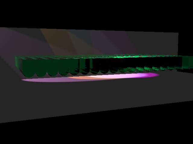

Getting closer to this problem with a smaller object - it seems the normals
are all messed up - got one image that looks like the ghost in the machine.
Suspecting the converter so , am now trying with the normals exported also
and parts of the sphere are now non coloured, but still some weird green tis
there. See pic 1&2.

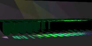

I found the problem, or at least the solution, still dont understadn where
the green came from, but I had dispersion on and for some reason my shapes
always dispersed to green.  With dispersion 1.0, the green goes away.  Stil
some eird textures inside my spehere though.
        interior {ior 1.10 dispersion 1.0 dispersion_samples 7}

Simon Dyer nous apporta ses lumieres en ce 2005-12-11 03:55:
dispersion 1 = NO dispersion

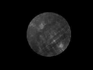

the global_settings block (in your file "lent_test3_a.inc") you'll get an
image like this (no_photons.png).
And, perhaps if you use this include file perhaps set:
count 1000000
instead of
space 0.03
That'll reduce the number of photons to 1 Mio and renders much faster. Do
this at least when you're testing.
Your last posting:
I don't know what this test sphere is all about.
To your idea with the normals:
See next post.
Yours,
Bu.
Aha!  I think i found something.  I had suspected that dispersion had
something to do with it, and your dispersion 1.0 trial confirms it.
From lent_test3.pov:
> interior {ior 1.10 dispersion 1.2 dispersion_samples 3}
I've noticed that photons don't quite honor the dispersion count; it is as
if the photons undercount the dispersion_samples by 2.  With your
dispersion_samples set at 3, you'll only have one color to work with--the
middle color of the spectrum, *green*.
(I haven't attempted to report this as a bug because it's less painful to
increase dispersion_samples by 2 than to bother the POV Team.)
Also, be careful with your dispersion compared to your ior.  At ior 1.1
dispersion 1.2, if i understand this right (not guaranteed!), the red will
not refract at all.
Subject: Re: Green photons render
Date: 13 Dec 2005 20:17:07
Message: <439f7293@news.povray.org>
Cousin Ricky nous apporta ses lumieres en ce 2005-12-12 22:15:
> not refract at all.
You prompted me to do a small test:
	interior{ior 1.2 dispersion 1.5 dispersion_samples 44}
Using a simple prism with rgbt 3 to boost the spectra brightness.
The red does refract a little. If I raise the dispersion to 1.6, the red refract UP
