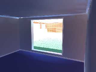

I'm trying to get radiosity working right (as per post in .General) and
have included my radiosity settings below.
However the real reason for this post is the strange lighting effect
that is showing around the architraves in the room shown below.
At first I wondered if there was a tiny gap between the top of the
architrave and the wall, however there's not. I've made sure the overlap.
What else could be causing this weirdness?
I can provide the full source upon request, but there's a lot as the
whole house has been built and is getting furnished :)
		radiosity {
			pretrace_start 0.08
			pretrace_end   0.04
			count 85
			nearest_count 5
			error_bound 1.8
			recursion_limit 12
			low_error_factor 0.5
			gray_threshold 0.0
			minimum_reuse 0.015
			brightness 1.2
			adc_bailout 0.01/2
Download 'house.jpg' (136 KB)
Preview of image 'house.jpg'

From: Rick Measham
Subject: Re: Strange light behaviour
Date: 6 Sep 2005 02:50:03
Message: <431d3c1b@news.povray.org>
Xplo Eristotle wrote:
> Holy crap!
Excellent! I've always wanted to extract a 'Holy Crap' from someone :)
OK, I've brought those values back to your recommendation, but then
things started getting really really weird. So I decreased the amount of
light flying around (my sun was at White * 40, and the skysphere was
(some blue)*5).
Now the interior of the room is almost pitch black.
I've also tried adding the tiniest amount of reflection and fairly heavy
diffusion to everything in the hope of getting it looking better.
I'm going to look at light_sys once I get a chance, but I'm really
interested in why this isn't working.
(You'll notice in the corners, there's still a little brightness, and
there's still strange patterns there ..)
Cheers!
Rick Measham
	radiosity {
		pretrace_start 0.08
		pretrace_end   0.04
		count 85
		nearest_count 5
		error_bound 0.5
		recursion_limit 2
		gray_threshold 0.0
		minimum_reuse 0.015
		brightness 1.2
		adc_bailout 0.01/2
Download 'house.jpg' (114 KB)

From: Tim Nikias
Date: 6 Sep 2005 04:56:30
Message: <431d59be$1@news.povray.org>
I guess there are a couple of problems.
1: The room you're looking out from is in shadow from the actual
lightsource, so it is lit ONLY by radiosity.
2: The door looks out to the opposite wall of the house. Add that to 3...
3: A count of 85 tends to "overlook" things.
If you'll look at the far room, it gets lit properly. So the reason why the
current room is so dark is because radiosity sampling doesn't find anything
bright! Try moving the lightsource so that some of it enters the room and
you'll notice the difference.
What I'm suspecting is that with the current setup, it will be quite
difficult to get some lighting into the room. Try raising count to something
like 600 or so for starters to see if that changes anything. Maybe try
raising recursion_limit to 3 or 4, though I don't expect it to have much
influence on the scene as it is.
You might even want to try and use the radiosity-settings from "Windows
Room", which I've posted in povray.binaries.scene-files. Or at least have a
look at it, as I've used settings which I've come to like and rely on for a
long time now.
Tim

From: Gilles Tran
Date: 6 Sep 2005 08:27:15
Message: <431d8b23@news.povray.org>
"Rick Measham" <rickm*at%isite.net.au> a écrit dans le message de news:
431d3d4c$1@news.povray.org...
> bp wrote:
>> also, it's possible that scene ambience + object ambience maybe adding
>> unwanted energy to the scene (especially at the corners of the room)
>> benp
> Thanks ben, I've removed any ambient light from everything so it can't be
> that ..
What Tim said. This setup is just too hard to handle for radiosity because
there's not enough light. For it to work, it would require extremely
high-quality, impractical parameters to get both good results without
artifacts.
If you don't want to change your basic setup, one possibility would be to
add to the scene, hidden from the view, a bright object like a flat box or a
square mesh or disc with ambient 1 or more (playing the part of a soft box
in photography) to generate more light inside the room, the risk being that
this object could also illuminate other parts of the scene.
G.
From: Mike Raiford
Date: 6 Sep 2005 10:14:28
Message: <431da444@news.povray.org>
> G.
Another idea is a 2-pass method:
Render 1 pass with a large area of high ambient filling the window (just
outside the window (save the radiosity data with save_file). Then render
the second pass as-is, but have the radiosity block replaced with just a
load_file and always_sample off statements.
~Mike

From: Gilles Tran
Date: 6 Sep 2005 11:43:39
Message: <431db92b@news.povray.org>
"Mike Raiford" <mra### [at] hotmailcom> a écrit dans le message de news:
431da444@news.povray.org...
Another idea, but one that doesn't work in Povray AFAIK but could be
implemented in a patch (I don't think that it's in Megapov) would be to have
no_image objects able to generate radiosity. I've used that in another
software for this exact type of effect (soft radiosity light coming from a
window that doesn't receive enough sky light) and it's really efficient,
particularly as the light-generating object can be kept close to the target
(which seems to reduce artifacts) and still be invisible.
G.
Date: 6 Sep 2005 19:37:28
Message: <431e2838$1@news.povray.org>
Rick Measham nous apporta ses lumieres en ce 2005-09-06 00:22:
>         radiosity {
>             pretrace_start 0.08
>             pretrace_end   0.04
>             count 85
>             nearest_count 5
>             error_bound 1.8
>             recursion_limit 12
>             gray_threshold 0.0
>             minimum_reuse 0.015
>             brightness 1.2
>             adc_bailout 0.01/2
You may have hiden coincident surfaces. If that's the case, the sampling at the corner
can hit
something outside the room. It looks like the reverse of the dark spots problem.
Some things that MAY help:
  - moving the camera a tiny amount up or down
  - varying the pretrace_start value and setting pretrace_end to the start value/a
power of 2
for that I use:
#declare PT = 0.087; // tweak this value, larger or smaler
pretrace_start PT pretrace_end PT/pow(2,2)
That helped me get rid of some artefacts before.
Each will change where the samples are taken relative to the corner.
You may also change your room to a diference of an outside box and an iner box whose
sizes differ by
the thickness of your walls. This may increase the rendering time.
From: Rick Measham
Date: 6 Sep 2005 21:27:01
Message: <431e41e5@news.povray.org>
Bingo!
This has worked very well Mike (I'm not yet happy with the settings, but
I can see that this will work just fine!)
Cheers!
Rick Measham
Download 'house.jpg' (143 KB)
From: Rick Measham
Date: 7 Sep 2005 03:26:13
Message: <431e9615$1@news.povray.org>
Is there any way to short-cut the operation? I've noticed that the
radiosity data file seems to be saved by the time the actual render
starts, so is there any way to automatically stop at that point? Or is
it a Ctrl-C thing?
Cheers!
Rick Measham
From: Rick Measham
Date: 7 Sep 2005 03:30:57
Message: <431e9731@news.povray.org>
> starts...
Forget that .. I think I was too hasty :)
I've set it up to create the radiosity on frame_number = 0 and do the
second render on frame_number = 1 .. now I can just turn it on and off
from the command line :)
Cheers!
Rick Measham
