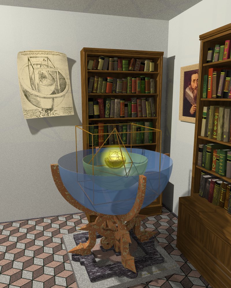

Going back to my old projects. This is an intermediary take. I started
working on the surroundings. The new floor is nice (I think!) but with the
libraries (Gilles Tran's MakeLibrary), the rooms needs a wooden floor I
think, and wainscots.
Hesitating about a window (invisible, left) or artificial lighting (my
preference).
Need lots of scrolls too.
As always, comments very appreciated!
To PM 2Ring: I posted the missing and corrected files in p.b.s-f. (hope all
is complete!)
Download 'Kepler_08.jpg' (180 KB)
Preview of image 'Kepler_08.jpg'
Maybe one of Kepler's own pentagonal tilings... would they look good as
parquetry?
> preference).
I don't like the placement of the near bookcase, especially how it obscures
the portrait. How about moving the back wall back another two metres or so,
to create a corridor going off to our right? Then you could have the two
bookcases side by side, with one of them disappearing onto the corridor. I
think this would also look good with lighting from the left.
I think the room still works without fancy scrollwork.
> is complete!)
Thanks, Thomas. I'll check them in the morning.

"PM 2Ring" <nomail@nomail> schreef in bericht
news:web.42e8e4b2d41a1e037856bfaa0@news.povray.org...
> parquetry?
I suppose so. I shall try to find an example on Google.
obscures
so,
Funny how perceptions can be different from person to person! My wife
preferred the portrait half hidden.
I have moved the far bookcase to the left now. However, I shall take your
suggestion and move the backwall back (maybe also the right wall). In any
case the camera view was too crowded as is. A corridor to the right... or
maybe to the back.... I shall experiment. I have also a portrait of Tycho
Brahe that I want to put somewhere...
Sure. Just a few rolled-up things on top of the bookcase (starts to look
like my study!  ;-) )
all
> > is complete!)
I hope everything is complete. If not, tell me!
Thanks for your comments. Much appreciated!
