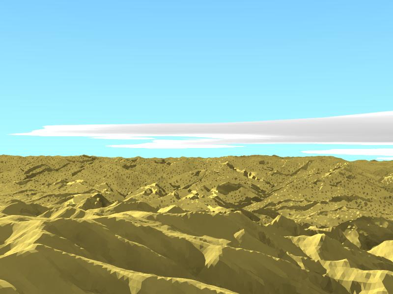

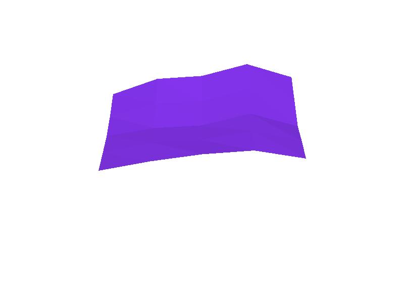

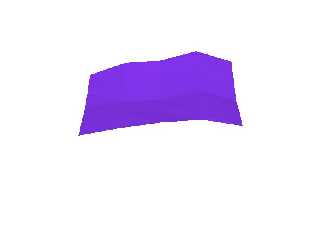

After some delay, I finally found out how mesh2s and smooth_triangles
work - starting with a hand-coded 5 by 5 mesh, whose smoothed version
looks convincing at least to me (both non-smoothed and smoothed version
attached here).
But then I also tried this on the curved mesh2 (following Earth
curvature) from the 1200 by 1200 SRTM data of some mountainous Afghan
wilderness west of Kabul... and got a VERY strange appearance of the
mesh (also attached).
Not only that most of the topography is lost to a strange regular normal
pattern, but also from about row 1100, normals are no longer averaged
any more (#warning output "division by zero", vector "norm" keeps its
initialization value of <0, 0, 0>), so that the foreground remains
unsmoothed!
What went wrong?
Am I, at all, right to assume that the average of vectors
<x1, y1, z1>, <x2, y2, z2>,...,<xn, yn, zn> simply is
<(x1+x2+...+xn)/n, (y1+y2+...+yn)/n, (z1+z2+...+zn)/n> - or am I barking
  up a totally wrong tree?
yes it's fine (i think), as long as the normals you add
are normalized! (otherwise long normals contribute more
to the average than shorter normals)
imagine stacking all normals on top of each other (in 3D),
you end up with a funy line that can end anywhere, so the
result will not be normalized by dividing it by the number
of normals you added together.
the end of the stack of normals may end op at <0,0,0>, witch
can't be normalized, because it does not have any direction.
(like when you average to normals with exactly opposite direction)
jaap.

you can skip the the divide by n, if you are going to normalize
the resulting vector anyway.
(but your problem may be caused by something else)
jaap. (again)

i took teh liberty to change your code a bit:
#declare a=0;
#while (a<zdem)
  #declare b=0;
  #while (b<xdem)
    #declare ep=vertices[a][b];
    #declare av=<0,0,0>;
    #declare c=0;
    #while (c<8)
      #declare svp=ep+(sp/2)*<int(sin(c*45)*(pi/180)), 10,
int(cos(c*45)*(pi/180))>;
      #declare svt=trace(relief, svp, -y, norm);
      #if (norm.x!=0 | norm.y!=0 | norm.z!=0)
        #warning "OK!"
        #declare av=av+norm;
      #end
      #declare c=c+1;
    #end
    #if (vlength(av)!=0)
      #declare normals[a][b]=vnormalize(av);
    #else
      #declare normals[a][b]=<0,0,0>;
    #end
    #declare b=b+1;
  #end
  #declare a=a+1;
#end
- you don't need seperate x,y and zet av, (just use av.x when needed)
- the divide by number of normals is replaced by vnormalize()
- added check for <0,0,0> sum of normals.
- you seem to check wether the trace() function missed the object,
but normals like <0,0,1> and <0,1,0> are valid, so use something like:
or:
      #if (vlength(norm)!=0)
or:
      #if ((abs(norm.x)+abs(norm.y)+abs(norm.z))!=0)
jaap.
It looks like the normals are all wrong, you shouldn't be able to see the
individual triangles like that if you've calculated them correctly.
Your code looks very complex (because of all the transformations built-in)
and I haven't got time to analyse it all.  But I posted some code to p.b.s-f
in reply to your message that does what you want I think.  It just takes a
2D array of vectors, and then joins them all up with a smoothed mesh2.  You
might be able to spot your problem by looking at the code.  I hope it helps.
