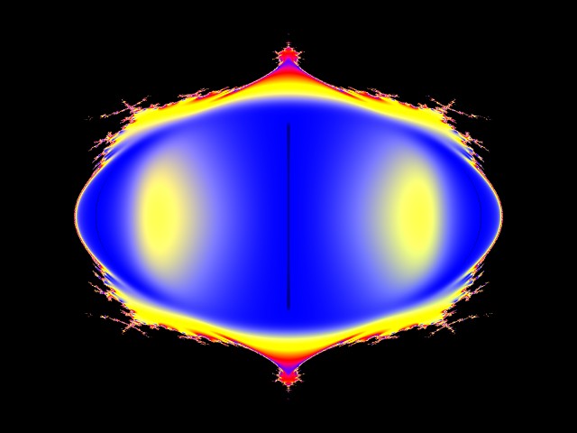

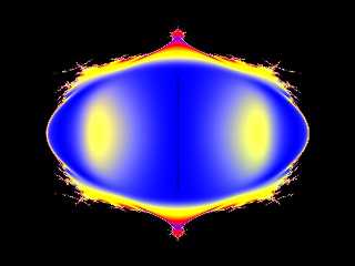

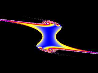

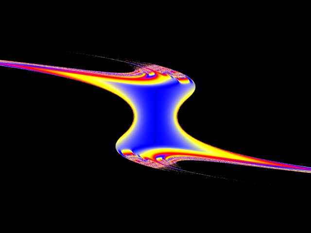

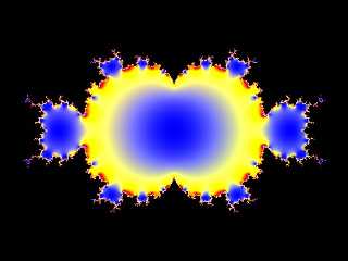

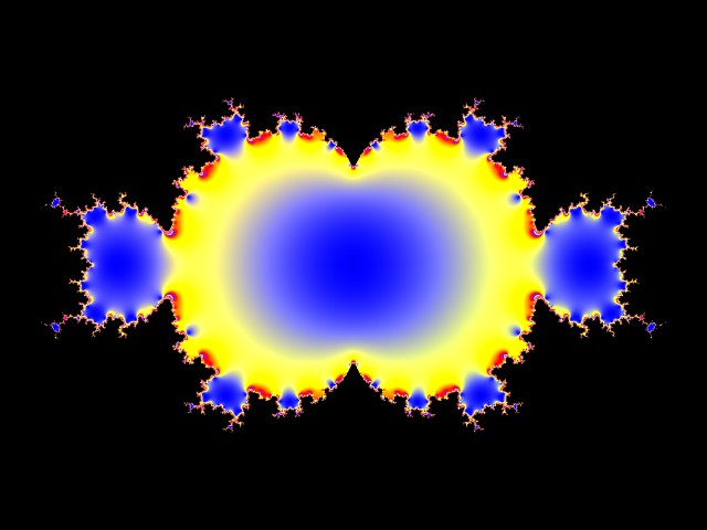

Here are cross sections through the three axes. I used 12 iterations here
(pigment functions are a lot faster than 3d isosurfaces).
Here's the source code for the Z axis slice:-

From: Stephen McAvoy
Subject: Re: The Cubic Mandelbrot [23 kb]
Date: 15 Jun 2005 10:05:02
Message: <bcd0b11b2umvvdco2jitjhagmreugvef7h@4ax.com>
On Wed, 15 Jun 2005 11:48:59 +0100, "Mike Williams"
It doesn't colour cycle :-)
Regards
        Stephen
From: Orchid XP v2
Date: 15 Jun 2005 15:50:15
Message: <42b08677$1@news.povray.org>
>>Also of interest: slice the isosurface and stick a matching 2D plot on
>>the cross-section! (I will do this later if I figure out pigment
>>functions...)
Neat!
The bottom image looks like one would expect. The other two look like I
maybe messed up my maths somewhere... they don't look right somehow.
The bottom image I'm guessing is A=(0, 0), B=(x, y). That looks correct.
If you try A=(x, y), B=(0, 0) it should look like this:
http://www.felicite-parmentier.freeserve.co.uk/large/cubic-mand.gif
However, it looks like the second image is trying to be that, but messed
up. Looks like I need to go recheck my math! (You'll notice that the
image that looks right doesn't use A at all - and there's an
optimisation involved with the A variable. Wanna bet I optimised it wrong?)
Anyways, usually when rendered 2D, the part of the isosurface that's
solid is coloured black, and the parts outside are multicoloured. ;-) Of
course, there's no *law* about that...
I'll go see if I can figure out if/where my code is wrong. :-S
From: Mike Williams
Date: 15 Jun 2005 16:26:11
Message: <6$VdAAAb7IsCFw2x@econym.demon.co.uk>
>>>functions...)
>Neat!
I suspect that it has something to do with the values of T1 and T2.
When A=(0,0), T1=0 and T2=0, and the whole thing behaves exactly like a
conventional 2D cubic Mandlebrot (z = z^3 + #pixel as they say in an
UltraFractal script).
Mike Williams

From: Emerald Orchid
Date: 15 Jun 2005 16:46:13
Message: <42b09395$1@news.povray.org>
Indeed - that's the optimisation.
The formula is z^3 - 3a^2z + b, as - as an optimisation - my code
calculates t = 3a^2. Then the formula is z^3 - tz + b.
Still... I'm staring at my code... and I'm not seeing anything wrong...
hmmmm... 0:-)
From: Mike Williams
Date: 15 Jun 2005 17:05:02
Message: <jv40VAAufJsCFwlO@econym.demon.co.uk>
>hmmmm... 0:-)
I just spotted that the formula for the image you want it to look like
appears in the title bar of the gif. Namely:
        Z = Z^3 - 3.c^2.Z + 0
However, the function you're using for the 3D mandelbrot is
        Z = Z^3 - 3.c^2.Z + #pixel
on the X plane cross section, the real part of the #pixel is 0
This code plots Z = Z^3 - 3.c^2.Z + 0 using something similar to your
original 3D function, but I can't see how to get something 3D that does
this on the X axis and plots Z = Z^3 + #pixel on the Z axis at the same
time.
