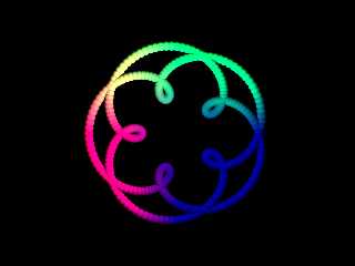

A first try at a spirogram a la Shay.
Total failure, but nonetheless something mildly interesting.
Anybody got code that does nice spirographs? Shay?
I tried implementing the algo at Mathworld, but obviously lacking in the
math department.
Lots of possibilities posed by this - most obvious is a "plekmatjie" in my
language - something that your granny would put the kettle on. Or over the
kettle.
Source in p.b.s.f.
Things to try - bring in some Z, colors, transparency, blobs, and other
objects - a world of possibilities.
Comments welcome or use in your own scenes. From a greater distance makes a
lice little round knitted tea-cosy or something.
Stefan Viljoen
Polar Design Solutions
Download 'spiro2.jpg' (110 KB)
Preview of image 'spiro2.jpg'

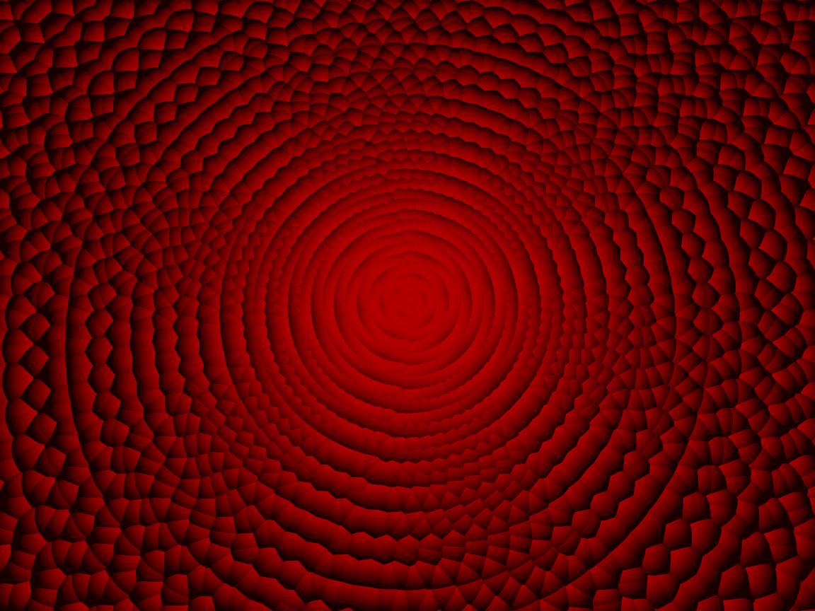

Perhaps the problem is your POV rather than your math?
Try keeping track of your last pos and drawing a cylinder between points
instead of all those smushed up spheres!
You may prefer to make an object of the cylinder collection.
i.e. modify your code to look a bit like this.
DLM
#declare radius_fixed = 1;
#declare radius_rotating = 4;
#declare spiro_offset = 1;
#declare my_degrees = 0.0;
#declare x_loc =0;
#declare y_loc =0;
#declare x_loc_o =0;
#declare y_loc_o =0;
#declare z_loc = 0;
//#declare z_fac = 0.0025;
#while (my_degrees < 360)
  #declare x_loc_o =x_loc;
  #declare x_loc = (radius_fixed + radius_rotating) * cos(my_degrees /
57.3) -
  (radius_rotating + spiro_offset) * cos((((radius_fixed + radius_rotating)
  radius_rotating)) * (my_degrees /*/ 57.3*/));
  #declare y_loc_o =y_loc ;
  #declare y_loc = (radius_fixed + radius_rotating) * sin(my_degrees /
57.3) -
  (radius_rotating + spiro_offset) * sin((((radius_fixed + radius_rotating)
  cylinder {
    <x_loc_o,y_loc_o,z_loc>,<x_loc,y_loc,z_loc>,0.025  //0.25
    material {
      texture {
        pigment {
          color Red

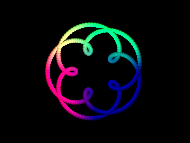

From: Shay
Subject: Re: Frist try at...(109KB)
Date: 21 May 2005 11:57:43
Message: <428f5a77@news.povray.org>
I don't have the education to be educated by mathworld, but it looks (as
best I can tell) like they did the opposite of what I did.
You've got a big cirle of radius RAD that spins around 1 time in one
unit of TIME. So the POSITION on the big circle is:
(multiply by 2*pi to get radians from TIME)
POSITION = <cos(TIME*pi*2) , sin(TIME*pi*2), 0> * RAD;
Then put a smaller wheel whever that wheel is at. Make the small wheel
spin around something like 3.5 SPINS per one unit of TIME:
SMALLPOS = <cos(TIME*pi*2*SPINS) , sin(TIME*pi*2*SPINS), 0> * SMALLRAD;
Add POSITION and SMALLPOSITION together (or subtract, like Mathworld
did), and you're at the point for whatever TIME is on the graph. Connect
several TIME positions together, and you've got a spirograph.
Of course, That formula on Mathworld is just the beginning. <see attached>
   -Shay
Download 'spirograph.jpg' (122 KB)
Preview of image 'spirograph.jpg'

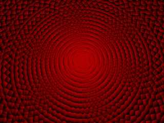

And here's a refinement of your original - see source in p.b.s-f
Currently a kind of tiedied kasteel doily motif.
Play with the parameters.
Best...
DLM
Download 'spiro.jpg' (33 KB)
Preview of image 'spiro.jpg'
