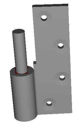

I would like to add the cam part to my hinge. A ramp that wraps around the
pin. I'm thinking that a cylinder isosurface whose height changes with the
angle should work. Looking up the parts on f_ph and f_th don't seem to help
me understand them any better. I can get a cylinder but the change in height
is giving me a head ache. Some help would be appreciated :-)
Stephen

Here's something that might get you started. I had to swap the axes to
y-upwards because my POV intuition doesn't work in z-upwards mode.
A big problem is that the gradient becomes infinite at the vertical
edge, which means that it takes a nearly infinite amount of time to
render with eval, and doesn't render correctly with any finite value of
max_gradient.
I tried rendering it with a low max_gradient and masking the dodgy edge
with a thin box. That helped, but there are still some bad bits that are
still visible unless I make the box so large that it becomes noticeable.

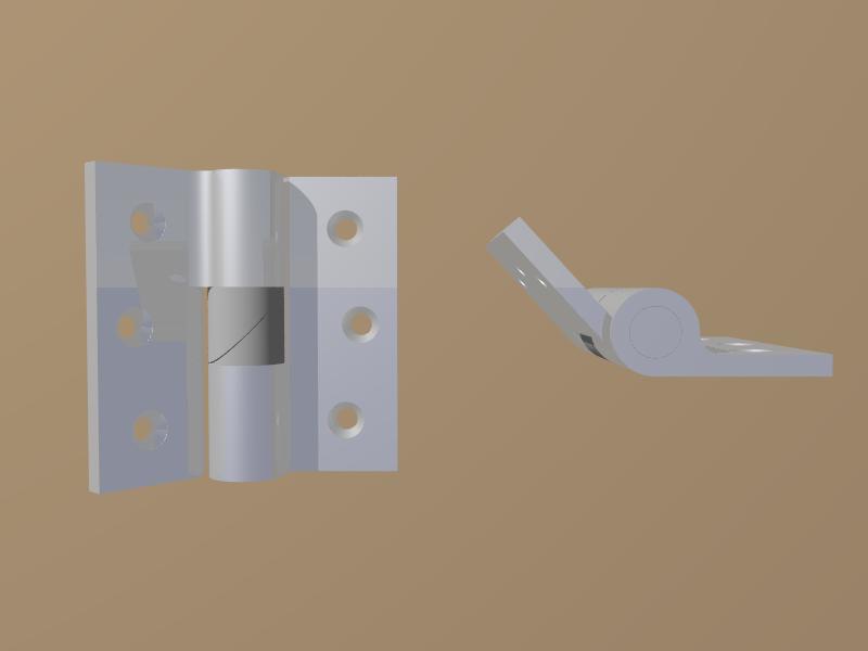

G'day Stephen,
I went to the toilet downstairs earlier and noticed it had the sort of
hinges you're trying to do. The slope you're searching for is just a
flat plane. No need for twist or anything, just a cylinder minus a plane.
I've attached a scene of the hinge I've written. Code is below.
Animation is in p.b.a (if I can work out how to make it small enough)
The ClosingHinge() macro takes three parameters:
	Scale
		-- Really should remove as it can be done elsewhere
	DoorAngle
		-- The angle at which the door is CURRENTLY
		   0   = hinge is flat
		   180 = hinge is folded completely
	PreferredAngle
		-- The angle at which the door would sit if let to swing
Cheers!

From: Mike Williams
Subject: Re: Isosurface cylindrical ramp?, cam lift hinge
Date: 7 Mar 2005 02:41:11
Message: <RnsXWCAiQALCFwrj@econym.demon.co.uk>
Wasn't it Rick Measham who wrote:
>G'day Stephen,
I don't think that works at all well. When the hinge is part open, the
whole weight of the door is supported on a single point of contact, and
that's going to damage the hinge. Here's a close-up of just the contact
surfaces showing the problem.

light_source {<-30, 100, -30> color rgb 1}
#include "colors.inc"
#declare ClosingHinge_Plastic = difference {
        cylinder {
                <0.00,  1.50, 0.00>
                <0.00, -0.50, 0.00>
                0.50
        plane {
                y
                0.01
                rotate z*45
        texture {
                pigment { Grey }
#declare Open30 = union {
  object {ClosingHinge_Plastic}
    rotate z*180
    rotate y*30
    translate <0,-0.23,0>
object {Open30 translate -x}
object {Open30 rotate y*180 translate x}
Mike Williams
Gentleman of Leisure
From: Rick Measham
Date: 7 Mar 2005 02:46:56
Message: <422C06F5.30201@nomail>
Just ran downstairs to check .. only thing I got wrong is the angle.
Probably closer to 30 than the 45 I put in there. The hinge does indeed
rest on on that small point.
The plastic part of the hinge is a fairly strong plastic that's not
going to break too soon as this building is 10+ years old .. and I've
never seen one of these hinges broken anywhere.
Cheers!
From: StephenS
Date: 7 Mar 2005 06:28:42
Message: <422c3aea@news.povray.org>
> Mike Williams
That indeed helped. Will look into the second example as time permits.
Stephen
Download 'cylindrical_ramp.jpg' (4 KB)
Preview of image 'cylindrical_ramp.jpg'
