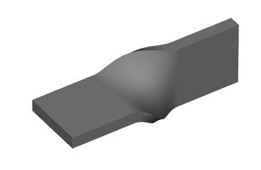

I would like to represent a length of metal 1 inch wide by 3/16 inch thick
that has a 90 degree twist over a 1 inch length.
Following the examples in the documentation (6.5.4.3.7 for twist) I have the
basic shape, but would prefer a less dramatic change from straight to twist.
Can the twist function be changed to start with no rotation, quickly
increase to the desired turns/unit and then back to no rotation?
Stephen

From: Slime
Subject: Re: Isosurface with straight,twist,straight
Date: 5 Mar 2005 23:53:21
Message: <422a8cc1$1@news.povray.org>
Try making this smoothing function (which starts at zero with a slope of
zero, then slopes up, and ends at one with a slope of zero):
#local smoothfunc = function(x) {x*x*(3-2*x)}
And then replace the x in your sin/cos functions with smoothfunc(x).
 - Slime
 [ http://www.slimeland.com/ ]

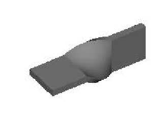

From: StephenS
Date: 6 Mar 2005 07:29:32
Message: <422af7ac@news.povray.org>
>  - Slime
This worked nicely, thank you. A small tweak in the accuracy and
max_gradient and I have this.
Stephen
Download 'smooth_twist.jpg' (5 KB)
Preview of image 'smooth_twist.jpg'
From: Slime
Date: 6 Mar 2005 14:01:36
Message: <422b5390$1@news.povray.org>
Nice. You might even want to use this version:
#local smoothfunc = function(x) {x*x*x*(10+x*(6*x-15))}
Which also matches second derivatives, and will make the transition from
straight to curved even more invisible.
 - Slime

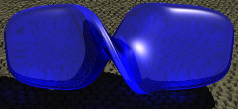

From: Sebastian H
Date: 7 Mar 2005 12:30:55
Message: <422c8fcf$1@news.povray.org>
Nice, how did you calculate it?
Once I made some differential equations
for this problem and solved them.
It was a bit dirty and some paper sheets got lost.
If I remember right the differential equations
for a smooth transition from 0 to 1 were:
f(0) = 0
f(1) = 1
df(0)/dx = 0   # match in first derivative
df(1)/dx = 0
d^2f(0)/dx = 0 # match in second derivative
d^2f(1)/dx = 0
An approximation method aka Taylor or
something which could be used to get a match
in even higher derivatives would be nicer
but when I got f(x) for the second derivative
I forgot thinking about it further.
Sebastian
From: Sebastian H
Date: 7 Mar 2005 12:37:52
Message: <422c9170@news.povray.org>
Sebastian H. schrieb:
> f(0) = 0
> f(1) = 1
> df(1)/dx = 0
> d^2f(1)/dx = 0
And here is my image from then.
Sebastian
Download 'twist.jpg' (19 KB)
Preview of image 'twist.jpg'
From: Slime
Date: 7 Mar 2005 12:57:46
Message: <422c961a$1@news.povray.org>
Actually, I just took it from my old Slime-POV source code which implemented
second-derivative continuity in f_noise3d; so ultimately it came from Ken
Perlin's paper which explained how to do that. Of course, it can be figured
out manually with the conditions you describe. Since there are 6
restrictions on the function, we must have 6 unknowns, which mean it's a 5th
order equation:
f(x) = ax^5 + bx^4 + cx^3 + dx^2 + ex + f
Differentiating twice, plugging in x = 0 or 1 and setting the results equal
to zero or one as you stated should produce a 6x6 matrix which can be solved
for a,b,c,d,e,f. The result will be a=6, b=-15, c=10, d=e=f=0. Then the
result is equivalent to x*x*x*(10+x*(6*x-15)).
Nice image, the smoothness really helps.
 - Slime
From: Sebastian H
Date: 9 Mar 2005 12:43:35
Message: <422f35c7$1@news.povray.org>
> order equation:
This is exactly how I did it but I kept some variables
in the matrix, therefore it got a bit messy (had nothing to do then).
Thank you.
I allways enjoy your images, too.
Sebastian
