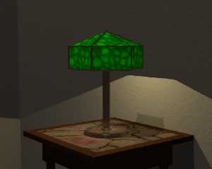

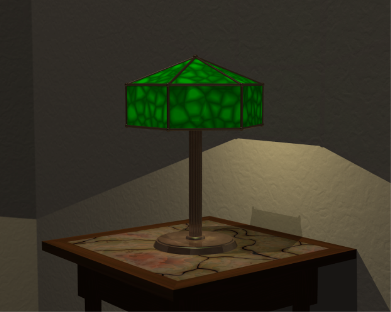

Hola,
After some input I've reworked the lamp glass .... I like it much better.
I used Runes' patina macro for the brass lamp.
The table is different and the kinetic toy is gone.
Is it me or does focal blur do a better job than AA command line options?
Ciao Jim
Download 'Lamp.png' (481 KB)
Preview of image 'Lamp.png'

What AA options do you use? +AM2 +A0.3 seems to work well, +A0.1 if I want
higher quality. I usually use +AM1 +A0.3 for quick renders of small width
and height.
the table looks pretty good. the edges of the wood could use a little bevel
or roundness to them to catch a light highlight. the lamp needs a power cord
:) the last nitpick is that the metal connecting the peices of glass seem a
little too thick.
nice work, the lamp looks realistic.

 I used +AM2 +A0.1 -J0.0 for the AA options ....
  aperture 0.35
  blur_samples 200
  variance 1/1000
  confidence 0.99
 for the focal blur (pointed at midpoint of the lamp) ...
> bevel
> cord
> a
> little too thick.
 good feedback ..... haha I'd already done a difference with the edges of
the table and a cylinder that was
a 3rd the thickness of the tabletop (much better!), and the powercord ....
was checking out another thread related to
stringing cables maybe that'll help. I hadn't really noticed the thickness
with the connector issue .... thanks
