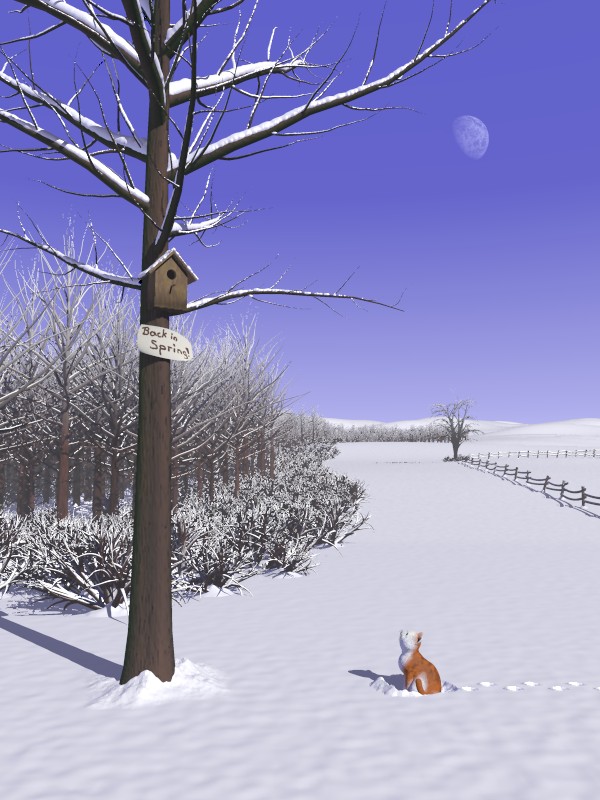

Hi all!
The latest version of the image. I'm unsure if I really want to go ahead and
add some clouds, mainly because the landscape already has much white and
extra clouds would subtract the nice blue-white-contrast.
I'm thinking about pulling the distant lone tree with the fence a little
closer, there's still quite a gap between the forest and the fence. I'll
also need to add some more fine-detail to the main heightfield to avoid the
plain white areas, that just look's awful.
Tried putting some mountains at the horizon, but that just looked
ridiculously overloaded.
Suggestions and comments welcome, as always! :-)
Tim
"Tim Nikias v2.0"
Download 'missyou_wip.jpg' (119 KB)
Preview of image 'missyou_wip.jpg'

Looks great. A few points:
- It seems strange that there's so many bushes just outside of the forest
and just inside the forest there's nothing on the ground.
- The poles making up the fence look pretty bendy.
- I would agree that you should change the fence's position; why would
someone's property end 30 feet before the forest begins? It just seems
strangely placed.
- The snow looks pretty shallow, so I suggest putting occasional patches of
grass blades sticking above the snow, and maybe rocks or leaves.
 - Slime
 [ http://www.slimeland.com/ ]

Thank you.
On the to-do list. :-)
Yup, old and worn out. Maybe a little too much, I'll experiment some more.
> strangely placed.
Maybe because he wasn't allowed to buy more? ;-) I won't go ahead and fit
the fence along the curve of the forest though...
of
Might be a possibility... I'll look into that.
Thanks for the suggestions!
Tim
"Tim Nikias v2.0"

Coming along very nicely.
I think the distant lone tree is OK where it is.
What about a roadway between the fence & forest to fill in the gap, or maybe
a small lake or pond.
Alex

If you want some clouds, I think they should be wispy, almost transparent.
Contrary to Slime, I see no problem with the proximity of the fence and
the forest, I've seen similar placement a few times. Maybe the owner of
the fenced terrain used the trees from the gap to build the fence, or to
heat his home...
Some natural forests have virtualy no undergrowth or bushes under the
trees, while having bushes near the edges. Just have the bushes closer
to the trees would be OK.

I don't think it's that they are too bent, maybe just a little, but that
they are too regular. Each section of the fence is too similar to the
once before it, creating the look of a regular pattern off into the
distance. You might want to have some missing cross pieces in some
sections and have others lying on the ground. But maybe that's just my
own taste?
>>strangely placed.
Yeah I don't think it would look good with the fence right up against
for forest, even if it is realistic.

I like it.
Bushes and trees.
Its about competition for light. So you see a gradient from short to tall -
very rarely a step. And not so regular.
Best.
DLM
Thank you!
maybe
I was thinking about a road, or at least some tracks showing that a road
should be there.
Tim
"Tim Nikias v2.0"
to
> I like it.
> Bushes and trees.
tall -
Thanks for the suggestions. Maybe I'll introduce some more randomness in the
positioning and placing of the bushes, as well as moving some of them more
into the forest. A little more variation in scale might be useful as well.
Tim
"Tim Nikias v2.0"
> Regards,
> Tim
i think i'd leave the right end of the fences alone and try moving the
tree/corner join left almost to forest edge, there's a conventient
dimple in there, almost horizontally left and jiggle with the fence
spacing as already suggested
suggestion of track outline in the snow, maybe with occasional grass
spikes. rutted track throws up a sort of higher edge and a bit in
middle, grass would poke though. hard to explain what i mean
have you tried scaling the cat up by 1.25/1.5 out of curiosity?
and move along a line right up 20-30 deg to compensate
stephen
Yup, more irregularities in the fence are planned. The algorithm was simple
divide-and-place, but modifications should be simple.
I've already begun searching for some reference photos. As of yet I'm unsure
if I can get it right, but I'll try. If it doesn't work, I'll drop it. First
I'll check on the fences and the corner-position, might make a track
impossible to place.
Moving it away from the straight line is a good suggestion, scaling it
larger might be in order when they're moved. Otherwise, the cat-treehouse
relationship gets a little strange...
Thanks,
Tim

Tim Nikias wrote:
> Hi all!
> Regards,
> Tim
Superb algorithmic work...really looks like a "real" forest and bushes. :)
But the image is starting to feel a little busy. The focus of the cat &
tree has been lost a bit, I think. The fence & lone tree is a great
touch, but if it was me I'd leave out the bushes altogether and spread
the forest trees out more or thin them a little (only in areas where the
trees have been hand-planted do they grow that thick!). The vehicle
tracks in the snow is a pretty good idea...that would add a civilized
feel to the scene, instead of the cat sitting out in the boonies
somewhere. :)
I think I would also lighten up the birdhouse a little...it looks dirty.
I know you're going for a "weathered" effect, but I think it's been
weathered just a little too much. :) The bendiness of the fence rails is
a great touch...I think I would reduce the bendiness just a little,
though. They all seem to be tilted down a little, too. I love the way
the snow lies on the far rails. :)
The moon is a great addition. I think you should leave the sky just the
way it is...I think it really sets off the white snow really well (and
skies that blue do happen occasionally in winter!)
Great work, as always!!
~Mike
