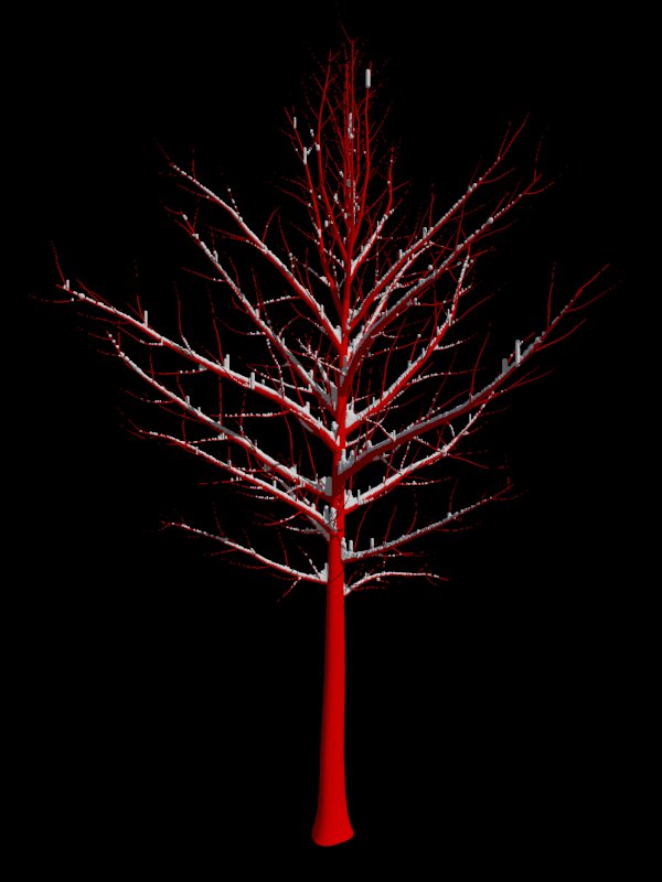

So, in the following, three images. The image ending on 1 is the Dropsnow
Macro released upon a mesh2-tree from Arbaro *without* the smallest
branches. The result is then placed onto the tree with all branches. It
looks nice, clean and crisp.

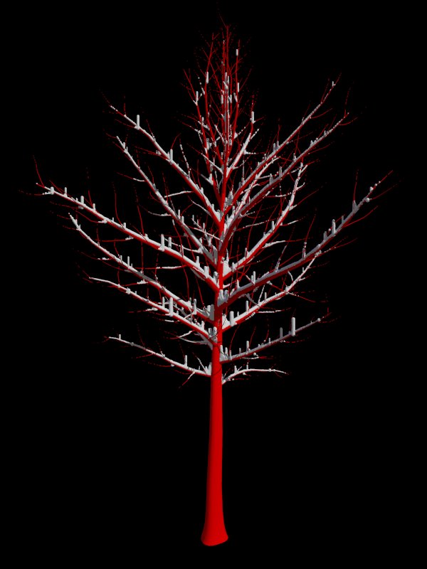

The image ending on 2 was Dropsnow released upon the *entire* tree, with all
the small parts. The small "noise" introduced by various very small
components (the smallest branches) would require much higher sampling
settings and, along with higher sampling settings already used to place
enough particles on the tree, the resulting parsing time would increase
exponentially. Of course, for a High-Res Final image, this might be what you
need, and I'm already thinking about how to refine the parsing process and
the resulting data so that small tweaks wouldn't result in an entire
reparsing of the particles, rather than just picking a few different
parameters for the display.
I've got no timings on these, but the simpler one required roughly 5 minutes
or so total, whereas the more complicated one would have required somewhere
around 12 minutes or so, both with roughly 8000 final particles out of a
20.000 initial bunch of which some were discarded due to steepness of
surface, surface too thin, inside mesh, etc.
Overall, I'm very pleased and will have to conduct some more tests on
various objects to see if I need to include a few more parameters for more
control on the User-Side.

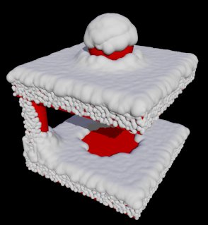

And the third and final image is just the macro on a CSG object to show off
the main effects I wanted to achieve: stacking along walls and removing
particles underneath roofs, two of the important issues about snow.

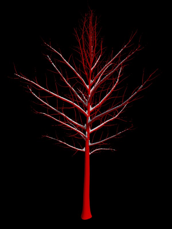

So, here's a version which required half an hour parsing, 46.000 cylinders
and 1000 spheres in a blob. Note that of the half hour, some times was
needed to first generate the particles and remove some due to steepness of
surface etc. The results of those presteps can (and were) saved to disk and
can be easily accessed for tweaking just the final step.
The result wasn't as good as I expected, there are still stalagmites
found... I'll reprocess the particles and tweak the parameters to see if I
can get a better version of this. But generally, such things are to be
expected with miniscule detail and discrete sampling. I imagine combining
image 1 (where the smallest branches have been left out) with a sampling of
positions without the stacking-algorithm might give much better results.

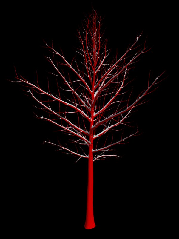

So, the final version, of which I won't do another excessive test. Here we
have 1700 spheres and 49600 cylinders in a blob, and there are still a few
places where a cylinder pops up when it should be a sphere. This one already
required 50 minutes. The point is that even though I could do long and
excruciating parses with ridiculously high settings, the same effect can be
achieved by combining a simpler, pure sphere-version with a cylinder-version
on a less detailed structure.

I would also add in a filter that would take snow off of objects that
are really small (third level branches, for example). Snow just doesn't
often stick to objects that small anyway, unless there's a huge amount
of snow, in which case it covers everything.
But even without that you have some great work here, and some incredible
results. I'm first in line to download the macros when you release them
(I have a project all scoped out - actually one I've wanted to try for
some time). :)
Keep it up!
> OTOH, if you have an admirable piece of hardware as a CPU, the parsing times
> could drop to a level where it might be feasible doing them. But these "ifs"
> pop up everywhere: *if* the PC where much faster, I'd do some Navier Stokes
> Equations in Realtime... ;-)
> Regards,
> Tim

The tree looks great, but there is a problem with the accumulation near
vertical surfaces on the simple CSG object. There is no reason for
accumulation on the bottom of the cylinder, because no snow could have
fallen into that area.
  -Shay

Shay wrote:
...assuming that snow falls perfectly vertically and doesn't blow around
once it gets to the ground. Which it doesn't and does, respectively.
~Mike
> ~Mike
The entire algorithm is built around the assumption that snow doesn't
blow around *that* much. Otherwise, the entire horizontal surface of the
lower platform would be covered. It's an excellent fake still. Just
pointing out one little area that might be improved.
  -Shay
From: Tim Nikias
Subject: Re: Dropsnow Macro Examples (48kb, 52kb & 14kb)
Date: 16 Dec 2004 18:14:19
Message: <41c216cb$1@news.povray.org>
The algorithm is very straightforward and simple: place samples and remove
undesired ones (e.g. a macro removes the samples underneath the "roof" of
the CSG object, but not on the edges, as some snow could have fallen there)
and as a last step: check for every particle if there's a wall and how close
it is to the particle.
I intend to make a modifying macro, which will modify the heights of such
particles. With the proper setup, such spots can be corrected manually, as
well as introducing some more "natural" randomness into the distribution.
Overall, the system is designed to just provide the basic building blocks,
and then some work is required to model it to perfection. It's less a "real"
simulation than more a hybrid system of various sampling methods to select
and modify particles.
But thanks for the feedback. :-)
"Tim Nikias v2.0"

I've written a macro which will read the particles' data and let the User
define two macros to modify the snow: one will just modify the height (by
multiplying with the return-value of the Macro), the other will add/subtract
from the height. Once the multiplier and/or the height gets negative, the
particle will be removed.
This is the result when pairing the existing snow with the turbulence-field
to adjust the height of particles. Just a rough proof-of-concept.
As a final note: I've now figured the official name for the macros: I'll
name them the "Surcoat-Macros". The Surcoat-System is just used to sample a
surface and collect/remove samples with various macros to take care of steep

Download 'csg_snow.jpg' (15 KB)
Preview of image 'csg_snow.jpg'
From: Mike Thorn
Subject: Re: Snow-Modification (14kb)
Date: 17 Dec 2004 12:15:36
Message: <41c31438$1@news.povray.org>
I'm floored. This macro of yours is turning out to be so much more than
I thought it would end up as. I was just wondering the other day how
your macro would handle scattered lumps of snow on a pine tree, for
example (as I stared out the window at just that). This shows me that it
very well can do just that. Bravo!! :)
