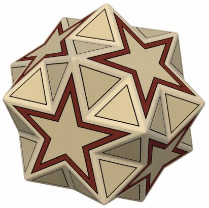

Had to try this again. Probably not interesting unless you've
experimented with this type of thing yourself, but my new edge-rounding
algorithm is very sophisticated. Going for a machined-edge, CSG kind of
look. I don't *think* a better edge could be made in a modeler, because
the algorithms are too slow for a modeler.
  -Shay
Download 'round_star.jpg' (28 KB)
Preview of image 'round_star.jpg'
From: Slime
Subject: Re: ****
Date: 6 Dec 2004 17:04:33
Message: <41b4d771$1@news.povray.org>
Maybe I missed this before, but what is this algorithm? Is it an SDL thing
or some sort of patch?
 - Slime
 [ http://www.slimeland.com/ ]
From: Shay
Subject: Re: ****
Date: 6 Dec 2004 17:38:37
Message: <41b4df6d$1@news.povray.org>
Just as SDL thing. I posted a similar shape a while ago. The edges
looked *decent*, but only because I made the curves very small. The
whole thing got me thinking about the odd parts of rounding a shape like
this. There are no obvious solutions. Compromises have to be made, and I
did some experiments to find what arrangement of compromises made the
most attractive shape.
The corner bends are all perfectly cylindrical, like a CSG rounded cube,
but the corners won't meet in a sphere like a cube's corners. The bends
are all different radii, but the width of the bends is perfectly equal
between edges. This is the best solution IMO (equal radii curves of
different widths being another possibility), but it is possibly flawed.
I've failed to think of a better way to join a concave curved edge with
two convex curved edges of a smaller radius. What I've got here might be
as good as that situation can possibly look, and, looking at some of the
machined parts around here, looks like the same compromise made by some
manufacturers and welders.
There *are* differences, however subtle, between this and what would
come out of a modeler.
  -Shay

Surely it depends on the modeller?  In something like ProEngineer you have
lots of complex options to specify exactly what it does in the situations
you mention, far more than I understand or have needed to use so far :-)
From: Shay
Subject: Re: ****
Date: 6 Dec 2004 18:19:18
Message: <41b4e8f6$1@news.povray.org>
scott wrote:
>> "Shay" wrote in message
>> would come out of a modeler.
I did say "would" not "could". :)
Surely you could follow this exact same procedure in anything
sufficiently instructable. I'm only saying that you would have to know
exactly what you want and follow a specific procedure in contrast to
simply clicking "round edges".
  -Shay

True. However the "bevel edges" option available in many mesh and nurbs
modelers will instantly round sharp corners on a surprisingly large
number of complex objects. However it sounds like your macro is easier
still in many circumstances, plus its pure SDL!:) Nice work.
From: Greg M  Johnson
Subject: Re: ****
Date: 6 Dec 2004 22:17:47
Message: <41b520db$1@news.povray.org>
You do good work.  The interesting thing for POVCOMP is I'm wondering what
would be the value-add of a very high mag zoom in on one small area of the
image.
From: Shay
Subject: Re: ****
Date: 7 Dec 2004 09:40:23
Message: <41b5c0d7$1@news.povray.org>
I'm not suggesting that rounding mesh corners is by any means a novel
idea. Consider this in the same vein as radiosity or media tweaking.
Nothing new, just getting everything just right for a specific instance.
I think that it's easy for something to be beautiful when it's made very
well. I never intended to do anything with this except mess with the
edges, but I think the result is very attractive.
/The knobby shape and a sort of a low-key, Nintendo, cartoon violence
vibe with the stars and brightish colors keep bringing the term 'monkey
fist' to mind./
The "perfect" corners IMO make this more interesting than it would
otherwise be. I think it might even look good in a little 5" frame,
though not my taste for wall decoration.
> Nice work.
Thank you.
  -Shay

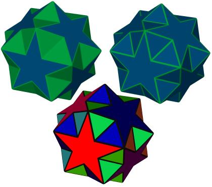

I'll send you the model. What were you thinking of for texturing? The
model is a mesh with texture indices, so I need to set it up to be
appropriate for your plans.
I attached a couple of examples of what I mean. Two shapes with a
2-texture scheme and one with a 33-texture scheme. Alternately, I could
set it up with a uv_mapping scheme. Let me know and give
me an evening to clean it up.
   -Shay

No texture or primitive stuff. It's a mesh.
  -Shay
The 1st texture is nice...
ok :-))
Thanks too
From: Shay
Subject: Re: ****
Date: 8 Dec 2004 15:54:08
Message: <41b769f0@news.povray.org>
>> could set it up with a uv_mapping scheme. Let me know and give
> ok :-))
> Thanks too
I'm going to take a couple more days on this. Since I'm presenting it as
a model and not just an image, I want to set up the texture indices and
uv_mapping to be a bit more versatile. I want to give a lot of freedom
in regard to how the model can be textured.
I won't have a chance to implement this until Thursday evening.
  -Shay
