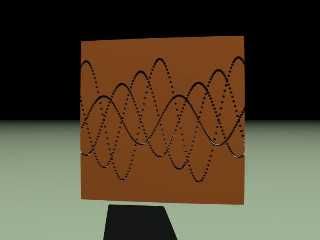

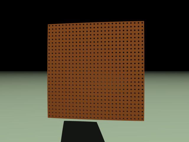

In the first and second pictures I created a blob with a big, flat
sphere and a bunch of negative cylinders, and then intersected the
result with a box.  Render times were under 2 minutes, and, as the
second picture shows, an advantage is that you don't need regularly
spaced holes (as you would with the subdivision method.)

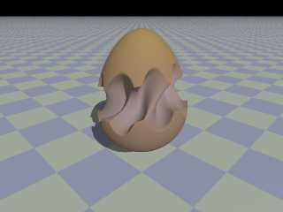

The third picture shows why I was needing a quicker difference.  I've
been modeling "milling processes," where a milling tool rotates and cuts
pieces out of a block.  If the block is a cylinder or a box, the
subdivision method works fine, with a little prep work, but when you're
carving out of some more irregularly shaped thing, this negative blob

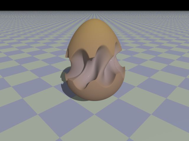

method is much easier.  In the fourth picture, I put the milling union
back in (slightly smaller) as a separate blob, to see how the carving
was done.
