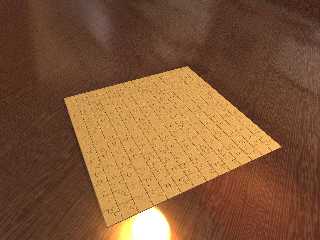

Hello,
Inspired by the question of incognito, I started making a puzzle macro.
It is nearly finished (some minor CSG stuff to be done), but good enough for
a demo scene.
The macro needs the following variables:
-number of collums (integer)
-number of rows (integer)
-radius of edges (float)
Variables that can be changed before the macro is called:
-fast (no rounded edges) (on/off)
-party(gives the pieces random collors) (on/off)
-texture of pieces
-suggestions???
The macro will be released "soon".
Of course comments, questions are very welcome as usual  :-).
Greetings,
JWV
Download 'puzzle.jpg' (203 KB)
Preview of image 'puzzle.jpg'

Neat!
Some observations/suggestions:
- Could the horizontal/vertical lines separating the pieces (ignoring the
"protrusions") be a bit more wavy? The pieces are too square for my liking
(I find real puzzles like that somewhat boring).
- Also, some edges could have no "protrusion", just a more wavy shape than
the bare straight edge. ASCII picture:
                             ____
     ____                   \    /
  __/    \__  instead of  __/    \___
- Most real puzzles I've found have a lower density of "special" pieces,
meaning pieces which are *not* the typical shape:
     ___    ___
    |   |__|   |
   _|          |_
  |_            _|
    |    __    |
    |___|  |___|
This density of "defects" could be adjusted with some parameters...
light_source{9+9*x,1}camera{orthographic look_at(1-y)/4angle 30location
9/4-z*4}light_source{-9*z,1}union{box{.9-z.1+x clipped_by{plane{2+y-4*x
0}}}box{z-y-.1.1+z}box{-.1.1+x}box{.1z-.1}pigment{rgb<.8.2,1>}}//Jellby
Looks great! I did some tests in this direction some months ago, but
never got as far as you did. Keep up the good work!
Florian (who already has an idea what to do with that macro once you
publish it)
I thought about this, but it would make it way to complex to implement at
this moment.
I think it would even need a completly different approach, and i would need
to master beziersplines first.
So, no, not for the moment. :-) (but it will deffinitly be in v2.0, if there
will be one)

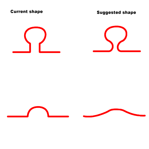

I realized you've already posted the code. I've looked more closely at the
images and maybe you could find some time to "improve the shapes of the
pieces. It would take some time and effort, but I believe it may be worth
it. I include an attachment, because ASCII art is not good enough for this
Note: if/when you use differences and intersections in your code, I guess it
would be wise to add "manual" bounding boxes to improve the rendering
times...

Date: 22 Aug 2004 09:48:15
Message: <4128a41f$1@news.povray.org>
Hi Jelby,
I understand what you mean now, but it is completely impossible to do that
sort of thing with this macro. In the way this macro works, there is no
knowledge of the actual final shape of the piece. So any test which checks
wether a piece is a "defect" is not being done at the moment. It would be
possible to check for any "defects", but not to do anything with it, since,
when you change a "defect" into a normal piece, it would need the
surrounding pieces to change as well (otherwise they won't fit). When the
surrounding pieces change, there will likely be at least one new "defect".
It would require a lot of code and time to make a "defects_density"
parameter work. I wonder how puzzle manufactures do this...
Well, one very crude method comes to my mind now: simply create random
puzzles (and "defect-test" them) until you find one that matches the desired
defects density. But it is a silly idea.
> I don't know what's the structure of your macro right now, but unlike my
> first suggestion (in the previous post), this one should be no real
problem
> (I guess). :)
So, you guesed wrong :-).
About the waving edges, it can be done but i need a special shape. I'm
thinking about making a deformed square using splines (one spline for each
edge), but i can't find a way to do this.
Greetings,
JWV

From: JWV
Subject: Re: puzzles (again) [202 KB]
Date: 22 Aug 2004 09:51:20
Message: <4128a4d8@news.povray.org>
thanks for the comment. The shapes will be improved, but not today since i'm
suffering from a (huge) hangover :-P.
JWV

From: Jellby
Date: 23 Aug 2004 09:44:21
Message: <4129f4b4@news.povray.org>
> since, when you change a "defect" into a normal piece, it would need the
Well, I had only a quick look to your macro, but it seemed to me that you
create some sort of array which defines, for example, whether each
horizontal lob would be a right- or left-lob. So, if the puzzle is 5 pieces
wide, there are 4 horizontal lobs (in each row) and you define a random
4-element array like:
   [1 1 -1 1]   (or maybe diffent numbers instead of 1 and -1)
This meaning that the first, second and fourth lobs are directed to the
right and the third is directed to the left. Then, looking at this array
you create each piece by adding an out-lob or an in-lob. Maybe I'm a long
way off, but it occurred to me that this would be a possible way, and the
code looked like it could be like that.
*If* that's the way you do that, then I think it's easy to do what I
propose. Instead of creating a random array, create an alternating one [1
-1 1 -1] (and [-1 1 -1 1] for the 2nd row, etc.) and then invert each
element with a certain probability (given by the "density of defects"
parameter). Afterwards, just create the pieces as before.
As I said, this holds if the macro works the way I believe it does.
Otherwise, forget what I said :)
From: JWV
Date: 23 Aug 2004 12:36:22
Message: <412a1d06@news.povray.org>
Hi Jelby,
You are (completely!) correct about the way the macro works, and the
suggestion you give to make the "density of defects" work could even work
very well. But i'm not going to do it that way since I am having another
plan which i want to test. This time the code is actualy going to do some
puzzling :-) (i hope).
Greetings,
JWV

From: Jellby
Date: 24 Aug 2004 08:35:13
Message: <412b3600@news.povray.org>
It's always good to have thing progress ;-)
By the way, does your macro (current or future) allow for "undone" puzzles?
I'm thinking of having a real puzzle, with some nice picture and the pieces
spread and shuffled all around the place...
