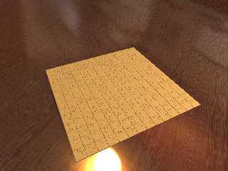

Hello,
Inspired by the question of incognito, I started making a puzzle macro.
It is nearly finished (some minor CSG stuff to be done), but good enough for
a demo scene.
The macro needs the following variables:
-number of collums (integer)
-number of rows (integer)
-radius of edges (float)
Variables that can be changed before the macro is called:
-fast (no rounded edges) (on/off)
-party(gives the pieces random collors) (on/off)
-texture of pieces
-suggestions???
The macro will be released "soon".
Of course comments, questions are very welcome as usual  :-).
Greetings,
JWV
Download 'puzzle.jpg' (203 KB)
Preview of image 'puzzle.jpg'

Neat!
Some observations/suggestions:
- Could the horizontal/vertical lines separating the pieces (ignoring the
"protrusions") be a bit more wavy? The pieces are too square for my liking
(I find real puzzles like that somewhat boring).
- Also, some edges could have no "protrusion", just a more wavy shape than
the bare straight edge. ASCII picture:
                             ____
     ____                   \    /
  __/    \__  instead of  __/    \___
- Most real puzzles I've found have a lower density of "special" pieces,
meaning pieces which are *not* the typical shape:
     ___    ___
    |   |__|   |
   _|          |_
  |_            _|
    |    __    |
    |___|  |___|
This density of "defects" could be adjusted with some parameters...
Looks great! I did some tests in this direction some months ago, but
never got as far as you did. Keep up the good work!
Florian (who already has an idea what to do with that macro once you
publish it)
I thought about this, but it would make it way to complex to implement at
this moment.
I think it would even need a completly different approach, and i would need
to master beziersplines first.
So, no, not for the moment. :-) (but it will deffinitly be in v2.0, if there
will be one)
>                              ____
>      ____                   \    /
After staring at, thinking about, and realligning the ascii picture: Yes
that would be possible (will try to implement that).
>      ___    ___
>     |   |__|   |
>    _|          |_
>   |_            _|
>     |    __    |
>     |___|  |___|
Could you explain this in a different way, i don't understand what you mean.
Thanks for you suggesttions,
Greetings,
JWV

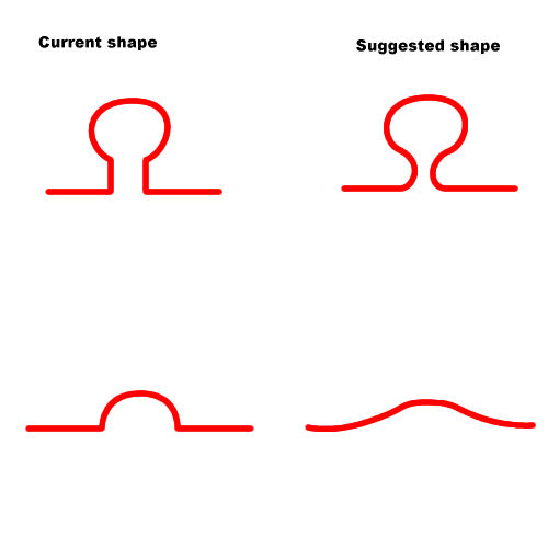

I realized you've already posted the code. I've looked more closely at the
images and maybe you could find some time to "improve the shapes of the
pieces. It would take some time and effort, but I believe it may be worth
it. I include an attachment, because ASCII art is not good enough for this
Note: if/when you use differences and intersections in your code, I guess it
would be wise to add "manual" bounding boxes to improve the rendering
times...
light_source{9+9*x,1}camera{orthographic look_at(1-y)/4angle 30location
9/4-z*4}light_source{-9*z,1}union{box{.9-z.1+x clipped_by{plane{2+y-4*x
0}}}box{z-y-.1.1+z}box{-.1.1+x}box{.1z-.1}pigment{rgb<.8.2,1>}}//Jellby
Download 'shapes.png' (13 KB)

Hi Jelby,
I understand what you mean now, but it is completely impossible to do that
sort of thing with this macro. In the way this macro works, there is no
knowledge of the actual final shape of the piece. So any test which checks
wether a piece is a "defect" is not being done at the moment. It would be
possible to check for any "defects", but not to do anything with it, since,
when you change a "defect" into a normal piece, it would need the
surrounding pieces to change as well (otherwise they won't fit). When the
surrounding pieces change, there will likely be at least one new "defect".
It would require a lot of code and time to make a "defects_density"
parameter work. I wonder how puzzle manufactures do this...
Well, one very crude method comes to my mind now: simply create random
puzzles (and "defect-test" them) until you find one that matches the desired
defects density. But it is a silly idea.
> I don't know what's the structure of your macro right now, but unlike my
> first suggestion (in the previous post), this one should be no real
problem
> (I guess). :)
So, you guesed wrong :-).
About the waving edges, it can be done but i need a special shape. I'm
thinking about making a deformed square using splines (one spline for each
edge), but i can't find a way to do this.
Greetings,
JWV
> > mean.
> I'll try, though it's not so important :)
> Many real puzzles are somewhat boring, with all pieces the same general
> shape (some of them even have all pieces exactly the same shape). This
> general shape consist on two bulges on two opposite sides and two holes on
> the other two opposite sites. There are, however, some pieces with
> "special" shapes, which deviate from the typical shape mentioned above
(and
> shown in the ASCII picture). These "special" pieces or "defects" (since
> they make the overall shape non-periodic) can have:
>  - three or even four bulges or holes.
>  - two bulges in non-opposite sides (I don't remember having seen this).
>  - a side (I have not seen more) without bulge or hole, just the "wavy"
> shape I described in my previous message.
> Your puzzle shows the first two kinds of defect, but in a very high
number,
> there are too many "special" pieces for a typical puzzle, I'd say. I
> suggested you could make this "density of defects" an adjustable
parameter.
> When this parameter is 0, the puzzle would be perfect, completely regular,
> all pieces (except for the straight edges) exactly the same shape, as the
> the parameter increases, the number of "special" pieces increases as
> well... maybe something like this:
>  0:   perfect puzzle: bulge to the left, bulge to the right, bulge to the
> left, bulge to right... and bulge down, bulge up, bulge down, bulge up...
>  0.1: each bulge has a 10% probability of being inverted (changed from
left
> to right or from up to down).
>  0.5: the puzzle is completely chaotic, there's no regularity (maybe this
is
> how you do it now?)
>  1:   all bulges are inverted, so the puzzle is again regular, but
> different.
problem
> (I guess). :)

"Jellby" <jel### [at] M-yahoocom> wrote in message
news:41285ff4@news.povray.org...
> >> than the bare straight edge. ASCII picture:
> >>                              ____
> >>      ____                   \    /
it
> times...
