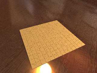

Hello,
Inspired by the question of incognito, I started making a puzzle macro.
It is nearly finished (some minor CSG stuff to be done), but good enough for
a demo scene.
The macro needs the following variables:
-number of collums (integer)
-number of rows (integer)
-radius of edges (float)
Variables that can be changed before the macro is called:
-fast (no rounded edges) (on/off)
-party(gives the pieces random collors) (on/off)
-texture of pieces
-suggestions???
The macro will be released "soon".
Of course comments, questions are very welcome as usual  :-).

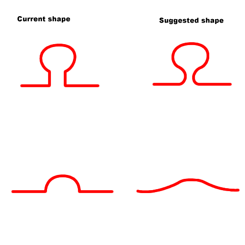

I realized you've already posted the code. I've looked more closely at the
images and maybe you could find some time to "improve the shapes of the
pieces. It would take some time and effort, but I believe it may be worth
it. I include an attachment, because ASCII art is not good enough for this
Note: if/when you use differences and intersections in your code, I guess it
would be wise to add "manual" bounding boxes to improve the rendering
times...

About the waving edges, it can be done but i need a special shape. I'm
thinking about making a deformed square using splines (one spline for each
edge), but i can't find a way to do this.

thanks for the comment. The shapes will be improved, but not today since i'm
suffering from a (huge) hangover :-P.
JWV
it
> times...
