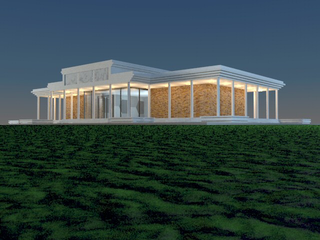

Look familiar at all? That Alabama Welcome Center, again.
It has changed because of how I remembered it versus seeing it in person
again, taking some notes on measurements and structure this time. Yet, still
lost track of exactly how the front entrance part is made. Has a flat front
roofline, at least partially, with three marble panels embedded there.
The lighting isn't going together very well anymore. It has more lights than
the first version so those porch-like walkways aren't as sporadically lit
now. Probably doesn't help that I added headlights from the freeway to shine
on the front. If I can use photons to hilight the walls better, I will, but
it might prove an ugly attempt. Already using fade_distance 2 fade_power 2
on those roof perimeter lights and everything is scaled as 1 unit =1 foot
(to keep it American).
Trees yet to be added.
Comments, good or bad, lots or none, are always welcome. ;-)
P.S. Thank you Zeger Knaepen, wherever you are! 'brick' wouldn't be bricks
without yours.
And thanks for looking all.
Bob H.

From: Josh
Subject: Re: Welcome Center WIP [~90K jpg]
Date: 30 Jul 2004 04:50:44
Message: <410a0be4$1@news.povray.org>
It's still a good model.  Try what I do when modeling reality.  If the thing
isn't in front of you snap 50 or pics with a digi cam.  One big shot of
every face, then lots from other angles.  With buildings it can be worth
going inside especially big open buildings, because elements of the
structure sometimes can only be seen from inside ( or from a helicopter ).

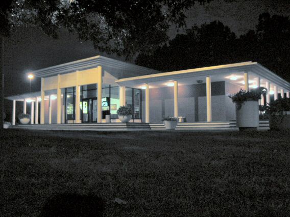

Thank you Josh. I agree. Would be better still if real orthographic cameras
existed.
I meant to take my camera with me when I went out there a couple days ago
and simply forgot to grab it as I went out the door. Got pictures tonight,
though, and image file attached is almost the same view I'm trying to
render. The moment I saw it again I realized I jotted down notes a bit
hastily and made mistakes. Nothing quite like a photograph for accuracy.
Well, almost... since this was nighttime and no tripod to do long exposures
with so my photos have been severely post-processed in order to see them
clearly.
Bob H.

From: Hugo Asm
Subject: Re: Welcome Center photo [~147K jpg]
Date: 31 Jul 2004 11:47:48
Message: <410bbf24@news.povray.org>
This helps very much to determine the accuracy of your model. You've
replicated the basic shape almost perfectly, but certain things need
adjusting. I'm sure you know what to do.
It's probably going to be difficult to achieve the same light, but worth a
try! There is a strong lightsource to the left and above (heavy street
light?) and the built-in lights create glows. I've noticed that such glows
are typical for night-shots. You practically always get them. The weather
doesn't have to be foggy for that.
I sort of prefer the white/grey look, rather than the strong blue/yellow on
your model. But I realise the colours on the photo may be off. You know it
better than me. Though I remember having read that humans don't see vivid
colours at night. Everything becomes more grey because of the way our eyes
compensate for the lower light, and below a certain threshold, the blue
color component becomes dominant.
I'm looking forward to your next post.
Hugo

What is extremely fascinating, is the way your mind 'remembered' the
building. For instance, the focus on the marble slabs, was interpreted very
differently from reality, leading, in the end, to a clearly different
building: the "mind's building" vs. the "real building". This leads to very
interesting concepts about the creation of "worlds" I would say (not even
speaking about the reliability of witnesses!!).
I am not sure which building I prefer... The "mind's building" could lead to
very interesting new vistas...

"Hugo Asm" <hua### [at] post3teledk> wrote in message
news:410bbf24@news.povray.org...
Yep, there's two orange sodium lamps. One in front and a little to the right
side of the building (its post is along the left edge of photo), the other
visible at the left side and behind the building. The bluish cast is from
three sets of four large mercury(?) floodlights, surrounding the rocket on
display, about 50 to 75 meters in front of the building. They are a little
above ground level so they (actually, mostly one set) shine beneath the
trees. In fact, all other lights for the parking lot are sodium lamps too.
Very contrasting in color, obviously.
on
B&W, or grayscales, could definitely be good for this. Nice idea. I had been
back there at twilight the first time and late at night the next time (with
camera). Was very blue-gray from a twilight sky but the lights all take over
at night and mix blues with yellows. A power outage could make it look gray.
Bob H.
