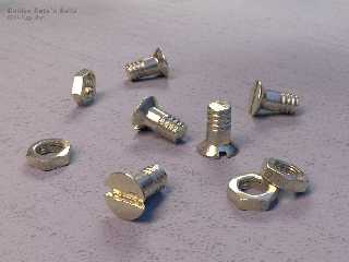

Hi,
The idea to make a "Nuts and Bolts" scene came from Tek. I used the same
settings as before (the Parfum Flacon post). Well, maybe the metal is
actually too shiny. I don't know. I also don't know if this is supposed to
be copper or gold. What do you think? I think the bolts look quite "melted"
too, but that might have to do with the modelling rather than the
material... Btw, they are modelled in Wings3d... Comments, suggestions?
Thanks.
Hugo

Hugo Asm wrote:
> Hi,
The bolts (screws?) do look a bit melted, but I don't know if modeling
or a normal is at fault for that.
The metal looks a little like brass plating or something (although it's
a little bright/pale for brass). I wouldn't say they're necessarily
*too* shiny. Reflections look good.
If you're going for photorealism here, you'll want a more realistic
surface for them to rest on.
-Xplo

Stunningly realistic to my eyes. Perfect for being tiny in size, screws are
about right for computer drive hardware... colors too. Not sure I'd describe
those as golden. Maybe chrome-like shown under incandescent room light.
Image contrast looks very good to me, with highlights being sharp and
shadows dark. It's a beautiful job of rendering.
Bob H.

also modelled with wings3d?
i'm really impressed my friend!

Photo Photo Photo :-p
Nice work.

Hugo Asm wrote:
> Hi,
> Thanks.
> Hugo
Wow, very realistic :)
I'd probably suggest somehow softening the reflection a bit on the
meatal, though. But, still, they are nice in their own right. It seems
like Jamie's (www.ignorancia.org) nust&bolts had a softer texture, IIRC
he used a micronormal to acheive the desired effect.  But, if shiny is
what you're going for, then these are perfect!

Just perfect! Some chromed steel bolts and nuts. The small nicks in the
front one groove adds tons of realism.
are
I agree.  Great job modeling and texturing, Hugo!
Could the chrome-like appearance be due to a blue sky_sphere?  That would be
my best guess.  If so, simply changing the sky_sphere and/or other
surroundings may make them look a little more golden.
Jeremy

VEEERY NICE :)
I would improve the texture of the ground to add much more realism to the
whole scene. But the nuts&bolts are amazing.
Congrats,
Fernando

Okay, I'm increasing my score. That's gotta be a 9.5 for that material. At
least. I've seen things that look like that! Are those imperfections in the
model or in the material? They really make it look convincing.
Though I'm surpised it looks that good on these objects, since it's obviously
not the kind of metal they'd usually be made from. Still, it's enough for me to
judge that is looks right.
I'm not sure what to suggest to improve it. It looks a bit shiny and smooth,
which usually makes things look less realistic, but then there are metals that
really look like that and if you less smooth then you'll make it look like a
different material. So I guess my only suggestion would be to do several
different materials based on this, so you could make a red/orange version for
copper, a brown one for brass, etc.
Tek

It's a photo ???? no, it can't be a render, it's too realistic !!!!
Awesome !

   That's one of the most "AWESOME ROLEXS" I've seen to the date... :o
   I don't think the shiny finish is excessive. Perhaps not very usual
for bolts, but I've seen metal finishes like this one. Indeed, your
Wings3D skills are really good. Nothing to critize except perhaps the
floor not being as realistic as the bolts, although it's very good anyhow.

Hi,
Thanks to all of you for your replies! The POV-Ray forum surely belongs to
the best places on the Internet because people here get the best treatment
along with great advices.
I will collect my reply in one post this time:
> a more realistic surface for them to rest on.
Indeed, the ground looks more like grey pancake. Next time I'll try
something else.
> sky_sphere?  That would be my best guess.  If so, simply
> changing the sky_sphere and/or other surroundings may
I can understand why you think it's a sky_sphere, but it's actually a
blueish area of light (both in terms of light_sources and in terms of an
object) to the right.
Blue gives the image a natural coldness in contrast to the area on the left
side, that is slightly red and warm. To obtain a more golden look, I could
change the blue light but I'd also loose the "natural coldness" element and
I don't think that should be necessary. I think (without having a sample of
gold nearby) that real gold has a higher diffuse value and is less
reflective, so it keeps more of it's own yellow color... Anyone please
correct me if I'm wrong.
Tek wrote:
> Are those imperfections in the model or in
Yes, imperfections are important. There are some imperfections in the model,
as you can see in the attached image. What probably can't be seen in the
attached image, are all the round edges. But there are no perfectly sharp
edges on these models. In concert with specular reflection this increases
realism and helps to define an objects shape. It's possible though, that I
went a little overboard with the soft edges, so the screws look melted.
That's a good idea and could help in finding the perfect material for
various purposes. I should do that - and hope they'll work in other
enviroments too, but this has not always worked in the past.

Love these kind of responses.  :-)  Again, thanks to everyone for replying.
Next time I will render the scene with less noise and aliasing.
You're correct, but be careful not to make it too yellow. Gold tends to
be more of a dull brownish-yellow than a bright yellow; if the pigment
has too much saturation it will look fake.
One of these days I oughta whip up some generic metals and post them as
an include file. I've had some success making credible metal textures,
and the old metal.inc (or whatever it's called) is a bit outdated.
It's not just the soft edges, but the degree to which the screws are
beaten up. If you were going for old, damaged screws, I would have
expected sharper imperfections.. stripping, scratches, maybe a little
pounding. And the finish would have been duller and maybe a bit dirty or
tarnished. If you were going for new screws (as I assume), I would have
make them less imperfect; real screws are usually pretty uniform,
without all the little dents you've given them here. Tiny nicks and
scratches or very subtle bumps (i.e. near-microscopic unevenness) would
probably be more realistic. Subtle variations in texture might also be
appropriate if, for instance, the screws were unevenly coated with
something (perhaps to prevent corrosion?).
-Xplo

are the imperfections carefully applied by hand ?
bo;t top dead center and the two vert below it
bottom one of the three even looks like someone slipped with a screwdriver
why do i get the feeling the nuts won't go the bolts ?
the threads in the nuts look more like a series of circles ???
having said that, i thought photo on the first image and still do
for the second, maybe in about 30yrs if i keep trying.......
stephen

Late to the game, but had to say:
Whoa! nice. Excellent modeled defects. The screws do look like they've
been coated. Just a bit round on the threads I guess. Looks real except
for the floor ( but I see you've heard that a few times already :) ).
