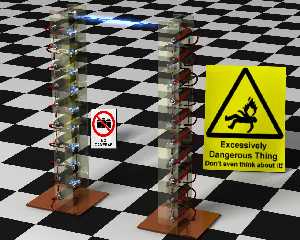

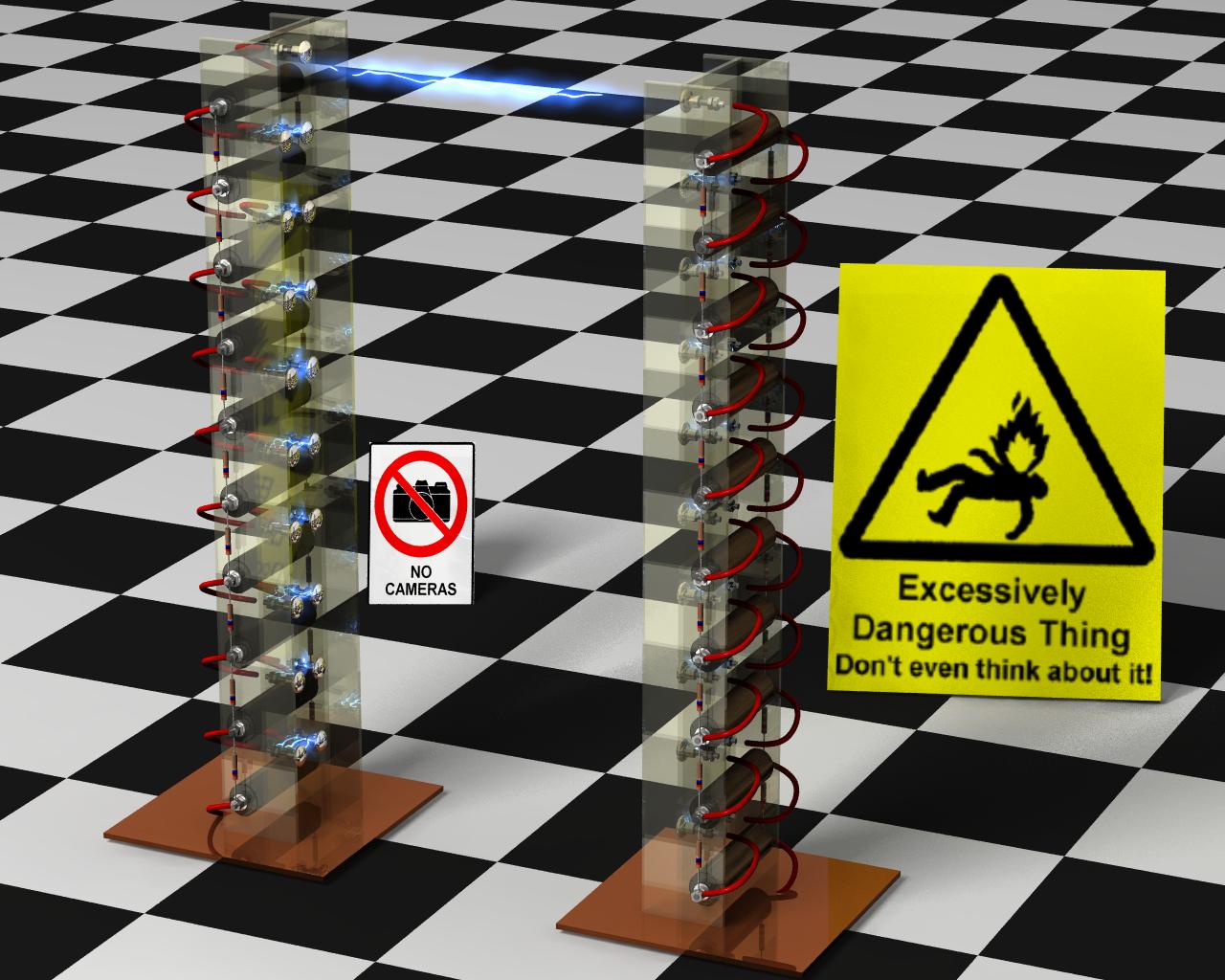

Latest improvements, but my sparks still don't throw any light.
Also, still having trouble getting the spark ends to end at the terminals.

Dave VanHorn nous apporta ses lumieres ainsi en ce 2004/05/19 21:17... :
Double check that you have "media on" in the radiosity settings.
Try broadening the bright part of your media, so there is more of it to
emit light.
If scaling down, multiply the density by as much as you reduced the size.
Hoping to be of any help :-)
From: Dave VanHorn
Subject: Re: Big Whopping Sparks
Date: 21 May 2004 00:34:07
Message: <40ad86bf@news.povray.org>
I do.
emit light.
Thought about it, but then it dosen't look real.
I posted the spark code, and now I'm using the fixed macro that Ger posted
yesterday with a string of lights.
Originally, I had a spline sweep, but I wasn't having any luck getting good
shapes, or illumination from it.

I like the way your images are progressing.
I've been around a long time and never heard of these things. They
sound (do you still have neighbours?) very interesting to play with
:-) Better than Tesla coils?
Q1 About how long does it take from power-on to discharge?
Q2 Can you charge the caps to just below the discharge point and then
trigger the contraption with a pulse?
Alf (very curious)
Typically seconds, but it mostly depends on your power supply.
In some versions, the resistors are replaced by inductors, so there's
essentially no resistance in the system.
Sure, or use a high voltage relay to fire the first gap. The UV from it
triggers the others.
> Alf (very curious)
The sign on the right is fairly serious.
I work with 15-30kV sometimes, and that is done with two in the room only.
One working, one standing by.
