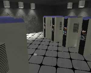

From: Steven Pigeon

From: Felbrigg
Subject: Re: The Core (WiP, v2)
Date: 20 Apr 2004 04:33:02
Message: <4084e03e$1@news.povray.org>
Whats the white spot on the floor?
From: andrel
Date: 20 Apr 2004 04:41:07
Message: <4084E20F.8000500@hotmail.com>
I think it is a reflection of one of the spots
and Steven has one finish for the tiles and the
stuf in between (whatever that is called in English).
From: Steven Pigeon
Date: 20 Apr 2004 09:09:04
Message: <408520f0$1@news.povray.org>
Yes, one finish. It's a WIP... things will be
better eventually.
How do I boost constrast in a scene ? (besides
post-processing ?)

From: andrel
Date: 20 Apr 2004 09:37:20
Message: <4085277B.9030102@hotmail.com>
> better eventually.
They always will.
> post-processing ?
In ray tracing usually with objects and lights.
Talking about lights, you have one row of lights
over a couple of you machines and another row at
the end of the room, illuminating nothing really.
IRL light are normally used to provide light for
human beings to see what they are doing.
In this room there are nearly no lights where they
would be useful. If you move the lights more to the
center of the scene and add a table (perhaps even
a table tennis or snooker table ;) ) or something
else in the middle you might get more 'contrast'
in the scene (for one meaning of contrast).

From: Steven Pigeon
Date: 20 Apr 2004 13:23:23
Message: <40855c8b$1@news.povray.org>
Except for indirect lighting. You can have a torchère
lamp pointed at the ceiling and get a nice diffuse lighting
for the room. That's what I tried to get.
May try this...
Best,
    S.
From: Samuel Benge
Date: 20 Apr 2004 15:10:06
Message: <40857539.2090906@hotmail.com>
> better eventually.
> post-processing ?)
Steven,
The easiest way to increase the contrast in a scene is to put this
around your camera:
sphere{<0,0,0>,1 pigment{rgbt<1,1,1,1.5>}}
It might help to bring the assumed_gamma down to 1.0 in global_settings.
Try these changes with radiosity to really see a difference. Hope this
helps~
-Samuel Benge

From: Christopher James Huff
Date: 21 Apr 2004 09:00:05
Message: <cjameshuff-2A6290.09011421042004@news.povray.org>
In article <408520f0$1@news.povray.org>,
> post-processing ?)
Make sure ambient is 0 in all textures that aren't supposed to be
glowing. It's easiest to set this with the #default directive, though
you have to watch out for any textures that define non-0 ambient values.
(such as most of the textures in the include files)
Then use radiosity for indirect lighting.
POV-Ray TAG: <chr### [at] tagpovrayorg>
http://tag.povray.org/
Date: 21 Apr 2004 09:01:15
Message: <cjameshuff-543CF9.09022421042004@news.povray.org>
In article <408### [at] hotmailcom>,
Which is where it should be anyway, unless you're updating an old scene
created without any gamma correction...

From: Francois Labreque
Date: 21 Apr 2004 19:29:52
Message: <408703f0$1@news.povray.org>
Program ended abnormally on 19/04/2004 18:57, Due to a catastrophic Steven
Pigeon error:
> Steven Pigeon, Ph. D.
Cool pic.
But I think that with processing power of this kind, you're going to need a
raised floor to pass the wiring and cold air underneath.  And usually, raised
floor tiles don't have these rounded corners.
I've spent too much time slaving away in computer rooms!  Sorry.  Had to nitpick.
