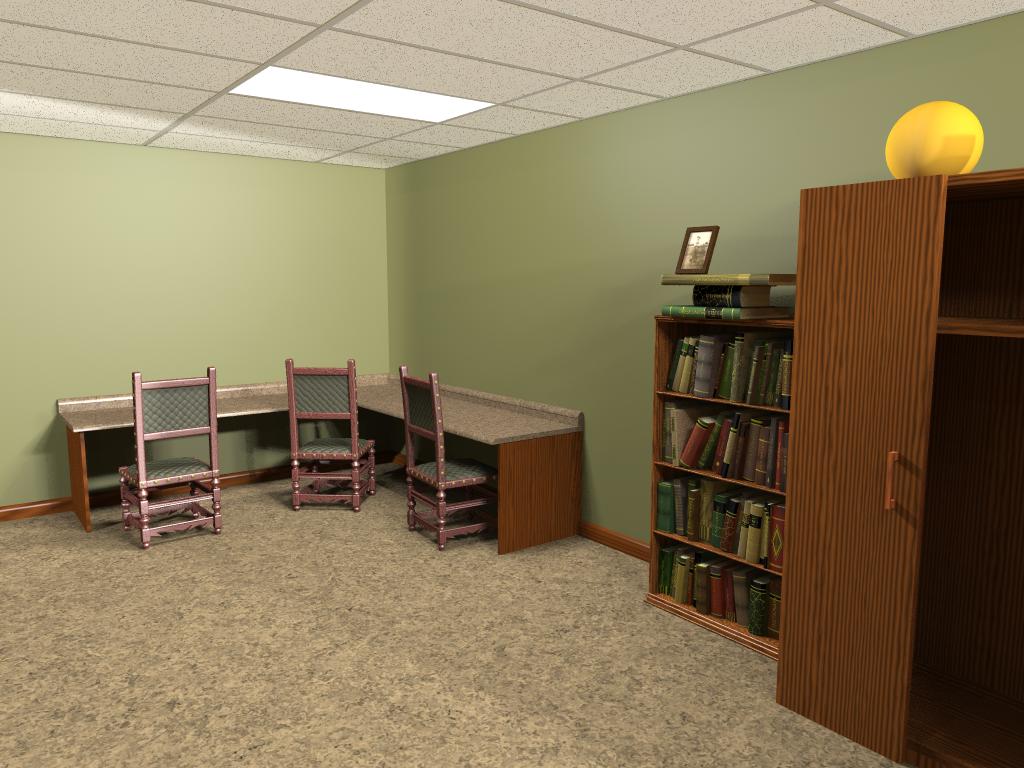

I'm building a new computer wall-desk in my basement, which will hopefully
be large enough for our 3 computers, plus 3 people.  If not, we'll probably
have to keep one of our current desks.
Anyway, one of my first POV-Ray exercises was to build a fairly decent model
of my basement.  At the time, I had absolutely no idea what I was doing, but
it turned out fairly well anyway.
Well, I thought it would be nice to get a decent idea of how my desk would
actually look in the basement, so I put this together.  I've noticed a few
mistakes, but since I'm not making a poster out of this, I guess I really
don't care very much.  However, please feel free to suggest things, as I
still have much to learn, and this is a fun little side-project.
One thing I couldn't get right was the flourescent light.  It just doesn't
seem like it's emitting light (ambient 1 + an area light source +
radiosity).  I changed the ceiling tiles to actually look like my real
ceiling, which I finally installed a couple months ago.  I never could get
the carpet quite right with procedural textures.

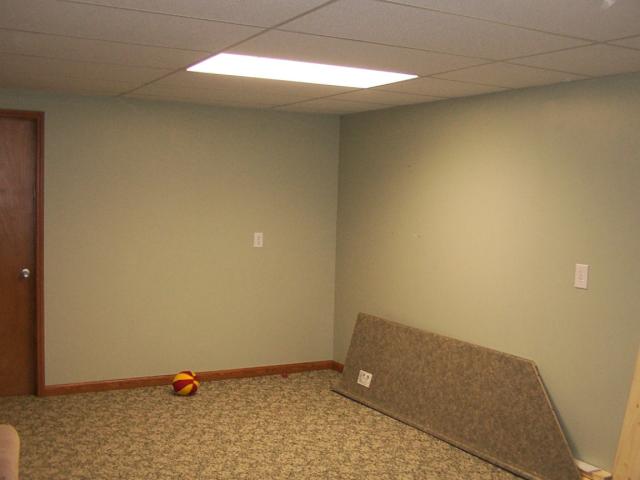

Incidentally, my real basement has a door just a few inches left of the left
edge of the desk.
(Chairs and library/books courtesy of Gilles Tran's macros.)

Hey, that's excellent, but aren't the chairs a little low?

One suggestion on that ... if you're putting it up against the wall,
make the desk *deep*, and make sure there's holes for the wires down the
back, of course. At least 4 feet deep, unless you're committed to flat
monitors. ;-)

I'm using a similar setup at work, both surfaces are about 26 inches deep.
However, at work, I have a keyboard tray (a fairly nice one, actually).  The
person in the corner (probably me) should be plenty deep, but I'm not sure
how nice it will be in the corner spot, and where to put the keyboard.  I
have a keyboard tray which is part of another desk, that I can attach
underneath one side (unless I decide to spend more money and build my own).
Cheap keyboard trays are cheap, but it is possible to get by without one.
However, that could determine exactly how high I build the desk, so I guess
I should get that figured out.  (I think I'm rambling now.)

I think I may have removed "ambient" from the finishes in that set of macros
to get it to look right with radiosity without turning off all radiosity
everywhere.

What type of support are you planning on using at the L? I don't believe
this design is going to work. Nice looking, though.
Depending on the tools you have, I might suggest a three part top with
legs under the two seams. The wall showing under the table looks nice,
but you'll definitely need some support back there.
I don't know what your carpentry skills are like, but I can offer some
more (very) specific advice if it would help.
 -Shay

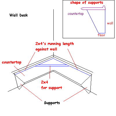

Here's my actual design hashed out in Paint, as well as a picture of my
"real" basement, though I'm not sure why I'm throwing that in.  Since doing
this drawing, I've decided to leave the end support boards in their
rectangular shape, since I don't have a table saw (just a cheap compound saw
and skilsaw).
The plan is to support the back side with 2x4's against the wall.  Where the
two mitered pieces meet (in addition to using the supplied bolts), I'm
planning on using another 2x4 screwed into the others.
I could see the middle area possibly needing more support.  One alternate
idea was to place another "support" piece (like the two end boards) kitty
corner through that section, replacing the angled 2x4.  Also, I'm planning
to put the outer supports closer to the edge than they are here.  I'm
planning to use brackets and "liquid nail" glue to attach most of the pieces
that can't be attached in other obvious ways.
Please offer ([very] specific) advice.  I'm new to this, and won't be
offended.  :-)  I've done most of my basement by myself, and frankly, it
shows, though I'm still somewhat proud of myself.  Should that be moved to
p.o-t?
Perfection is easy in POV-Ray.  Imperfection is difficult.  Real-life is the
opposite.  Yet in each, we try to achieve the other.  *sigh*
Jeremy
www.beantoad.com

Download 'walldesk.png' (5 KB) Download 'DCP_0001a.JPG' (25 KB)
Preview of image 'walldesk.png'
Preview of image 'DCP_0001a.JPG'
> my "real" basement, though I'm not sure why I'm throwing that in.
> Since doing this drawing, I've decided to leave the end support boards
> in their rectangular shape, since I don't have a table saw (just a
> cheap compound saw and skilsaw).
Realy very good reassemblence, if only walls in render where less "green"
Not sure, really.  I scaled them at 2.7, where 1 unit = 1 foot.  The
counter-top is 2.2 feet high.  That might put the chair seats at perhaps
14-15 inches from from the floor (judging from the picture), which would be
a little low, I think 17-18 is about normal.  So, I think the chairs need to
be slightly bigger, yes.

it might be a good idea to position some suitablely sized monitors
(boxes) /keyboard/mice mats, together with the areas representing arm
and elbow movement over the desktop (polygons?), also maybe cones
representing eye to monitor line
basically nothing to fancy
seems rather tight for three seats - good friends i hope :-)
stephen
From: Gilles Tran
Subject: Re: My basement with desk
Date: 7 Apr 2004 05:23:13

The basement looks great in the photos.
I'll post something in p.o-t Thursday evening if not before. I can tell
you now that Formica countertop cannot be used as a building material.
It will sag under its own weight if not supported on all four sides.
Even if that were not the case, you can only screw into it a half inch.
The formica countertop will only be a cover for a frame which must be
sturdy without it.
You will need some type of leg at the L, but it can be set back far
enough to make room for a chair and knees there. Still, you won't want
to sit on the edge of this desk. I will post a detailed plan Thursday
evening which can be realized with your tools.

What you can't see is how I used too much joint compound, which resulted in
wavey walls at the dry-wall seems.  No one notices, if I don't point that
out, though.  That and a couple other minor things, like holes that were
just just a tad too big (or too high) for the electrical outlets.  We had
someone else do the carpeting, and they did a great job.  We just recently
stained the doors and added the base and door trim.
> sturdy without it.
Thanks!  I think I'm starting to see what you mean about the frame.  In
particular, the miter joint would probably be under a great amount of
stress.  I don't mind buying a few more boards, if necessary.  I've also
considered possibly needing addtional supports, like the edges, in the
middle.  I'd just want to make sure they were not in knee range (i.e. I'd
like to keep them between the chairs).

"Jeremy M. Praay" <jer### [at] questsoftwarecom> wrote in message
news:40744621@news.povray.org...
| In particular, the miter joint would probably be under a great
| amount of stress.  I don't mind buying a few more boards, if
| necessary.  I've also considered possibly needing addtional
| supports, like the edges, in the middle.  I'd just want to make
| sure they were not in knee range (i.e. I'd like to keep them between
| the chairs).
Depends on how much you want to spend. If you've got the scratch for a
couple sheets of 3/4" plywood, then you can support the whole thing with
angle brackets and it could *almost* double as a guest bed. This is the
way I would go. It won't be cheap, but you could be enjoying it by next
weekend.
It can be done with boards as well, but sliding keyboards would be less
convenient and the construction process would take a lot more time. Plus
you would need that center leg, though you could set it back up to
twenty inches (fourteen inches from the corner of the room).
-Shay

Is that a "real" picture? It looks like a POV rendering, especially the
lighting... I guess it goes to say how realistic some scenes are :-)
Have you tried replicating that same picture?
Yes, even a novice can make pretty realistic scenes.  Radiosity + area
lights can do wonders.
Not exactly like that.  I actually took that picture a couple days ago, long
after my scene was already complete.  I've thought that some day I might use
my basement scene as part of a "real" scene, but so far, I haven't really
thought of anything inspiring going on in my basement.
