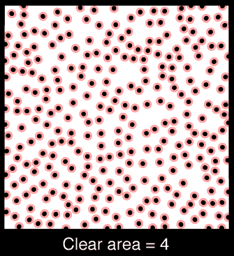

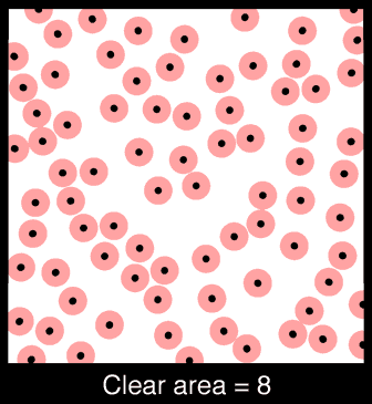

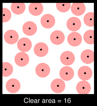

I'm working on some code to pack a number of objects - presumably
vegetable-based, but I guess a person could pack anything they want -
into a rectangular area. It uses arrays to store the locations of
individual "trees", and tests randomly-placed trees against those
already in the arrays to make sure that their "clear areas" don't
overlap. A confidence value tells the code to give up and stop placing
trees after a user-defined number of placement failures.
Because of the random nature of the code and the need to test against
every other tree when placing a new one, scenes with a lot of trees take
a long time to parse; the example below using "clear area = 4" took 31
minutes on my Mac G4/867! I'm contemplating some kind of automatic
bounding so the code only tests new trees against old trees in the same
area, which should help more the more trees there are. Other planned
improvements include the ability to use multiple patterns to affect the
success of tree placement, the ability to have any number of "layers" of
trees with different placement characteristics, and some kind of
probability system using either a user-defined threshold or a random
test to determine whether placement in an unlikely area (such as on a
steep slope, or close to another tree) succeeds.
Whether I'll actually MAKE any of these improvements remains to be seen...
-Xplo

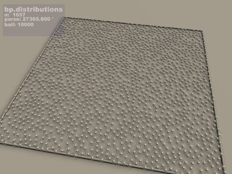

From: bp
Subject: Re: Forest generation (or; crude packing)
Date: 30 Mar 2004 23:59:27
Message: <406a502f@news.povray.org>
can i show mine?
i did this ages ago, and was planning to make some improvments to my
otherwise totally brute force method, but i was pleased enough with the
final image anyway. Sorry, i've probably lost the source, but i could
have a dig around for it.
(in the top left panel, n is the number os dots, parse is the time it
took to parse in seconds, i think, and bail is the amount of times it
has failed and then bailed out to start rendering. Jeepers - it looks
like this one took around 7 hours to generate!)
benp
Download 'hwdistributions3b.jpg' (34 KB)
Preview of image 'hwdistributions3b.jpg'
> benp
Download 'hwdistributions3_reallyfine.jpg' (55 KB)
Preview of image 'hwdistributions3_reallyfine.jpg'
From: Florian Brucker
Date: 31 Mar 2004 06:18:19
Message: <406aa8fb$1@news.povray.org>
Now the second one rocks! Can't see the parsing time properly, but it
must have been quite some days :)
Florian

From: bp
Date: 31 Mar 2004 19:20:18
Message: <406b6042@news.povray.org>
cheers! i'd love to get back to it one day.
i think it says it took 21 hours to parse! (the unit is in seconds..)
bp
