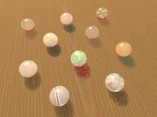

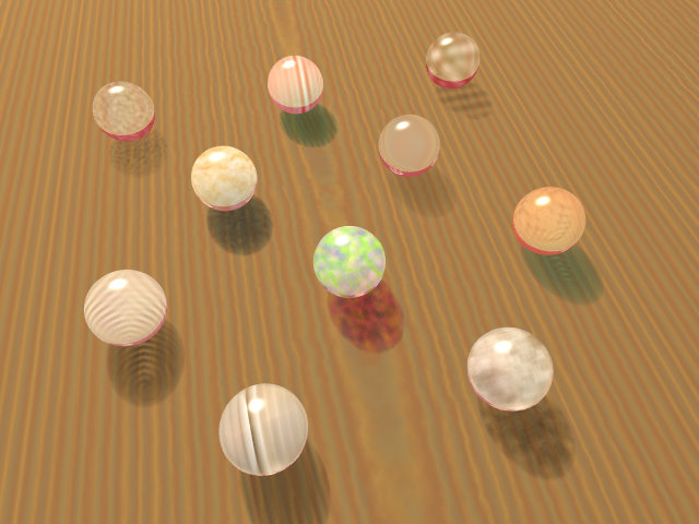

I played with scattering media and variable density. All spheres have a
density pattern with its standard parameters and its standard color_map. I
adjusted only the scaling. It's quite interresting what you can do with
media.
Download 'vardens.jpg' (58 KB)
Preview of image 'vardens.jpg'

Neat! It looks like the transmit value might be a bit high -- what happens
if you set transmit to 0?

I don't understand you. Changing the transmit value of the pigment of the
spheres wouldn't make any sense because you would only see white balls.
This is the only transmit in this scene. All other transmit values should
be 0.

I need to see the code to understand what you mean. The marbles looked
like you had a transmit value to them because of the unnatural look
inside. But, I could be totally off my rocker on this (making this just
another one of the billions of things I'm off my rocker on) so without
the code, I'm just making wild guesses. :-)
A ball looks like this:
sphere {
  0, 0.5
  pigment { rgbt 1 }
  finish { phong 0.8 }
  hollow
  interior {
    ior 1.5
    media {
      scattering { 1, rgb 1 extinction 1 }
      density {
        crackle
        scale 0.1

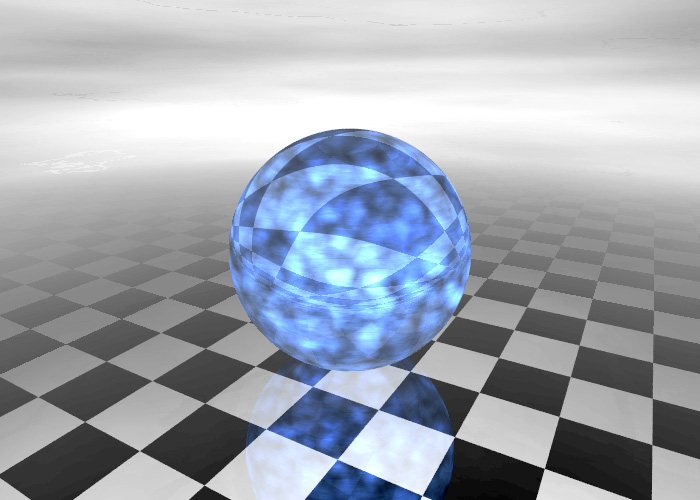

I played around with it a bit and came up with this scene for fun:
#include "colors.inc"
// radiosity (global illumination) settings
global_settings {
   radiosity {
     pretrace_start 0.08           // start pretrace at this size
     pretrace_end   0.04           // end pretrace at this size
     count 35                      // higher -> higher quality (1..1600)
[35]
     nearest_count 5               // higher -> higher quality (1..10) [5]
     error_bound 1.8               // higher -> smoother, less accurate
[1.8]
     recursion_limit 3             // how much interreflections are
calculated (1..5+) [3]
     low_error_factor .5           // reduce error_bound during last
pretrace step
     gray_threshold 0.0            // increase for weakening colors
(0..1) [0]
     minimum_reuse 0.015           // reuse of old radiosity samples [0.015]
     brightness 1                  // brightness of radiosity effects
(0..1) [1]
     adc_bailout 0.01/2
     //normal on                   // take surface normals into account
[off]
     //media on                    // take media into account [off]
     //save_file "file_name"       // save radiosity data
     //load_file "file_name"       // load saved radiosity data
     //always_sample off           // turn sampling in final trace off [on]
     //max_sample 1.0              // maximum brightness of samples
camera
	location <0, 0.7, -2>
	look_at <0, 0, 0>
	up y
	right image_width / image_height * x
background
	rgb 0
sphere
	0, 0.5
	hollow
	pigment { rgbft <1, 1, 1, 1, 0> }
	finish
		//phong 0.8
		specular 0.8 // New syntax is "specular"
		reflection 0.1
		conserve_energy // Often helps, but does not affect this image.
	interior
		ior 1.5
		media
			absorption 0.1
			scattering
				1, rgb 1
				extinction 1
			density
				crackle
				scale 0.1
				color_map
					[0 rgb 0 ]
					[1 rgb <0.4, 0.6, 0.9>*-1*10 ]
plane
	y, -0.5
	pigment
		checker rgb 0 rgb 2
		scale <0.3, 0.3, 0.3>
		rotate 30*y
	finish
		ambient 1
		reflection 0.6
		specular 1
sphere
	0, 6
	hollow
	pigment
		color rgbft <1, 1, 1, 1, 0>
	finish
		ambient 0
		reflection 0
		specular 0
	interior
		media
			emission rgb 1
			absorption 1
			scattering
				3, 1
			density
				wrinkles
				scale <1, 0.1, 1>
Respectfully,
Dan P
http://<broken link>
Download 'test.jpg' (80 KB)
Preview of image 'test.jpg'
Fantastic! You use nice tricks in this scene. I will remember them ...
