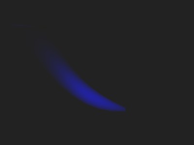

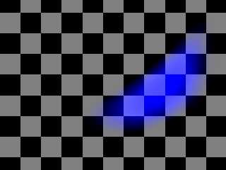

The flame is a bezier patch with scattering media. In flame1 the only light
is a blue spotlight at its base, and it's almost acceptable. As soon as I
add a point light to the scene (flame2), it's totally unacceptable. I've
tried tweeking everything I can think of, and can't keep the outside of the
bezier patch from showing. Is there a way to fix this, or am I going about
it all wrong?
Steve Shelby

From: Timothy Cook
Subject: Re: Gas Flame (needs help)
Date: 21 Mar 2004 09:23:59
Message: <405da57f$1@news.povray.org>
don't forget to make the point light not interact with media
Tim Cook

From: Steve Shelby
Date: 21 Mar 2004 09:31:08
Message: <405da72c@news.povray.org>
I thought of that, but my eventual goal is to have a tea kettle sitting on a
gas burner with steam coming out of the tea kettle. I don't know how to do
steam yet, but I thought it might also involve media. Am I wrong about that?
Steve Shelby

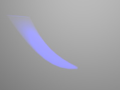

What do you think of this one?
		Jérôme

From: Steve Shelby
Date: 21 Mar 2004 12:24:44
Message: <405dcfdc$1@news.povray.org>
I like! How did you do it?
Steve Shelby

From: "Jérôme M. Berger"
Date: 21 Mar 2004 12:49:50
Message: <405dd5be$1@news.povray.org>
Hash: SHA1
	Basically, it's just an emitting media with a proper density function.
I'll post the source to p.t.s-f, but I must warn you that it probably
will only work with MegaPov 0.7 since it uses emission method 2 media.
However, it should be portable to 3.5 by using standard emitting media
(it just won't look as good on a bright background).
		Jerome

From: Tek
Date: 21 Mar 2004 19:22:53
Message: <405e31dd$1@news.povray.org>
"Steve Shelby" <ssh### [at] rexnetnet> wrote in message
news:405d9c7a@news.povray.org...
> it all wrong?
Dunno if this is the sort of thing you're after, but I've got this flame that
looks pretty good under most lighting conditions:
http://www.evilsuperbrain.com/gallery/index.php?gallery=wip&movie=boostertest
The media just uses emission, so it won't be affected by lights. Plus the
density drops to 0 at the edge of the bounding volume, so you can never see the
shape of the object.
The source is as follows:
#declare fBoosterGlow = .4;
   cylinder {
      <0,0,0>, <0,0,-1>, 1.2
      pigment { rgbf 1.0 }
      hollow on
      interior {
        media {
      emission 32.0*fBoosterGlow
        absorption 4*fBoosterGlow
      #declare cocentric_rings = 3;
        density {
         function { min(max( pow( -z, 0.25 ), 0),1) }
         density_map {
          [0.0
           wood
           sine_wave
           //poly_wave 1.0
           phase -0.25
           scale 1/cocentric_rings
           density_map {
            [0.0 //rgb 0]
             cylindrical
             poly_wave 2
             rotate <90,0,0>
             scale cocentric_rings
             colour_map {
              [0.0 rgb 0.2*<0.0, 0.0, 0.2>] //dark (i.e. pale) blue
              [1.0 rgb 0.2*<2.0, 1.0, 0.5>] //bright orange
             } //colour_map
            [1.0 //rgb 1]
             cylindrical
             poly_wave 2
             rotate <90,0,0>
             colour_map {
              [0.0 rgb <0.0, 0.0, 0.2>] //dark (i.e. pale) blue
              [1.0 rgb <2.0, 1.0, 0.5>] //bright orange
             } //colour_map
           } //density_map
          [1.0 rgb 0]
         } //density_map
        } //density
        } //media
      } //interior
    scale <1,1,6>
   } //cylinder
Hope that helps.
Tek

",str(zPos,6,4))
      #local f=f+1;
    #end
    hollow
    pigment { rgbt 1 }
    interior {
      media {
        method 3
        emission 0.80//rgb <1,.7,.25>
        density {
          gradient y
          color_map {
            [0.0 rgb <0.2, 0.3, 0.8>*0.8]
            [0.3 rgb <1.0, 0.7, 0.25>]
          scale 2
        density {
          spherical color_map {
          [0.45 rgb 1]
          [.5 rgb 0]}
        scale 1.5/4
        translate 0.3*y
    rotate rand(longueur)*360*y
    scale <rayon,2.5*rayon,rayon>*2
    translate (FAltitude+1)*y
    no_shadow
  #end
  // -- light -----------------------------------------------------------
  #if (drawLight)
  #declare theLight = light_source {
    <0,FAltitude+1+2*rayon,0>
    rgb <1.00, 0.75, 0.50>
    fade_distance 25 //50 ?
    fade_power 2 //3
    #if (useAreaLight)
      area_light
      1.5*x,1.5*y,3,3
      adaptive 0
      jitter
      orient
      circular
    #end
    media_attenuation on
  #end
  // -- glow ------------------------------------------------------------
  #if (drawGlow)
  #declare theGlow = box {
    -1,1
    hollow
    no_shadow
    pigment {rgbt 1}
    interior {
      media {
        method 3
        emission 0.035
        density {
        spherical
        color_map {
          [0.00 rgb <0.00, 0.00, 0.00>]
          [1.00 rgb <1.00, 0.80, 0.12>]
        turbulence 0.1
        poly_wave 2
    translate y/2
    scale <rayon,rayon,rayon>*9
    translate FAltitude*y
  #end
  union {
    object { theFlame }
    object { theLight }
    object { theGlow }
#end
#declare alea = seed(0);
object {
  flamme(0,3,alea,true,true,false,true)
  translate <0, 57, 5>
Download 'briquet.jpg' (4 KB)
Preview of image 'briquet.jpg'
