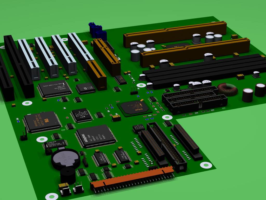

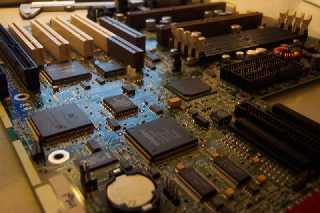

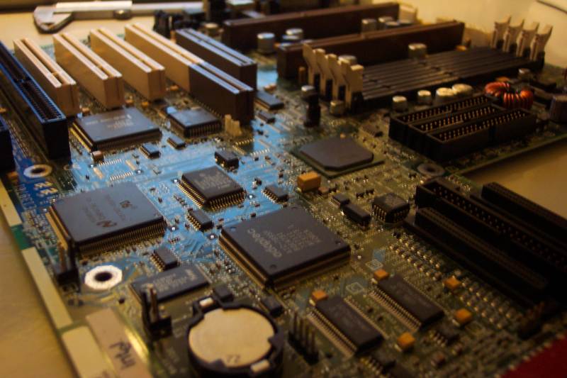

Prompted by a post a few days/weeks ago I looked up a project I worked on a
few years ago
This is an actual mainboard (Intel DK440LX, see pic)
I stopped working on it because I couldn't figure out how to make the
printed tracks and the silkscreen (the white prints). I tried scanning and
photographing it but it didn't come out good enough. And handcoding all the
wires and texts is a bit too much work
Ideas, comments, complaints etc welcome
Ger

Okay, WOW... ambitious!!!
For the silkscreen, how about building a hi-res texture for it in
Photoshop/Gimp/etc? You can use the circuit traces as a bump_map too to get
a raised look.
Also, try adding a little "specular" to your "finish" and you'll get that
silicon look. I'm guessing maybe 0.4 would be a great value.
Add a skysphere with some pigment to bring out the reflections.
I can't see the holes in the IDE slots -- did you do a "difference" to
create those? If so, try making the cylinder(?) a little darker than the
plastic you're "punching in" to bring out the holes a bit.
This is freeking' sweet.
I love this board (pun intended!)
> get a raised look.
For that you need a hires scan and that gets frigging huge because it's a
very large board (305x330 mm). I have tried it though but it didn't work
out, the scan never came out good enough
There is a skysphere although it's pretty dark
I don't understand which holes in the ide slots you mean
You mean the holes in the board? they are that light because of the
underlying plane
Thanks :)
Me too, only problem is, it's dead :(
Ger
From: Dan P
Subject: Re: Mainboard (2 attachments)
Date: 12 Feb 2004 19:21:11
Message: <402c1877$1@news.povray.org>
"Ger" <ger### [at] ThomeDOTnl> wrote in message
news:402c0472@news.povray.org...
What about drawing it? It might take a really long time, but it would
guarantee really good results.
that
Ah :-)
The white slots in the middle-top of the image. There are a series of
holes -- ya know, I have no idea why there are there, really -- in the
middle. I think they actually might be rectangular holes, come to think of
it. Same with the orange slots. A macro could fill those in really easily.
> underlying plane
Nope; the ones in the plastic slots themselves. For the cards :-)
> Thanks :)
AH, but it shall live on forever as a work of POV-Ray art!!! :-)
Unless... you don't mean povray.binaries.images, do you? *gulp*. This board
is the highlight of my day.
