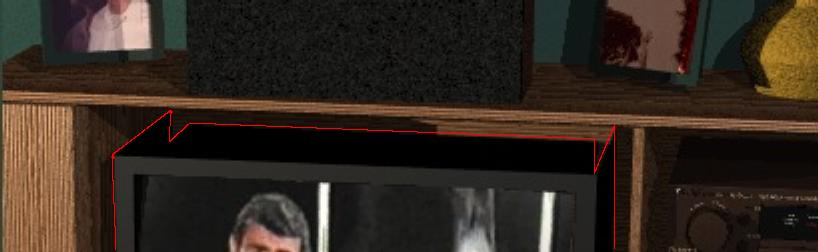

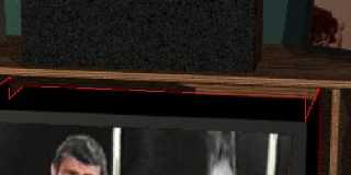

I've had planes appear in my CGS's before.  For example if one of the pieces
you differenced out of your box had a co-incident surface with the side of
the box it could leave just that plane sticking out by itself.  Look at the
circled areas in the attached picture.  Why are there wooden teeth sticking
down into the top of the TV?  Is this something sitting on top of the TV?
Maybe I'm just not looking at it correctly but it looks odd to me.
Carl

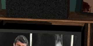

From: Eric Freeman
Subject: Re: Repost: My Stereo (jpg-19k)
Date: 23 Dec 2003 21:00:31
Message: <3fe8f33f@news.povray.org>
"Carl Hoff" <hof### [at] wtnet> wrote in message news:3fe8df9e@news.povray.org...
> of the pieces you differenced out of your box had a co-incident
> surface with the side of the box it could leave just that plane
> sticking out by itself.  Look at the circled areas in the attached
> picture.  Why are there wooden teeth sticking down into the top
I think it's just the lighting.  Here's a close up with brighter lights.
The top of the TV is the top of the grey frame around the picture.  There is
a gap between the top of the TV and the top of the cabinet.  There is a wood
back on the cabinet that can be seen over the top of the TV.
Eric

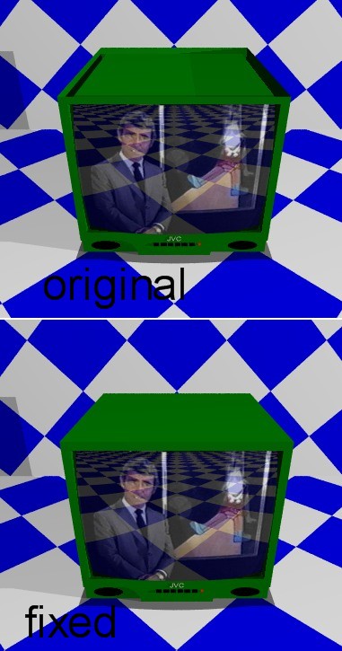

From: Carl Hoff
Date: 24 Dec 2003 08:50:03
Message: <3fe9998b$1@news.povray.org>
The 'teeth' (for lack of a better word) are still there and it doesn't
look like the lighting to me.  Could you render just the TV by itself
against a white background?  I tend to think its a co-incident surface
artifact.
Carl
is
wood
> Eric

Is the top of your TV shiny?  I agree with Carl, there seems to be something
wrong...  To me the outline of the TV looks like this:
Download 'closeup.jpg' (24 KB)
Preview of image 'closeup.jpg'
From: Carl Hoff
Date: 24 Dec 2003 14:27:00
Message: <3fe9e884@news.povray.org>
Thanks... atleast I now know its NOT just me seeing things.

I found the problem... a misplaced bounded_by/clipped_by statement.  I would
have never spotted it... thanx dudz.  One day I'll finish this pic (the back
of tv isn't contoured like the real thing... it's just a box).
Eric
Download 'tv_alone.jpg' (72 KB)
