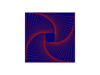

I would like any help someone can give regarding a math problem in Povray.
I have included an image of what I'm trying to accomplish, however it's
never quite perfect.  I'm trying to start with a small square in the center
(1x1 size) and increase its size to 5x5 and rotate the square as I go.  I
want the squares to match up so each square corner perfectly matches up with
a line on the next larger square.  Basically end up with a curving line made
of many squares. I'm doing it all by trail and error and never getting it
clean enough.  The square image here is small and doesn't show the
discrepancies as much, but once it is increased in size it never lines up
cleanly. Is there a math formulae to create this?  Is there a name for this
type of thing?
Thanks for any help!
Patrick Dugan

Download 'RotatingSquares.jpg' (58 KB)
Preview of image 'RotatingSquares.jpg'

From: Patrick Dugan
Subject: Re: Rotating Squares problem
Date: 8 Oct 2003 13:45:41
Message: <3f844d45$1@news.povray.org>
Well I used the orthographic view and it really makes the discrepancies
stand out.  While it helps in seeing the drawing "head on"
it still doesn't help in the math of things.  I rather not keep using trial
and error math if a formulae is around that would
make it cleanly.

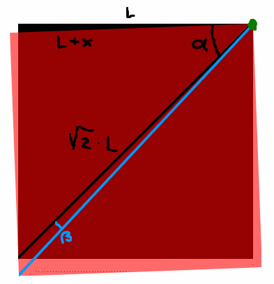

From: Jellby
Date: 8 Oct 2003 16:20:19
Message: <3f847181@news.povray.org>
> center
> with
> made of many squares. I'm doing it all by trail and error and never
> getting it
> this type of thing?
If I have understood it correctly, this is what you want (see picture
attached).
The green corner (top-right) is the center of the squares, so that what you
see are just the lower-left quadrants. The black square is the "old" (and
smaller) one, with side L, the red square is a larger one (side L+x) laid
over the black one and rotated.
As it is drawn, the cosine of the angle alpha is (L+x)/(sqrt(2)*L), but
you're interested in angle beta, which is:
beta = 45 - degrees(acos( (L+x)/(sqrt(2)*L) ))
beta = 45 - degrees(acos( (1+x/L)/sqrt(2) ))
If, as it seems, you want to make the squares smaller and smaller, just
substitute L+x -> L and L -> L-x:
beta = 45 - degrees(acos( L/(sqrt(2)*(L-x)) ))
... unless I've made a mistake...
I didn't quite follow the source posted here and saw that your problem
is already solved but since I've been struggling with the exact same
things some time ago and only barely worked it out, by trial and error,
it struck me now that there might be a fairly simple solutions: drop the
rotation part!
Start with the bottom square (or box), move from the corner along the
side for a fixed percentage of the side length, do that for every side
(in the same direction). The four resulting points will form a new
square.
Put this in a recursive macro and there you go.
Toch? Jan?
Remco

I'm unschooled in the field of traditional trigonomentry usage.... where
did you get the number 4.725?
None wrote:
> I think Reduce should simply be set to something like:
> #declare Reduce = X * tan(radians(4.725));
Samuel Benge
stb### [at] hotmailcom
From: Patrick Dugan
Date: 9 Oct 2003 21:15:47
Message: <3f860843$1@news.povray.org>
The number wasn't significant.  I simply testing various Z axis rotation
sizes and by trial and error (mostly error) ended up on that number.
"Samuel Benge" <sbe### [at] hotmailcom> wrote in message
news:3F8### [at] hotmailcom...
> Samuel Benge
From: None
Date: 10 Oct 2003 08:44:44
Message: <Xns941058FAA5D0BNone@204.213.191.226>
Samuel Benge <sbe### [at] hotmailcom> wrote in news:3F8588D8.6080308
@hotmail.com:
That was simply the angle Patrick was rotating by, I pluged in the angle he
was using in his code into a standard trig. equation:
tan(angle) = Opposite/Adjacent.
Trigonometry is the measurement of triangles.  A square can be broken down
into eight right angle triangles.  In the eighth of a square, the Opposite
(O) and Adjacent (A) are the same.  So if you change the angle while
keeping O or A the same, it will tell you how much the new A or O should
be.
Search the net for "trigonometry sin cos tan" for explanations of
trigonometry.

Efficiency?  In this case the square is centered at the origin, that's
where it's rotated from, so that's where the angle is, so we are dealing
with the eigtht, but we only care about _one_ triangle.  If you want to
just use two triangles to solve this case, you're going to have to do
more math, which would be innefficient.
Of course a square's triangle angle can't change, that is exactly what we
are taking advantage of in this case.  I said: the opposite and adjacent
sides are the same, so the angle is obviously fixed.  In this case, if
the angle changes, we are determining by how much we need to adjust the
sides to keep the angle constant.
It sounds like you took my message completely out of context.  I was
reffering to the problem at hand, the original question.
