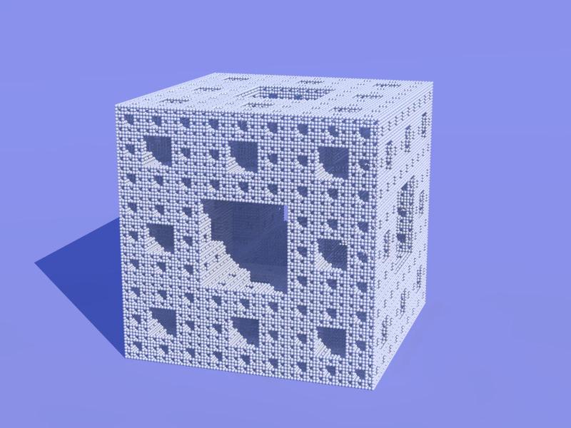

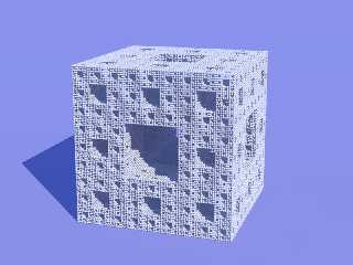

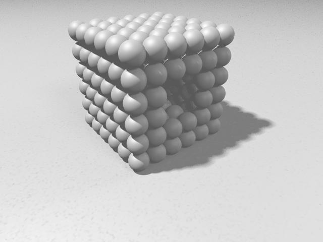

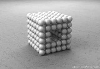

From: JC (Exether)
Subject: Re: Light on a few spheres
Date: 14 Aug 2003 02:49:30
Message: <3f3b30fa@news.povray.org>
Hugo's work impressed me and I decided to have deeped look into it, I
found an interesting tutorial on this famous three points lighting
technique ( http://www.3drender.com/light/3point.html ), and I tried it.
I post the result, but it's a very quick try, and not intended to look
real. But I had been using radiosity so often, and I realised I should
study lighting a bit more. Thanks for showing that to me.  :-)
As we're all starved from pov images and I did another render again
inspired by Hugo, I also post a menger sponge made of spheres (160k),
rendered with ... ahem ... radiosity. I'll also try to light it properly.
It's just to give you some stuff to chew,  ;-)
JC

> I'm using the general three-point-lighting technique, commonly used by
> photographers. In addition, I've worked on a little macro to .. how to say..
> enrich the built-in area_lights with some extra lights and a visible,
> glowing area. This area then reflects on the spheres so no specular/phong
> keyword is used. The spheres also have blurred reflections to further soften
> the look.
> As Tek noted, the material of the spheres are not easily recognisable. I'll
> work on that.
> JC wrote:
>>Did you have a look at  Jaime's syslight include file?
> Yes, I know Jaime's macros. I haven't used them here, except all the light
> has a realistic fade-out, as was described by him.
> Regards,
> Hugo

From: Rafal 'Raf256' Maj
Date: 16 Aug 2003 16:53:02
Message: <Xns93D9E8CDB99Eraf256com@204.213.191.226>
hua### [at] post3teledk news:3f3a3c5d@news.povray.org
> I'm interested in your critical opinion: On a scale from 0-10 (where
> 10 is best) how photorealistic would you rate the image? ...and what
> can be done to improve the light?
8, You can add focal-blur and maybe increase quality (radiostity) settings
- something is little wrong inside "box" (in dark area) or maybe is it due
to image compression?
From: Hugo Asm
Date: 17 Aug 2003 07:32:28
Message: <3f3f67cc@news.povray.org>
It has focal blur. The horizon is blurred, the object is in focus.
There are no radiosity used. This was on purpose, because of the simple
motif that doesn't spread the light around much. Whenever possible I stay
away from radiosity because  1)  It flickers in animation unless the quality
is really high   2)  It increases rendertime in most cases   3)  It doesn't
support network rendering on a single image.
You're right. It's noisy inside the hole of the box. This is because of the
blurred reflections on all the spheres. I use micro-normals, and I blur them
in one layer to speed up rendering. With focal blur samples set to 38, and
max_trace_level set to 3, there can only be 38*3 reflection-samples taken
for each pixel. Inside the box, this isn't enough for smooth results because
the rays go ping-pong between the spheres.
Thanks for your comments.  :o)
Hugo

From: Hugo Asm
Date: 22 Aug 2003 10:50:27
Message: <3f462db3$1@news.povray.org>
Hello again,
Thanks for the comments, DT and Nicolas! I'm posting the source now at
povray.binaries.scene-files. It's slightly rewritten in an attempt to clear
things out. But there are still things I'd like to improve.
The bitmap used for the ground is not included, instead I've included a
simple procedural texture, but you will get the same light as I got.
I've tried replacing the spheres with other objects, but not everything
looks as good.. It's always like that, isn't it? But this time, I don't
think it can be blamed on the light.
Hugo
