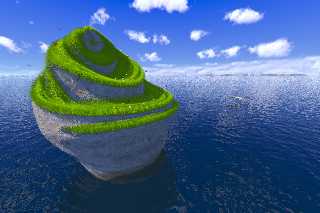

This scene must be nearing completion; every time I try to add something I get
about a dozen versions that look worse!
I spent a couple of hours moving the camera to get this view right now it's at
poster proportions (including playing with a vertically oriented poster),
eventually I decided this was best. Then I spent a while trying different things
to occupy the big empty space on the right of the picture: a big splash of water
(which was going to have a dolphin jumping out of it)? after about an hour
experimenting I concluded it was going to shift the focus too much, a sharks
fin? well that drew the eye, and looks silly.
After all of that I decided I needed a seagull, which took a whole evening to
build (it's made from blobs). It looks pretty good but I'm not sure about the
angle we're viewing it from, is it too hard to tell what it is?
Anyway, I personally think this is an improvement over v3, but only slightly.
I'm starting to think it's nearly finished (or as finished as it's going to
get), so I'll add a few more little details and then call it finished. I'm
thinking I'll add a distant flock of birds, and some fish swimming in the shadow
of the fractal.
But of course I'm open to suggestions for what to add, and any criticism of
what's already there. What do you think?
(BTW, apologies to those of you with low res monitors, but I really wanted to
keep the detail in this image!)
Tek
http://www.evilsuperbrain.com
Download 'grassy.jpg' (210 KB)
Preview of image 'grassy.jpg'

I like the mountains. I like the seagull. I hate that you have the
fractal stuck off to one side of the picture. It loses it's monolithic
quality when positioned that way. The sky looks cheesy to me too, but
perhaps it's just that too much of it is showing for my tastes. The
strongest point of interest for me is where the fractal meets the water.
 -Shay

I never really intended it to have a monolithic quality, but you have a point.
I'll try it in a more prominent position. I put it to one side to make a more
interesting large-scale picture, so different bits of the image show different
details.
The clouds... well I like them but that's mostly a technical thing (since
they're just 2D), but I have seen better so I may play with Gilles' makecloud
macros.
The point where the fractal meets the water has become much more significant as
I've moved the camera futher back. The darkness of it's reflection makes the
water appear very transparent, which is why I'm thinking of putting some fish in
there. Probably subtle orange/yellow fish to balance against the other colours
in the scene.
Thanks for your suggestions :)
Tek

I think I like the very first version the best. Adding anything that sets a
definitive scale on the island doesn't work with me, anyway. I always
figured the fractal to be huge, and overgrown with long grass, but the bird
makes the fractal look small and insignificant. same with the chair you had
on it.
> on it.
But surely the grass gave it a sense of scale?
To me it's always been about the same size, though actually I made the grass a
bit smaller in the later versions, to make the fractal seem slightly bigger.
Having said that, I do think the seagull is a little too big, but only slightly.
Tek

At first and second glance, I thought the flowers were leafs flying around.
They look like they're floating. Otherwise nice.

Very nice indeed. As you request for comments, here are mine:
- You should definitely think about more realistic clouds, with a real
volume and a dark bottom, like real clouds.
- I don't like the grainy aspect of the sea near the horizon, in real
world you would have a heat fog hiding that, maybe you can try softening
it with a thin ground fog so that the first plan sea remains clear.
- I like the distant flock of birds and fish in the shadow ideas
- The butterflies seem to be all in the same position with wings open at
120° or so, it would be more realistic to have a random 0-120° range.
(I'm not quite sure about this remark though, because the resolution is
not high enough, maybe we need a closeup)
JC
Still thinking about them...
I tried using some fog but couldn't get it to look right. I think the
graininess mostly comes from low quality blur settings (only 6 blur
samples).
Cool.
They are all at different angles, but like you say on this resolution that's
kinda hard to see.
Thanks for your comments.
Tek
> samples).
Yep, I just gave it a try, and it doesn't seem straightforward ...
Maybe you can try using a big sphere or a big cylinder (if you don't
want to have a round horizon) instead of a plane for the sea, that would
shorten the horizon distance. Maybe it can work better too with a ground
fog.
JC
From: Tek
Subject: Re: Grassy Julia v4
Date: 26 Jun 2003 13:59:04
Message: <3efb3468@news.povray.org>
"JC (Exether)" <no### [at] spamfr> wrote in message news:3EF### [at] spamfr...
Well it's not fog per se, I've used it in a lot of scenes before without any
trouble, the problem here is I've constructed the scene without fog, so things
like the sky sphere and the distant mountains are already coloured to look
foggy, which makes it ver hard to put fog in without it clashing with this
effect.
But, I've come up with a cunning plan, I'll just fade the colour of the water to
be a foggy colour in the distance! :)
> fog.
I tried ground fog, but that didn't help. A sphere would make sense, I normally
use that in my scenes but I got lazy when I did this one! The problem is a
realistic earth-sized sphere would still stretch off to the point where the
water gets grainy.
I think I'll work on a fake-fog effect and some nicer blur settings.
Thanks
Tek

The image looks great!  I'd like to be sitting on that thing.
I couldn't tell what the seagull was.  At first I thought it was a low
flying plane of some sort.  It seems a bit blurry to me.  Perhaps motion
blur?
I would be tempted to add two more fractals that are somewhat similar and
place them much further out/away on the right side of the image.
Patrick

From: Tek
Date: 27 Jun 2003 13:21:47
Message: <3efc7d2b$1@news.povray.org>
"Patrick Dugan" <pat### [at] usnetcomcorpcom> wrote in message
news:3efc4754$1@news.povray.org...
> blur?
Yeah there was too much focal blur, I didn't realise until after posting. The
close-up I posted has a lower amount of blur and looks much better.
Someone already suggested that, and like I said then: I don't want more
fractals, because I feel it works better being so out of place. :)
Tek
