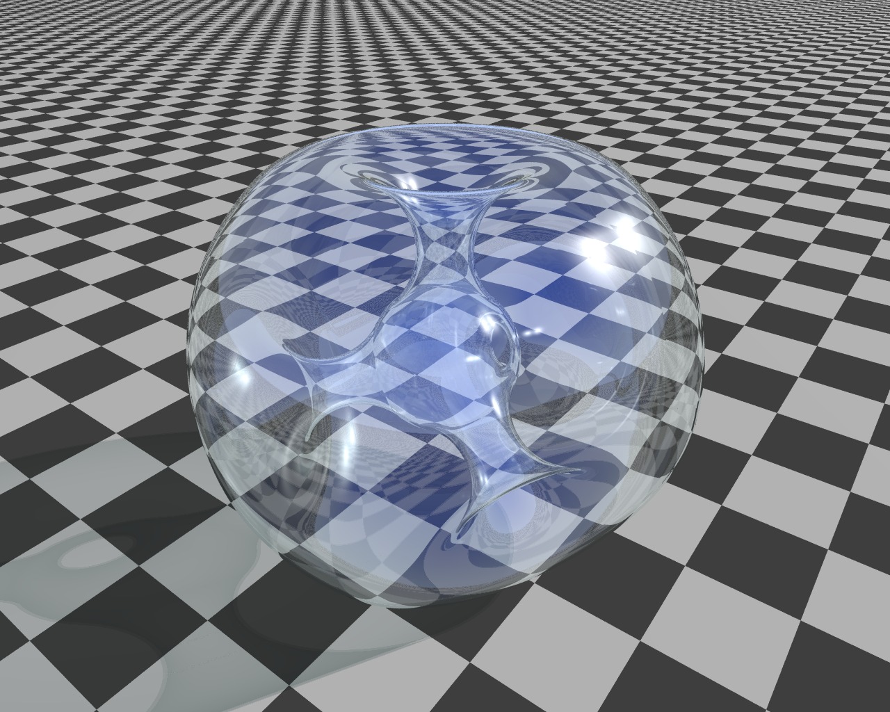

I was inspired by an image posted here (I wish I could remember the
author's name), and decided to make my first macro to generate a similar
shape.  I couldn't figure out how to do this shape with just Tori and
Sphere CSG, and had to use a Cone as well.  Unfortunately the 'seams'
are visible where the spheres are cut out and join with the tori.  Is
this an inherent problem with POV accuracy and rounding errors, or is
there a flaw in my math?  More importantly, is there a way to fix it?  I
will attach my source as well as the picture.
Also the opening on the far side of the sphere doesn't seem to show up
in this view, but I've checked with a top down view and it is definitely
there.  Maybe it's just the angle.
P.S.  This is my second post.  When I made my first post, I was unaware
of the 'reflective sphere on checker plane' requirement for first posts.
 Hopefully this one satisfies the requirements.  ;-)

I think the author of the image you refer to is me:
http://news.povray.org/povray.binaries.images/31443/
(Your approcah to make such a shape is somewhat different from mine.)
You can get rid of the "seems" if you add these lines to you macro:
#local rnil = r1*1e-6;
#local cutconebigger =
  cone {<0,0,0>,0, <0,r1+1,0>,(r1+1)*tan(asin((hole+r2)/(r1-r2))) + rnil}
- and replace "cutcone" with "cutconebigger" in the 4 intersection
statements that are similar to this:
intersection {
  difference {
    object{ torus_os ... }
    object{ torus_is ... }
  object { cutcone ... }
When merging objects, the objects should "overlap" each other slightly.
Btw.: Your macro can be improved. (I can post my suggestion if you like.)
Tor Olav

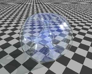

I did play with increasing the max_trace_level variable.  The last
render was done with max_trace_level set to 50.

Yes , yours was the image.  Thank you for posting it.  I enjoyed seeing it
and trying to create something similar.
This was my first atempt at creating a macro so I'm sure there are many
things that can be improved.  Please give me your suggestions so that I can
learn.  :-)
In the mean time I will try what you suggest regarding the slightly bigger
cone for intersecting with the tori, so that they overlap the cut out
spheres a bit.

Note that intersection {} and difference {} are closely related.
I.e. this expression:
difference {
  object { Shape1 }
  object { Shape2 }
- can be rewritten as
intersection {
  object { Shape1 }
  object { Shape2 inverse }
And further:
intersection {
  difference {
    object { Shape1 }
    object { Shape2 }
  object { Shape3 }
- as:
intersection {
  object { Shape1 }
  object { Shape3 }
But IIRC there are some differences with regards to
automatic bounding. (But I don't remember exactly what.)
7)
It is my opinion that unless it makes things a lot simpler,
then you should avoid putting texturing and interior expressions
inside macros that genrates shapes.
E.g.: Your "material { Crystal }" statement inside your macro
8)
With POV-Ray versions 3.1 and later it should not ever
be necessary to enclose single variable names in brackets.
E.g.: (hole)
9)
Try to use more descriptive variable names.
(Yes, I know; it can sometimes be very hard to find good names.)
Below is my suggestion for a complete rewrite of your macro.
Tor Olav
#macro MakeThingy(Ra, Rb, Thickness, Rhole)
  #local Rdiff = Ra - Rb;
  #local Rmaj = Rb + Rhole;
  #local RminO = Rb;
  #local RminI = RminO - Thickness;
  #local ROO = Ra;
  #local ROI = ROO - Thickness;
  #local RII = Ra - 2*Rb;
  #local RIO = RII + Thickness;
  #local Hcone = Ra + 1;
  #local Rcone = Hcone*tan(asin(Rmaj/Rdiff));
  #local vUp = sqrt(Rdiff*Rdiff - Rmaj*Rmaj)*y;
  #local Angle = degrees(acos(-sqrt(1/3)));
  #local Nil = Ra*1e-6;
  #local OuterSphere_OuterSurface = sphere { 0*y, ROO }
  #local OuterSphere_InnerSurface = sphere { 0*y, ROI }
  #local InnerSphere_OuterSurface = sphere { 0*y, RIO }
  #local InnerSphere_InnerSurface = sphere { 0*y, RII }
  #local Torus_OuterSurface = torus { Rmaj, RminO translate vUp }
  #local Torus_InnerSurface = torus { Rmaj, RminI translate vUp }
  #local CutCone = cone { 0*y, 0, Hcone*y, Rcone }
  #local CutConeSmaller = cone { 0*y, 0, Hcone*y, Rcone - Nil }
  #local Trans0 = transform { }
  #local Trans1 = transform { rotate -Angle*z rotate  30*y }
  #local Trans2 = transform { rotate -Angle*z rotate 150*y }
  #local Trans3 = transform { rotate -Angle*z rotate 270*y }
  #local Spoke =
    intersection {
      difference {
        object { Torus_OuterSurface }
        object { Torus_InnerSurface }
      object { CutCone }
  #local CutCones =
    union {
      object { CutConeSmaller transform { Trans0 } }
      object { CutConeSmaller transform { Trans1 } }
      object { CutConeSmaller transform { Trans2 } }
      object { CutConeSmaller transform { Trans3 } }
  merge {
    difference {
      object { OuterSphere_OuterSurface }
      object { OuterSphere_InnerSurface }
      object { CutCones }
    difference {
      object { InnerSphere_OuterSurface }
      object { InnerSphere_InnerSurface }
      object { CutCones }
    object { Spoke transform { Trans0 } }
    object { Spoke transform { Trans1 } }
    object { Spoke transform { Trans2 } }
    object { Spoke transform { Trans3 } }
#end // macro MakeThingy
object {
  MakeThingy(1000, 350, 10,100)
//  rotate 120*y
//  rotate degrees(acos(-sqrt(1/3)))*z

From: Sun Tzu
Subject: Re: Problem with 'seams' in merge.
Date: 20 May 2003 19:03:50
Message: <3ecab456@news.povray.org>
Thank you for your many suggestions!  I tried the bigger cone as you
suggested and it worked perfectly.
Download 'thingy2.jpg' (332 KB)

You are probably thinking of problems with mapping of
rectangular images onto spheres, while the problem with
his sphere was that it had tiny gaps (caused by roundoff
errors) between the CSG parts that forms his shape.
Tor Olav
