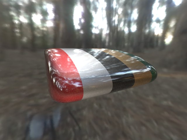

For anyone who hasn't been following the other thread: I can't illuminate my
metallic paint using only radiosity, as it relies on specular highlights, which
meant I couldn't light it using HDR...
...but now I've found a way round it: Here the object is lit by a set of light
sources distributed round a sphere, with their colours sampled from the HDR
image. It's very effective and it means I can just change the HDR and it looks
right. I've not used radiosity, but I guess to combine this with radiosity you'd
need to turn off the HDR sky sphere and save the radiosity, then turn it back on
for the final render, otherwise the light sources will combine with radiosity
from the sky sphere and cause twice the illumination in the scene.
Anyway, the pictures show the paint in a variety of HDR environments, and the
beach and campus pictures are using a much more metallic type of paint (90%
metallic, compared to 60% in the other pictures).
The metallic paint is the same code used for the other picture, which is on
p.b.s-f. I can provide the source code for the light dome trick if anyone wants
it, but it's pretty straighforwards and my version is a little messy.
You like? :)

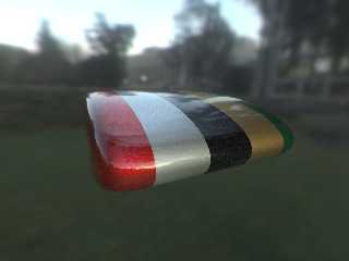

I discovered HDR looks a *lot* better with assumed_gamma 1, so I've rendered a
few more versions. With this gamma setting there's not so much saturation on the
bright points, so we can have light and dark things in the same scene more
realistically.
Tek

From: JWV
Subject: Re: Metallic paint - HDR renders
Date: 16 May 2003 03:35:47
Message: <3ec494d3@news.povray.org>
I think you should leave out the glitter on the black part of the object.
news:3ec40598@news.povray.org...

From: Tek
Date: 16 May 2003 13:35:56
Message: <3ec5217c$1@news.povray.org>
"JWV" <jwv|at|planet.nl> wrote in message news:3ec494d3@news.povray.org...
I agree, that occured because I created the glitter effect with only one light
source, but now it's surrounded by a dome of lights the glitter appears all over
the surface. It should be possible to refine it without making it look less
glittery.
Tek

From: Tek
Date: 16 May 2003 17:09:34
Message: <3ec5538e$1@news.povray.org>
The backgrounds are HDR (high dynamic range) photos from Paul Debevec's site:
http://www.debevec.org/Probes/
They're rendered using MLpov, a modified version of POV3.5 which has support for
HDR: http://pov.monde.free.fr/mael/mlpov081eng.html
I started using HDR just the other day, but it's taken me only a couple of
evenings to get these kinds of results.
Tek
> light
> HDR
> looks
> you'd
> back on
> radiosity
> the
> (90%
> on
> wants
> > You like? :)
> > Tek
> > http://www.evilsuperbrain.com
From: Tek
Date: 16 May 2003 17:13:05
Message: <3ec55461@news.povray.org>
Here's a much improved glitter effect, you can see that it only occurs near the
reflections of bright objects, and is the colour of those objects.
For anyone who's curious, I've acheived this effect using a dome of 50
lightsources sampled from teh HDR image, with a higher probability of
lightsources occuring in the brightest areas of the dome (otherwise I need about
300 to get a similar result).
Tek

From: Tek
Date: 16 May 2003 17:31:20
Message: <3ec558a8@news.povray.org>
Hold on, did you mean the black part or the dark part? I thought you meant the
dark part, i.e. the bit in shadow, but I just realised maybe you mean the bit
that's painted black! Doh! Sorry I should pay more attention :)
Tek

From: JWV
Date: 17 May 2003 04:00:35
Message: <3ec5ec23@news.povray.org>
i meant the part wich is painted black :-).

From: Tek
Date: 17 May 2003 07:38:08
Message: <3ec61f20$1@news.povray.org>
"JWV" <jwv|at|planet.nl> wrote in message news:3ec5ec23@news.povray.org...
Doh! Well I agree that metallic black looks wierd, but I did it because it was
requested. Anyway your suggestion made me realise that the glitter didn't seem
to be related to the lighting in the right way, and that's prompted me to make
it even better so thank you anyway :)
Tek

From: Lenx
Date: 17 May 2003 14:05:59
Message: <3ec67a07$1@news.povray.org>
thank you!
