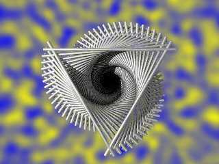

Try as I might, I *cannot* get this to look metallic... *sighs* Tried
playing with lighting, tried playing with different backgrounds, but I can't
make it look shiny, and I can't make it look reflective!
Any suggestions? (I'm looking for a very highly-polished, very brilliant
look.)
Thanks.
Andrew.

From: Ib Rasmussen
Subject: Re: Non-metal
Date: 22 Apr 2003 14:39:17
Message: <3EA58CB4.2060803@ibras.dk>
> look.)
Have you tried any of the chromes or silvers from the standard includes?
Remember that metals need somthing to reflect, to look metallic.
/Ib
From: Tek
Date: 22 Apr 2003 14:58:36
Message: <3ea590dc@news.povray.org>
I had the same trouble the other day, but eventually got something I liked.
A few tips:
-make sure you've got a light source in a position where it will reflect, and
use a specular or phong highlight
-make it slightly reflective
-use a high brilliance value, I find a brilliance of 2 looks pretty good.
-try using "metallic" reflections and highlights, that sometimes helps (though
sometimes it looks totally wrong).
Tek

From: Slime
Date: 22 Apr 2003 15:02:19
Message: <3ea591bb@news.povray.org>
> look.)
Try making the pigment darker and maybe the reflections brighter, so that it
relies more on reflected than diffused light.
Maybe try making the highlights sharper, also.
 - Slime
[ http://www.slimeland.com/ ]
From: Andrew Coppin
Date: 22 Apr 2003 15:56:01
Message: <3ea59e51@news.povray.org>
Nope, not yet. I could do I suppose...
That's the purpose of the daft blue/yellow background. Doesn't seem to help
much though... (Maybe it just needs more contrast, IDK)
Thanks.
Andrew.
From: Andrew Coppin
Date: 22 Apr 2003 15:59:37
Message: <3ea59f29@news.povray.org>
liked.
> A few tips:
and
It already has 80% specular highlight. Lighting might well need something
doing to it though...
Already has constant 80% reflection. (Haven't tried variable reflection -
won't make much difference for such tiny objects.)
Brilliance is currently at 3. (Also roughness = 0.005.)
(though
Already switched on. (Of course, all that actually does is make the specular
highlights match the colour of the object; since these are WHITE anyway,
theoritically it won't make any difference.)
Thanks anyway.
Andrew.
From: Andrew Coppin
Date: 22 Apr 2003 16:01:34
Message: <3ea59f9e$1@news.povray.org>
it
Yeah, that was my thinking... Tried it with no diffuse at all, but looked
like it was metal painted black or something... (Ooo, but maybe I should
turn off the "metallic" keyword - it's probably trying to give me black
highlights |-)
Yes, I think I agree with you there... Already tried fiddling with roughness
and brilliance, so maybe I need to move the light source around or
something...
Thanks.
Andrew.
From: Tek
Date: 22 Apr 2003 16:15:04
Message: <3ea5a2c8$1@news.povray.org>
Well another idea is put a horizon line in the reflection, make the ground dark
and the sky bright.
If it's in an unrealistic setting it will tend to look unrealistic.
Tek

From: Andrew Coppin
Date: 22 Apr 2003 16:48:37
Message: <3ea5aaa5@news.povray.org>
dark
> and the sky bright.
Hey, that could would... Yes, that's how artists always seem to do it when
they paint by hand... [Sees visions of chrome bikes...]
Scientifically-correct and realistic appearence are two related but SEPERATE
concepts ;-)
Thanks for the hint!
Andrew.
From: Xilo Musimene
Date: 22 Apr 2003 19:33:40
Message: <3EA54425.4020500@hotpop.com>
> look.)
The best reflection I got with metals, was with a very highly scaled
black and white checker plane behind the camera.
(Black and white, makes the reflection extremely sharp and nice)

From: Patrick Dugan
Date: 22 Apr 2003 21:45:54
Message: <3ea5f052@news.povray.org>
As the others said you need something to reflect but it needs to be *behind*
the camera too.
Preferably all the way around the scene will help.  Have you tried creating
an HDRI image?

From: Txemi Jendrix
Subject: RE: Non-metal
Date: 22 Apr 2003 22:12:21
Message: <3ea5f685$1@news.povray.org>
Andrew Coppin <orp### [at] btinternetcom> escribió en el mensaje de noticias
3ea584f1@news.povray.org...
can't
> look.)
I once tried a trick that was as it follows.
You have to create a box that contains the object
(double the size of the model is OK).
Give it a pigment in black and white (use bozo or
agate).
Make it hollow and set it to no_image and no_shadow.
Scale the pigment to obtain the kind of reflection you want in your
object.
The problem with reflections in POVRay is that you need
"something" to be reflected.
HDRI is other good option (much better than mine).
Hope this helps.

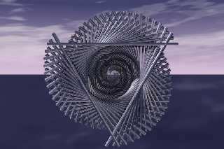

From: Ib Rasmussen
Date: 23 Apr 2003 09:26:37
Message: <3EA694E9.80307@ibras.dk>
 > to help much though... (Maybe it just needs more contrast, IDK)
Then it must be your texture. I have tried reproducing your scene with a
standard sky_sphere(S_Cloud1) and a standard T_Chrome_3E (ambient 0
diffuse 1) and a single pointlight as light source. Looks quite metallic
to me.
/Ib

From: Andrew Coppin
Date: 23 Apr 2003 14:01:52
Message: <3ea6d510$1@news.povray.org>
*behind*
> the camera too.
creating
> an HDRI image?
The background is actually a very large hollow sphere that contains the
entire scene (including the camera). So yes, it *does* continue behind the
camera.
Thanks.
Andrew.
From: Andrew Coppin
Date: 23 Apr 2003 14:04:05
Message: <3ea6d595$1@news.povray.org>
> to me.
Mmm... I don't know if that's quite the look I was after, but it certainly
DOES look much more metallic... I think I'll have a go at adding a horison
> look.)
> Thanks.
> Andrew.
You made me try to create a metall texture, here is what I came up with,
perhaps it can give you some ideas.
camera{
location <0.5,0.5,-1>
look_at 0.5
#declare metall=texture{
pigment{rgb <0.5,0.7,1>}
finish{
ambient 0 diffuse 0.3 brilliance 4
specular 0.9 roughness 0.01 metallic 1.3
reflection{0.7,1 exponent 0.9 falloff 2 metallic 0.9}
irid{0.1 thickness 0.7 turbulence 0.2}
union{
#declare R=seed(41056);
#local Z=0;
#while (Z<80)
cylinder{<rand(R),rand(R),rand(R)><rand(R),rand(R),rand(R)>,rand(R)/30}
#local Z=Z+1;
#end
texture{metall}
light_source{<2,1,-1.5>*1e3 rgb 2}
sky_sphere{pigment{agate scale 2}}
From: Xplo Eristotle
Date: 25 Apr 2003 15:26:23
Message: <3ea98bdf@news.povray.org>
> look.)
Here's some general tips:
In general, the base color for a silvery metal should be sort of a
medium-dark gray. Iron might be a bit darker; aluminum a bit brighter.
The amount of reflection is up to you; for really shiny metal, use .5 or
more, but less than 1 (you said you're using .8, which is fine, if
slightly high; remember that 1 would be a physically perfect reflection,
which even mirrors don't quite achieve). This should be constant
reflection, not variable. If you use a metallic reflection, you may need
to increase the amount of reflection to compensate for multiplication by
the pigment. Depending on how dark your base color is, this can result
in using base reflection values above 1.
The highlight should be strong, and fairly tight, but not super-tight;
remember that you're not trying to reflect a point light (which is
impossible, of course, since a point light has no volume), you're trying
to simulate the reflection of a light which does have volume. For best
results, set up your scene such that highlights appear brighter than
reflections of light-colored objects, since light sources typically
appear much brighter than the things they illuminate. (If monitors were
somehow capable of displaying values greater than rgb 1, this wouldn't
be an issue, but they aren't.)
Because shiny metal doesn't diffuse light as much as, say, a rubber
ball, you'll need to reduce the amount of diffuse light coming from the
object. This can be done in one of two ways: increasing brilliance
(which will make parts of the object that should be reflecting most of
their light away from the viewer appear darker) or reducing diffuse
(which will make the whole thing darker, as though you'd used a darker
base color). Increasing brilliance is probably more physically
realistic, but I find that reducing diffuse, or employing a combination
of both, produces a better looking metal IMO.
Finally, shiny metals derive much of their apparent reflectivity (as our
eyes perceive it) from high-contrast environments. To put it another
way, for something to look reflective, it should have a lot of dark bits
and bright glinty bits. Instead of the environment you're using now, try
using a sky and horizon, or put your object in a scene with brightly-lit
areas and strong shadows, or something similar.
-Xplo
From: Andrew Coppin
Date: 26 Apr 2003 03:56:35
Message: <3eaa3bb3$1@news.povray.org>
Thanks for this reply. Well thought-out and nicely worded.
It's been a busy busy week for me, but now the weekend is here, so I might
*finally* get to try some things... I'm particularly interested to see what
adding a "horison" will do - I'm hoping this might be my magic bullet, but
we'll see. ;-)
Thanks.
Andrew.
