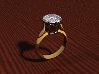

Right - 'Cushion' or 'Octagonal' shape.
 Left - 'Pear' shape.
 Bottom - 'Star-cut' or Pentagon shape.
Photons are on, where's the pretties??  :(
   ~Steve~
Download 'diam.jpg' (83 KB)
Preview of image 'diam.jpg'
From: Andrew
Subject: Re: Lucy in the sky with diamonds...
Date: 14 Mar 2003 14:32:35
Message: <3e722e53$1@news.povray.org>
You're using the correct IOR for diamond, right?  I don't have access to
any real diamonds to test this (oddly enough), but I don't think they
show much in the way of caustics.  A quick test with pov seems to
confirm this - try rendering the example scene straight from the Insert
menu, then try it again with an IOR of 2.47.  The bright spots on the
ground certainly don't look so neat.
Also, (I might just be making this up here) I think that the diamond
cuts are designed to reflect light back out towards the "user" :)  In
other words, all the sparkle comes straight back at you when you look at
them set in a ring, hence their sparkly appeal.
On a seperate note, where did you get the geometry?  And are they meshes
or CSG?  I've only ever found CSG versions of povray diamonds, and I
didn't have much luck turning up a geometrical description of a cut
detailed enough to make a mesh from when I searched.
From: St
Date: 14 Mar 2003 15:27:05
Message: <3e723b19@news.povray.org>
"Andrew" <ast### [at] hotmailcom> wrote in message
news:3e722e53$1@news.povray.org...
access to
they
Insert
the
    Hiya Andy, are you seeing something different to me then? The only
bright spots I see are the reflections from the table surface. I'm
using most of Jurgen Sharfys' code and his IOR is 2.41.
    I'll give 2.47 a try.
  My caustics are low at the moment, I'm using .3 - I tried higher but
I thought the stones looked TOO colourful.
In
look at
      You might be right with this image. I turned reflection off.
      Should I try turning refraction off and reflection on then? What
do you think? This image took around 1.5 hours at 640x480 aa 0.3, and
then I cut it a little.
meshes
   'Ere guvnor... wanna know a secret?  ;)  They're meshes. Have you
got a prog that can convert .dxf files to .pov? I used freeby Rhino.
Go here: www.gemcad.com (free 30 day trial), save as a .dxf, and then
open (whatever prog), and convert to a.pov file. The great thing with
gemcad is that you can alter the amount of facets you might want with
a click (I don't work for them!) - although I haven't tried this in
this image.
Have a play, it's fun. Looking forward to seeing something better than
mine (which won't be difficult!!)
   ~Steve~
From: Andrew
Date: 14 Mar 2003 15:37:55
Message: <3e723da3@news.povray.org>
> access to
> they
> Insert
> the
Sorry - I think you've misunderstood me here, probably because I didn't
make
myself very clear to start with :)
What I mean to say was:  Open Pov, create a new file, use the menu item
Insert >> Scene templates >> Photons scene.  First render it straight
away.
Then change the ior of the glass to 2.47 (or whatever diamond really is)
and
re-render.  You'll see that the bright spots on the ground are no longer
bright.  This could be the problem with your diamonds.  Have you tried
setting the ior to 1.5 or so, just to see what a glass "fake" would look
like?
Thanks for the heads-up on gemcad - sounds useful.  Very useful in fact!

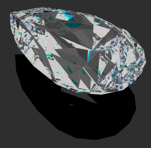

From: Apache
Date: 14 Mar 2003 17:28:32
Message: <3e725790@news.povray.org>
Check this pic, I did it a week ago with the pear shape and it completely
sucks. Among other things, something went completely wrong with the
dispersion and I just couldn't get it working. And I decided to forget about
the thing anyways.

From: Apache
Date: 14 Mar 2003 17:32:41
Message: <3e725889@news.povray.org>
If you want diamonds to look like diamonds do and if you also want to use
the right shapes, your IOR should be set to the diamond's.
And for those interested in more info and dxf files, go to
http://www.3dlapidary.com/
From: Greg Edwards
Date: 14 Mar 2003 22:05:12
Message: <16xu93graq0aq.kik255m9clkv$.dlg@40tude.net>
> the thing anyways.
You're getting those little cyan spots too? WHat OS did you render this
under? It seems like some sort of a bug in the windows compile of POV. By
downloading the source and re-compiling POV under VC++ I could fix this bug
(no changes to the source). I made a post to p.p a little while ago about
this.

From: St
Subject: HOT HOVERIN' ROCK! ;)
Date: 15 Mar 2003 18:03:17
Message: <3e73b135@news.povray.org>
news:3e723da3@news.povray.org...
is)
> and
longer
tried
look
> like?
      Yes, tried that last night, and you were right, the bright spots
disappeared, but the diamonds looked more like Blue Topaz than
diamonds, but REALLY GOOD Blue Topaz!! (Because of my blue sky_sphere)
   (Note to self: must remember this!)
fact!
   My pleasure, "Anything to help anyone" would be my motto of choice.
   So, what do you reckon to the attached now?
   With this image, I stayed with IOR 2.41 in the end.
      ~Steve~
Download 'h-d.jpg' (187 KB)
Preview of image 'h-d.jpg'
From: Andrew
Subject: Re: HOT HOVERIN' ROCK! ;)
Date: 16 Mar 2003 07:47:55
Message: <3e74727b@news.povray.org>
Now that's looking pretty good!  I'm going to have to try some gemstones
out myself...
From: St
Date: 17 Mar 2003 13:46:26
Message: <3e761802@news.povray.org>
news:3e74727b@news.povray.org...
gemstones
> out myself...
    Thanks! I'm not too happy with those blotches next to the sharp
edges (at the bottom), of the shank though. I'm not sure if it's a
sPatch thing or a texture thing at the moment...
   I'm going to try a ring with either eight or ten diamonds next,
surrounding an oval sapphire, or perhaps an emerald. I'll see if I can
put it in a pseudo velvet-lined ringbox too. That should be fun!  ;)
 Yes, give it a go, there's a sort of nice feeling being able to
produce a diamond that's FREE!
     (...and you can make it as big as you want!)    :)
      ~Steve~
From: Apache
Date: 17 Mar 2003 15:39:00
Message: <3e763264$1@news.povray.org>
I'm running win2k server here on a celeron 400 box with 128 mb ram.

From: Marc Champagne
Subject: Re: Lucy in the sky with diamonds... - 2 attachments - 2 attachments
Date: 22 Mar 2003 23:41:33
Message: <Xns9346F09E74628POVMIKA@204.213.191.226>
"Halbert" <hal### [at] compudrivelcom> wrote in
news:3e7ca4c6$1@news.povray.org:
> I don't think most of the poeple in here can viewYEnc encoded
> attachments (my self included. ) But we would like to see it.:-)
Isn't Yenc a defacto standard?....
Here goes as regular attachement
(MIKA) Marc Champagne
marcch.AT.videotron.DOT.ca
Montreal, CANADA
Download 'diamond.jpeg75.jpg' (31 KB) Download 'diamond.jpg' (34 KB)
Preview of image 'diamond.jpeg75.jpg'
Preview of image 'diamond.jpg'
From: Ken

From: Greg Edwards
Date: 23 Mar 2003 20:50:40
Message: <fkmohz19sqxg.17e1ul72c2uzr.dlg@40tude.net>
On 21 Mar 2003 23:41:22 -0500, Marc Champagne wrote:
> "St." <dot### [at] dotcom> wrote in news:3e722881@news.povray.org:
> Looking good, here are some I made a while back...
Wow! Did you happen to sneak into my PC and steal my patch? ;-) How'd you
avoid the dispersion bug anyway?
light_source#macro G(E)sphere{z+E*y*5e-3.04rotate-z*E*6pigment{rgbt#end{
20*y-10#local n=162;1}#while(n)#local n=n-.3;G(n)x}}G(-n).7}}#end//GregE
Date: 24 Mar 2003 00:12:50
Message: <Xns93481CC23658POVMIKA@204.213.191.226>
Greg Edwards <edw### [at] hotmailcomremovethis> wrote in
news:fkm### [at] 40tudenet:
> you avoid the dispersion bug anyway?
I didn't... I never got it :)
T'was not a patch but plain old manual CSG construction and a lot of
research into the art of diamond cutting and properties.
What one would do if it were not for the internet and it's chest-full of
information.
Montreal, CANADA
From: Michael Goldshteyn
Date: 24 Mar 2003 16:03:05
Message: <3e7f7289@news.povray.org>
Sure would like to see the source to the three diamonds side by side, could
you post it please?
Thanks,
Mike
Date: 24 Mar 2003 19:32:50
Message: <Xns9348C6796E858POVMIKA@204.213.191.226>
"Michael Goldshteyn" <mgo### [at] n-o-s-p-a-m-earthlinknet> wrote in
news:3e7f7289@news.povray.org:
> could you post it please?
Check out p.t.c.f, subject: Mika Diamond
Montreal, CANADA
Date: 25 Mar 2003 15:17:49
Message: <3e80b96d$1@news.povray.org>
Wow, I just checked it out and it's beautiful. I was going to try increasing
the max_trace_level, but it's already at 60!
Any other parameters I can increase for more accuracy/beauty at the expense
of render time?
"Marc Champagne" <nos### [at] pleasecom> wrote in message
Date: 25 Mar 2003 15:47:13
Message: <3e80c051$1@news.povray.org>
OK, I just raised the max_trace_level on that scene to 100 and am rendering
it at 2048x1536 (no AA), and it's already amazing. This scene is a definite
candidate for playing with 48-bit color in Photoshop...
I'll post any good images I come up with..
Date: 25 Mar 2003 18:32:13
Message: <Xns9349BC33BC958POVMIKA@204.213.191.226>
news:3e80b96d$1@news.povray.org:
> increasing the max_trace_level, but it's already at 60!
> expense of render time?
I would say let yourself loose and fiddle with the paramaters...
Montreal, CANADA
