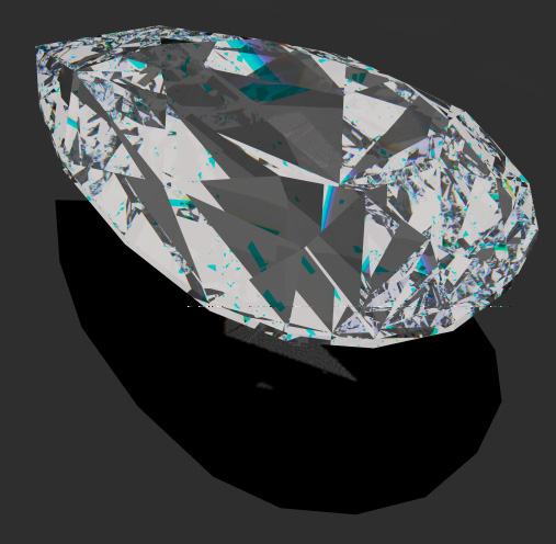

Check this pic, I did it a week ago with the pear shape and it completely
sucks. Among other things, something went completely wrong with the
dispersion and I just couldn't get it working. And I decided to forget about
the thing anyways.

From: Greg Edwards
Subject: Re: Lucy in the sky with diamonds...
Date: 14 Mar 2003 22:05:12
Message: <16xu93graq0aq.kik255m9clkv$.dlg@40tude.net>
> the thing anyways.
You're getting those little cyan spots too? WHat OS did you render this
under? It seems like some sort of a bug in the windows compile of POV. By
downloading the source and re-compiling POV under VC++ I could fix this bug
(no changes to the source). I made a post to p.p a little while ago about
this.

From: Apache
Date: 17 Mar 2003 15:39:00
Message: <3e763264$1@news.povray.org>
I'm running win2k server here on a celeron 400 box with 128 mb ram.

From: Ken
Subject: Re: Lucy in the sky with diamonds... - 2 attachments - 2 attachments
Date: 23 Mar 2003 00:24:49
Message: <3E7D4603.42430B45@pacbell.net>
Marc Champagne wrote:
> "Halbert" <hal### [at] compudrivelcom> wrote in
> news:3e7ca4c6$1@news.povray.org:
> > I don't think most of the poeple in here can viewYEnc encoded
> > attachments (my self included. ) But we would like to see it.:-)
> Isn't Yenc a defacto standard?....
No, it is not. The most used news readers in these groups have no internal
support for that encoding format.
> Here goes as regular attachement
Pretty.
Ken Tyler

Wow! Did you happen to sneak into my PC and steal my patch? ;-) How'd you
avoid the dispersion bug anyway?
light_source#macro G(E)sphere{z+E*y*5e-3.04rotate-z*E*6pigment{rgbt#end{
20*y-10#local n=162;1}#while(n)#local n=n-.3;G(n)x}}G(-n).7}}#end//GregE
From: Marc Champagne
Date: 24 Mar 2003 00:12:50
Message: <Xns93481CC23658POVMIKA@204.213.191.226>
Greg Edwards <edw### [at] hotmailcomremovethis> wrote in
news:fkm### [at] 40tudenet:
> you avoid the dispersion bug anyway?
I didn't... I never got it :)
T'was not a patch but plain old manual CSG construction and a lot of
research into the art of diamond cutting and properties.
What one would do if it were not for the internet and it's chest-full of
information.
