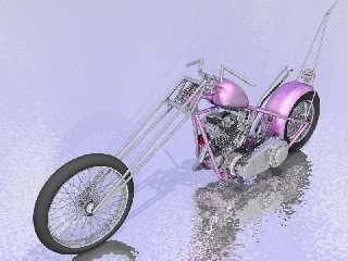

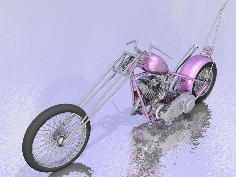

Hi guys, I'm trying to create a Metalflake finish in Pov-ray. Back in the
seventies it was a popular type of paint, using a very rough metallic flake
basecoat, under a smooth glossy transparant coloured paint. The texture I
used in this pic is:
texture { pigment { color red 0.200 green 0.000 blue 0.200 }finish{phong 2
roughness .05 specular 2 metallic .9 reflection .3} normal {bumps .3}}
it looks okay for the basecoat but needs a smooth glossy top layer.... Has
anyone got some tips or ideas how to improve this?
Mark van der Kwaak
www.dbbp.com
Download 'cb18_lv.jpg' (93 KB)
Preview of image 'cb18_lv.jpg'

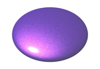

is putting a "real" outside coating around the metal parts out of the
question? i got this effect with this code, but it made the paint look more
blue. making a layered texture, i couldn't quite get it to look like this.
but i didn't spend much time.
#declare layered_paint_1 =
texture
        pigment
                rgb <0.200, 0.000, 0.200>
        finish{
               phong 2
               phong_size 10
               roughness .05
               specular 2
               metallic .9
               reflection .3
        normal {bumps .3}
sphere {
        <0, 5, 0>,5
        scale <1, .2, 1>
        texture {layered_paint_1 scale .01}
sphere {
        <0, 5.05, 0>, 5.05
        scale <1, .2, 1>
        texture {
        pigment {
                rgbt <.9, .9, 9, .95>
        finish {
                phong .75
                phong_size 130
                specular 1
                roughness .001
Download 'circle.jpg' (21 KB)
Preview of image 'circle.jpg'
From: Duckman
Subject: Re: Metalflake Motorcycle
Date: 6 Mar 2003 16:04:00
Message: <3e67b7c0$1@news.povray.org>
"Ross Litscher" <lit### [at] osuedu> wrote in message
news:3e67a510@news.povray.org...
> Duckman <duc### [at] wxsnl> wrote in message news:3e67977c@news.povray.org...
the
> flake
I
2
Has
> > Mark van der Kwaak
> > www.dbbp.com
more
> texture
>         pigment
>         finish{
>                phong 2
>                phong_size 10
>                roughness .05
>                specular 2
>                metallic .9
>                reflection .3
>         normal {bumps .3}
> sphere {
>         <0, 5, 0>,5
>         scale <1, .2, 1>
> sphere {
>         <0, 5.05, 0>, 5.05
>         scale <1, .2, 1>
>         texture {
>         pigment {
>         finish {
>                 phong .75
>                 phong_size 130
>                 specular 1
>                 roughness .001
Well, I thought of that but it would be a hell of a job....
there must be an easier way!
From: Hugo Asm
Date: 6 Mar 2003 17:55:12
Message: <3e67d1d0$1@news.povray.org>
It's not a surprise that it's more blue when you do this. :o)
A layered texture is the answer.
Hugo
From: Ross Litscher
Date: 6 Mar 2003 18:26:08
Message: <3e67d910@news.povray.org>
w00t!
lousy mistakes!
Hugo Asm <hua### [at] post3teledk> wrote in message
news:3e67d1d0$1@news.povray.org...
> Regards,
> Hugo

From: Xplo Eristotle
Date: 7 Mar 2003 13:16:24
Message: <3e68e1f8@news.povray.org>
Glossy top layer = transparent pigment, no normal, tight specular
highlight, fresnel variable reflection. Remember to give the object an
interior {} with an ior for the fresnel reflection.
-Xplo

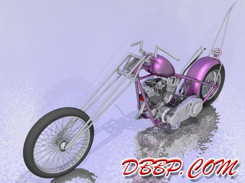

From: Duckman
Date: 7 Mar 2003 16:57:03
Message: <3e6915af@news.povray.org>
Thanks for all the input, this is what I came up with using the comments and
suggestions I received:
#declare metalflake3 =
texture { pigment {  rgb <.2, .0, .2> } finish { phong 2 phong_size 10
roughness .1 specular 2 metallic .9 reflection .3} normal {bumps .5} }
texture { pigment {  rgbt <.2, .0, .2, .95>     } finish { phong 1
phong_size 130 roughness .001 specular 1 reflection .2 }}
I started with almost clear top layers but the colour became too light,
after about 10 attempts this one was the best sofar......
What do you think?
"Duckman" <duc### [at] wxsnl> wrote in message news:3e67977c@news.povray.org...
flake
> Mark van der Kwaak
> www.dbbp.com
Download 'cb18_lv_04.jpg' (74 KB)
Preview of image 'cb18_lv_04.jpg'
From: Duckman
Date: 7 Mar 2003 16:57:12
Message: <3e6915b8@news.povray.org>
What do you think?
flake
> Mark van der Kwaak
> www.dbbp.com
