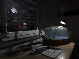

So, this is the latest installment of my Worldbowl
Improvements.
Now, the room is lit mostly by Radiosity, with
the rad-light coming mainly from the spotlight of
the worldbowl.
Then there are some photons in the shadow of the
vase, but that's rather for realism than actual "visual
effect".
I've added another page to the notebook and
exchanged the pencil with the ink-pen from my
"2 Lonely" image.
The base of the bowl was changed, as was its
texturing.
And you might not notice, but the table now uses
blurred-reflections.
I think I'm gonna lower the effect of the radiosity
somewhat, and perhaps make the pigment on the
table darker, it looks a little muddy, and when lit,
a little too milky. There are stíll some texturing
issues on my to-do list, e.g. the window-frame and
the window-pane. I'm not sure if I should change a
lot about the walls.
Well, comments always appreciated. This last
image took about 24 hours to rendern, the histogramm
image looked really nice: totally black.
I'm thinking about getting some more light shine
through the clouds again, as their shadows are
in stark contrast now. I've become undecided about
the lighthouse again, though I might model some small
scale trees and plant them on the heightfield.
Ah well, this image needs some more tweaking, but
then I'll put it to rest for a while and do some other,
new stuff, to get detached again, in order to come back
with new and clean thoughts...
Well, enjoy!
Tim

Excellent.
The table, if that's wood, looks a little too shiney for how desaturated it
is. If the wood had that much of a finish, I'd expect it to be darker
colored.
The only other thing I notice is that the cloud shadows are too sharp; you
should use an area light.
 - Slime
[ http://www.slimeland.com/ ]

Interesting, as always, to follow the evolution of a scene. I was
particularly interested in your media approach to the clouds in the bowl,
since I like to play around with atmospherics alot in Pov.
I feel compelled to voice a few criticisms on the image, especially, since
it is clearly advancing to a higher level.
Regarding the world bowl: while it is an interesting and unusual object, I
am not compelled to _care_ about what it is doing in the image the same way
I am compelled by the flower or the moon. It needs to have something that
emotionally draws me to it.
Regarding the flower: after looking at it for a while, I wondered if it was
actually a kind of flower that would close at night. Should it?
Regarding the writing on the pad: it is stretching suspension of disbelief a
little too far to accept that the writing was done by the pen. An image map
of a your own hand-writing perhaps?
Finally, regarding the outdoors: I like the (almost hyper) realistic moon,
but should it be just a little focul blurred to keep me, the viewer, inside
the room? I don't really know how I would feel about that. However, as you
mentioned yourself, those clouds around the moon do need to be corrected.
The distant clouds are ok, but where the clouds are close to the moon and
thin, there needs to be some strong appearence of forward scattering in the
cloud.
Ok, now I'll take of my art critic hat now.
Abe

"Slime" <slm### [at] slimelandcom> wrote in message
news:3e596f69$1@news.povray.org...
Yes, softer shadows... however then it disrupts the idea of a sunlight being
shone on the surroundings. Not sure if it would be possible to get both
effects. There's little doubt that the lamp should be causing some softer
shadows.

I would loose the moon, and replace it with a dim fuzzy desk lamp, suitable
enough so people will only notice it on second glance - worldbowl within a
worldbowl
inside
the
> cloud.
I agree.  Assuming that a "camera" snapped this shot, there is too much too
close in the foreground for the moon to be so tightly focused.
Focal Blur + Area Light for the final render. Then watch your render time
move from 24 hours to something you measure in days.
For the most part, it's really looking great now, though!  Good job!
Slash

Yeah, it's only interesting as a recursion thing.   So make the moon more
desklamp like or the desk lamp more moonlike...
news:3e59998e$1@news.povray.org...
suitable
> worldbowl
I agree with Abe, i more or less feel the need to have something
living in the bowl. Some birds, men or dolphins would add to the scene.
Only from then texture of the rock i think you aim for a rock of the
order of 1 km high or so. That would exclude any living organisms.
on such a scale only a village would be visible. And if at night
possibly some ribbon of light by the roads. Then again from the lighting
it is not clear if you aim for a day or a night view.
Anyway I like it very much.
	Andrel

@Slime and @hughes
I know, softer shadows... Area-light is kinda tracing intensive
when used with media, so since this was just one complete run
to check if everything still holds together, I didn't use it. Of course
it'll be used for the real final image, and if it takes a month
to trace!
As for the table, I'm not really satisfied yet. If I make it
much darker, it might break the color-composition of the
original image, and I tend to make small steps towards
changes. But I agree, a little darker might be a good
step.
Thanks for the comments, and thanks for the praise!
Tim
> to trace!
Be sure to use light_groups to avoid casting an area light on the scattering
media. Use a point light for the scattering media, and an area light for
solid surfaces.
 - Slime
>Improvements.
It looks great.
I think real paper would shine more, even with this dim light. Also if you
made it translucent, well, that'd be great. It'd look even better if you
wrote the notes on the notebook by yourself (you could scan your writing or
just use a tablet). The overall scene looks a bit too clean. You could add
some scratches to the table and things like that.
Keep up the great work.
Jonathan.

I know. I'd lose those nice light-/shadowbeams,
though I've still got to run the arealight through the
media to get the shadows of the clouds. Kinda
difficult, I guess, and probably really intensive to
trace... Got to make some trials, but I'm stuck at the
table for now, and then want to work on the texture
for the window-frame.
Tim Nikias
Email: Tim### [at] gmxde
> solid surfaces.
>  - Slime

@Rick & Greg:
The original scene-file had following lines at the
beginning:
"Sitting lonely at his desk, Nick marvelled at the
complexity of the world he could see in the bowl.
And he wondered, if one can grasp "real life"
at all, if such a tiny environment can't be
fully understood..."
Its about a comparison, not a recursion. But
I might find a way to add a subtle "stick" to

> It looks great.
Thanks!
or
> just use a tablet).
That might be an idea. But unless I want the paper to be see-through, I'd
have to do some more modelling on the pages to get some
subsurface-scattering
like effects. Light should pass through, but you shouldn't be able to see
through. Any ideas?
Thats kinda difficult to do on an already blurred-normal map (averaging
textures), but some other dirt might be in.
I intend to.
