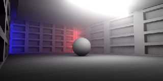

I just stumbled across the fact that glows can be used as lighting in radiosity-only
scenes!
In the attatched image, there are no light sources.. just glows (approx 120 in each
'string').
It does take quite a long time to render (approx 1 hour for this image on a 1Ghz
Athlon).
NOTE: I have post-processed this image to enhance the contrast, as glows can make the
whole
image appear washed out if they're too bright.
Comments welcome.
All the best,
Andy Cocker
Download 'RadiosityStripLightsRoom.jpg' (41 KB)
Preview of image 'RadiosityStripLightsRoom.jpg'

What kind of glows? media or something that megapov offers?

I think he means Megapov's artificial glow, and since it's only a fake
effect, it's something special that it even has an effect on radiosity.

Nice, i have made some experiments with glows and radiosity when they were
first introduced in megapov:
http://www-public.tu-bs.de:8080/~y0013390/pov/pict/glow_test_01.jpg
To avoid brightening the whole scene too much you should modify
'fade_power'.
> 'fade_power'.
Thanks, I shall try that.

Yes, exactly. It was a surprise to me that it worked, but has great potential I think.
You
could easily simulate the 'over-exposed' glare from a window, for example.

Would it not be preferable to face the glows in the direction of the
"light", run the scene and save the radiosity files, and then run the
scene with the glows oriented towards the camera using the saved
radiosity?

I'm not sure what you mean by 'face the glows'. I don't think they work like that...
not like
textured discs if that's what you mean, but hey... I've been wrong before.

IIRC Megapov glows are textured spheres. An orient keyword in the next
glow patch might increase the quality of these types of scenes.
 -Shay

I was thinking of orienting the pigment so that the brightest part of
the glow is on the line between the center of the sphere and the object
on which the radiosity "light" is meant to shine.
 -Shay

A glow is neither a textured sphere nor a disc and it has no orientation.

I can never get enough of glows. But don't forget they're buggy, in their
current implementation. I assume you've had your encounter with this?  I did
one test and immediately got problems. I had nothing but glows in the scene
however, but those in front introduced wrong colors of those in the
background. I suppose this is related to the problem described by
Christopher James Huff, in which he says something about they mess up the
things behind them.
At least sometimes... :o/
