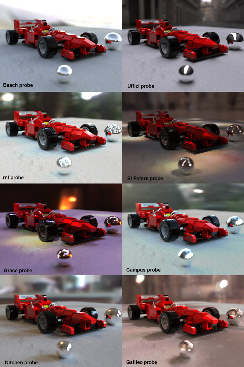

Here are some tests of the HDRI (high dynamic range illumination) patch by
Mael.
The model is the Lego Ferrari by Kenneth Storm (see  the p.b.i thread "Lego
Ferrari" on Sept 2).
The HDR maps are those available at Paul Devebec's site (I put the probes
name for reference) http://www.debevec.org
There's nothing much to it actually : just the HDR map, no lights, same
standard radiosity parameters. There are some visible artefacts in the maps
that have many strong light sources (like the Galileo probe), but the way
the HDR map seems to replace light sources is really amazing (apart the lack
of specular highlights, of course).
I still have to test it on "real" scenes though, where the illumination also
comes from regular objects. I really can't take credit for anything in these
tests ! Before I tested it, I couldn't figure out whether HDRI was really
better than plain radiosity, but it really is.
Important note : the patch is not publicly available yet (there's a Megapov
version somewhere) but I hope that Mael will release it soon.
G.

Wow, those look good!
I might be misunderstanding the technique, but how do you get the coloured light
spots on the ground in the st peters image? I thought an HDR map was just based
on a photo sampled from 1 point in the environment, so your scene shouldn't be
able to get this effect, though it looks much more realistic with it :)

In fact it was a nice surprise to me too ! I didn't expect the light maps to
project light the way they do. It looks like the "hot spots" in the map act
like real lights after all (without creating specular highlights). There are
lots of artefacts here, but more testing (or a different implementation of
HDRI support) could perhaps solve them.
G.

Try painting a probe in photoshop, I found that the resolution did not have
to be very high so long as the parts of the image had natural colors and
the correct density. It may be different on POV, I used 3dMax to do it
about a year ago so the renderers are totally different.
There was one other issue I noted at the time, the HDRI source sphere needs
to be scaled correctly for the lighting to work correctly for small
objects. Try the St Peters probe again with the scale being closer to the
size ratio between that huge building and the tiny toy car.
If my words are not making any sense, tell me and I will draw what I am
thinking.
:o)

From: ingo
Subject: Re: HDRI tests (200 kbu)
Date: 23 Dec 2002 15:33:30
Message: <Xns92EDDC3C2DE23seed7@povray.org>
in news:3e0746c0$1@news.povray.org Gilles Tran wrote:
> Btw, I've tested this feature too. It works, but it's a little
> disappointing ...
I like it a lot, but the results depend a lot on the input material.
Actually, I think it would be more usefull as a little stand-alone
application, instead of a pov-patch.
Ingo

From: John Pallett
Date: 23 Dec 2002 16:18:06
Message: <3e077d8e$1@news.povray.org>
Is there a way to coerce POV-Ray 3.5 into doing this without the patch?
Perhaps a pre-processing step on the HDR image and then the appropriate
radiosity parameters?

From: Daniel Matthews
Date: 23 Dec 2002 17:16:00
Message: <10008403.0EADRmCSq3@3-e.net>
Something more complex than mapping the image to a sky sphere?
Such as converting the image to an array of light sources distributed over a
sphere? There are examples of both pixel data to object conversions and
spherical distribution of objects, you will need to look through the older
news post to find them, both are in the last 6 months.
There is also a Lighting inc that could be upgraded to perform such
lighting.

From: John Pallett
Date: 23 Dec 2002 18:25:00
Message: <3e079b4c$1@news.povray.org>
That's a good idea - though I'd hate to think of the number of lights
created for a 1024x768 image... :)
I'm wondering if there's a way to crank up the ambient value of the sky
sphere, perhaps after darkening the 'dark' parts of the image, so that the
end result is an approximation of an HDR radiosity solution.  Right now when
I use a sky sphere, it gives a nice effect, but the effect is too subtle.
Perhaps adjusting the contrast (keep the bright parts bright, darken the
rest) of an image, then setting its ambient value to 10, would do the trick
and could simulate an HDR image.  I'll have to experiment, it probably
depends upon which image is used.
Date: 23 Dec 2002 20:26:24
Message: <1976600.qA3ka4jJYh@3-e.net>
For lighting (rather than reflection mapping) you would not need more than
the brightest 10% of pixels in the image, these could be lights behind a
translucent sphere that held the matching image map so that you still had
reflection/environment mapping. The lights would need to be directed at the
center of the sphere so as to avoid them illuminating the dark parts of the
map/sky.

In fact before I tested HDRI I tried the following method with radiosity (to
use with an environment sphere):
texture{
    image_pattern{jpg "mymap"} // grayscale map used to create variations in
light intensity
    texture_map{
        [0 T_Sky {finish{ambient 0}
        [i T_Sky {finish{ambient j}
        [1 T_Sky {finish{ambient 10}
I didn't manage to get good results though. HDRI is much easier to set up
(of course having HDR maps helps a lot...).
G.
I bet it does! I just found the stuff I was doing ages ago,
3d Max -> MaxMan -> BMRT
It was very tedious.
Did you get that scale issue worked out, or was that really a giant lego car
in St Peters?
:o)
> texture{
> light intensity
>     texture_map{
This is the same method  I have used for my vermeer things, but you should raise the
ambient value. The dynamic range for daylight images covers a much higher range
as 0.0 to 10.0. Go up 'till 500 or even 1000. In fact this is the same as using a High
Dynamic Range Image as a backdrop. BTW the I in HDRI stands simply for Image
and those images are among many other things useful for global illumination.
The probes from Paul Devebec's page are in the Radiance format wich uses usually
the extension .rgbe or .pic (not to be confused with the mac pic format) so if you are
looking for light probes you can also use files with this extensions. (But I do not
know
how this is implemented in mlpov so maybe you have to rename the files.)
so long
-Ive
From: Fdoutel
Date: 25 Dec 2002 05:30:04
Message: <web.3e0987e380aec5e889e867a00@news.povray.org>
Hi all,
I've been trying to use the same technique with beach probe, and so far the
results are not good.
Here is the relevant part of the pov file
#declare QUAL = 3;  // Quality level, 0=BBox, 1=no refr, 2=normal,
3=studlogo
#declare SW = 0.5;  // Width of seam between two bricks
#declare STUDS = 1;  // 1=on 0=off
#declare BUMPS = 1;  // 1=on 0=off
#declare BUMPNORMAL = normal { bumps 0.01 scale 20 }
#declare AMB = 0.0;
#declare DIF = .9;
#version unofficial mlpov 0.8;
global_settings {
  radiosity {
    pretrace_start 0.08           // start pretrace at this size
    pretrace_end   0.04           // end pretrace at this size
    count 100                      // higher -> higher quality (1..1600)
[35]
    nearest_count 5               // higher -> higher quality (1..10) [5]
    error_bound 1.8               // higher -> smoother, less accurate [1.8]
    recursion_limit 3             // how much interreflections are
calculated (1..5+) [3]
    low_error_factor .5           // reduce error_bound during last pretrace
step
    gray_threshold 0.0            // increase for weakening colors (0..1)
[0]
    minimum_reuse 0.015           // reuse of old radiosity samples [0.015]
    brightness 1                  // brightness of radiosity effects (0..1)
[1]
    adc_bailout 0.01/2
    normal on                     // take surface normals into account [off]
sphere {
  0,1350
  pigment { image_map { hdr "beach_probe.hdr" once interpolate 2 map_type 7
  finish { ambient .8 diffuse 0.8 }
  hollow
// create a box that extends between the 2 specified points
box {
  <-500, -500, -500>  // one corner position <X1 Y1 Z1>
  < 500,  500,  500>  // other corner position <X2 Y2 Z2>
  translate 515*y
  texture {
  pigment { color rgb <0.9,0.9,0.9> }
  finish { ambient 0.2 diffuse 0.9 }
...... (part of the lego car is here, without the lights and the camera and
global settings of its file)
Any idea of what's wrong?
Best regards and Merry Xmas / Fernando

After checking, it's big. Hmm, looks like JP2 developed a particular liking
in mammoth models of toy cars. I wonder about that 40m-tall Barbie (TM) doll
in Castelgandolfo. I'm not sure what this means for the future of
Christendom.
On other news, when HDR doesn't work it gives the *** worse *** radiosity
artefacts ever.
G.
http://www.oyonale.com
- Graphic experiments
- Posters
From: JRG
Date: 25 Dec 2002 15:25:02
Message: <web.3e0a13ab80aec5e8978071460@news.povray.org>
>artefacts ever.
Nah, worse than a scene lit by a lilliputian -ambient 1000- sphere?
But I have to agree that the galileo_probe pic gave me the worst artefacts I
have ever got. And I still have to get over it...
Jonathan.
