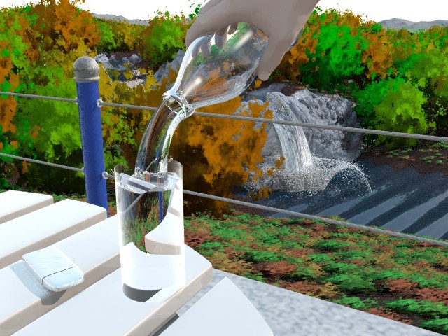

Right, I figure I probably have only about 4 more days to work on this image
before the deadline ('cause I'll be away from my computer most of next week).
So, I need suggestions on what bits you think need work and what bits look good.
Also, do you think this image is on topic? The original idea was that the
waterfall and pouring drink looked like mirror images of each other, which could
only happen for that instant in time, but that idea seems to have got lost a
little in all the details I've been putting into the scene.
All comments and thoughts will be a great help in finishing this image.
Tek

    Honest opinion Tek? I love the water pouring from the bottle. My
only problem with it is that 'if' you were to pour water with the
amount that's coming out you would have stopped/slowed down around
halfway, two thirds up the glass - that water imo is going over the
side as it is.
     Also, if you had that amount left in the bottle, it probably
wouldn't pour like that anyway?
  Generally? I love what you've done with the forestry (how did you do
that?) and I like the atmosphere of your image.
  Glass is too thin maybe?
   Just some suggestions...
    ~Steve~

I've taken some liberties with the pouring water, the technique looks good but
it's hard to tweak to realistic circumstances, 'cause it's a julia fractal so I
have very little control over how far the bottle can be from the surface of the
water (if I lower the surface I have to scale the pouring water to meet it,
which then makes it look wierd). If I get time I'll try to replace it with an
isosurface or blob or something.
The forest effect was done out of frustration with trying to make tree meshes
work (see the rather lengthy conversation on povray.advanced-users). I
eventually gave up on the meshes and just created a lot of billboard trees with
a procedural texture.
Yep, that means all those trees are flat!
The texture is pov's spherical pattern with turbulence with a high lambda value.
I've used it as a normal map, which gives the really nice shading, and also to
cut out the shape of each tree. Each tree is mapped onto 1 triangle.
Oh and do you mean the thickness of the glass, or it's width?
Tek

"St." <dot### [at] dotcom> wrote in message news:3e03d84d@news.povray.org...
    Sorry Tek, I should say that I meant the drinking vessel, not the
bottle - that's good imo.
     ~Steve~

Oh I see what you mean, yes it does appear to be paper-thin in that render. The
reason for that is actually that I used no_reflection in the glass object, which
seems to mean you can't see the thickness of it at all!
I've fixed it now :)
Tek
http://www.evilsuperbrain.com

I noticed a few things.
1. I think the waterfall is a bit rough.  The ripples coming from the
splashes need more attention as they should be rounded  And there is
probably a bit more foam and multiple disturbance points.  Also there will
probably be a mist coming from the fall.  Perhaps a spectrum effect like a
mini rainbow would be good?
2. I agree with the other post.  The Water out of the bottle would be less.
Also again the wave in the glass should be more rounded.  Perhaps some beads
of water from splashes on the side of the glass for detail?  Also there
would be tiny air bubbles in the water.
3. The glass looks to be missing a bit at the bottom.  Change the camera
angle or texture of the glass if this is caused by reflection.
4. The hand texture doesn't look quite right (close though!).  Probably
needs to be darker and rougher... with hairs?

1. In this render the top of the waterfall seems almost invisible, I don't know
what I changed that caused this. The ripples are just placeholders at the
moment, I'll put in some more realistic ones. Mist would be nice, I'll try that.
2. Hmm... I have to agree with you. If I get time I'll redo it.
3. I think this is caused by me accidentally setting no_reflection on the glass,
so when you look through it you can't see it. Plus I can't move the camera
because that breaks the symmetry between the pouring water and the waterfall.
4. The hand texture's actually 1 flat colour! I'm surprised how good it looks,
but that's the wonder of poser for you :) I've got uv mapper so putting some
details on should be straight forward.
So, if I can I'll address all these points :)
Thanks
Tek

Superb. Combines actual photorealism with
just-beautiful-thumbing-nose-at-realism.

Good stuff! But water never runs out of a bottle this continuously. There
has to be an "opening" somewhere (in the bottle or in the water stream) that
allows air to fill the space in the bottle that is left by the water. In
most cases this causes the water stream to be kind of chaotic and
bubble-like.

There is an opening, the water is only half filling the neck of the bottle.
...though now you mention it that's not obvious in the picture is it?
Well, if I manage to reduce the amount of water coming out it should look okay.
Though I have no idea how I'm going to get the chaotic effect...
Tek

Apache <apa### [at] yahoocom> wrote in message
news:3e03e84b$1@news.povray.org...
> bubble-like.
From: Apache
Subject: Re: IRTC WIP comments please
Date: 20 Dec 2002 23:36:04
Message: <3e03efb4$1@news.povray.org>
It doesn't have to obvious. In reality many things aren't obvious either!
That's a very difficult thing to do. Maybe Rune's (website) has something to
offer?
Apache
> offer?
Hmm... Well I can't find anything suitable on his website, though it has given
me an idea. I think I can get a very realistic effect with blobs, provided I do
them right...
I'll post the results of my experimentation when I have them :)
Tek

The trees look like a sponge painting - using a coarse sponge to place
the paint. Very effective, and looks like a useful idea.
Can we have a few bubbles in the glass, pretty please? It doesn't look
right at the moment.
Overall, the eye _does_ seem to connect between the waterfall and the
glass.
Alf
One of the reasons water doesn't look right is a stream in freefall gets
narrower as it drops (constant flux and increasing speed means diminishing
cross section). Also, there would be more turbulence around the stream.
Finally, I think a half filled glass would look better since you can show
off more dynamism with the surface (as it is, that much water falling from
that distance should be splashing outside the glass). Nice work overall.
> cross section).
Thank you! I hadn't thought of that at all. I agree with your other points too,
and I'm going to try to rework the water to look more realistic.
Tek
Yeah, it has a certain something. I'm currently playing with the colours to help
them fit into the scene.
I plan on adding bubbles if I get time. Though the ones on the surface might be
difficult to do. It does look unnaturally clear without them.
> glass.
Cool, I'm glad of that :)
Tek

Right, this is a test render of my attempt at improving the pouring water. I've
also tweaked various other bits and pieces, particularly the water materials.
I think it looks a lot better, but does it look realistic yet? Or should I put
more work into it?
Tek

      Yeah, I think it looks a lot better! I wouldn't really know what
else to do to make it even better, so I think it's pretty close. The
hand looks better too. Nice. Looking forward to the finished job. :)

Yes, getting better. I thought the hand was from an image until I
realised you could see the finger tips.
Alf

You could put some bubbles in the glass under the stream of liquid from
the bottle, as I don't think you'd ever get a pour of that sort of flow
rate without bubbles being forced into the target container.
And if that didn't make sense, then blame the fact that my brain is
drowning in snot...
Jamie.
Yup, bubbles are on my todo list.
