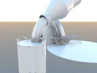

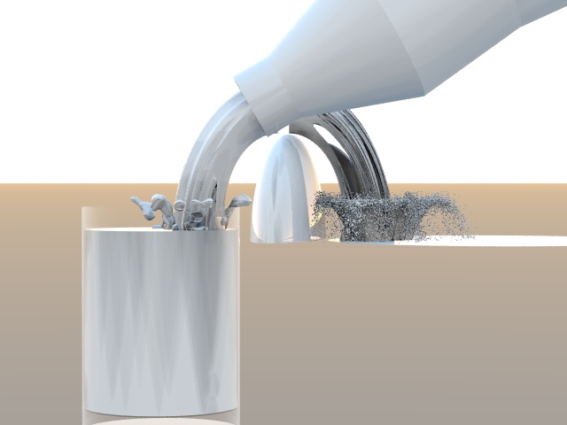

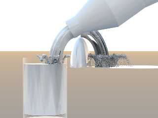

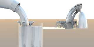

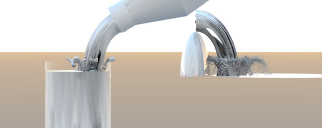

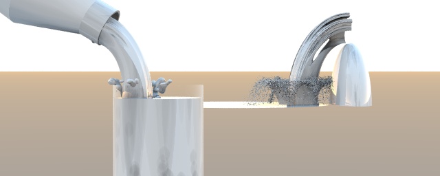

Hi. I need help! (and not just in the psychological sense)
I'm working on an entry for the Frozen Moment round. Anyway, the problem (as
you've probably guessed from the attached pictures) is that I can't decide my
favourite layout! I've created the scene with basic objects (though I've done a
lot of work on the splashes and the falling water), and I've positioned them in
various arrangements that I'm considering, and I still can't decide!
My idea is to show a waterfall and a pouring drink arranged symmetrically so you
can see a lot of resemblence between the two, despite the fact that they're
radically different sizes. Basically just to add interest to the scene :) I've
achieved this using the simple illusion that big things look small when they're
far away! So the waterfall is much bigger than the drink (it will be more
obvious when I put some scenery between the two).
So which layout do you think I should use?
And obviously any other comments and suggestions you have would be really
helpful. :)

From: =Bob=
Subject: Re: IRTC WIP help needed...
Date: 2 Dec 2002 14:03:17
Message: <3debae75@news.povray.org>
In my opinion, the 2halves.jpg picture has the most
going for it. Shows enough of each picture to establish
the connection you mentioned as wanting to attain. I
also like the 3quarter.jpg picture, but the overlapping of
the two objects seems to obscure. Maybe try moving
them apart in that one?
=Bob=
From: Ive
Date: 2 Dec 2002 14:17:13
Message: <3debb1b9$1@news.povray.org>
3quarter is my favorite, but maybe less overlapped.
BTW the doesn't liquid (milk or what? I would prefer any kind of alcohol!)
coming out of  a nozzle always have the same shape as the opening of that
nozzle?
-Ive
From: Johan Feyaerts
Date: 2 Dec 2002 14:51:14
Message: <3debb9b2$1@news.povray.org>
> helpful. :)
I'd try to bring a bit more randomness in the splash where the liquid hits
the water surface. It looks a bit artificial/static.
From: Lieut Data
Date: 2 Dec 2002 15:11:10
Message: <3debbe5e$1@news.povray.org>
news:3debab39@news.povray.org...
(as
my
done a
them in
Im leaning toward the 3quarter as well, if only I could see a bit more of
the waterfall (bottle covers it slightly)

From: Slime
Date: 2 Dec 2002 15:26:02
Message: <3debc1da$1@news.povray.org>
Either flat-r or 3quarter.
By the way, I strongly suggest you spend some time pouring water into a
glass and examining the shape of the water being poured as it comes out of
the bottle. Maybe even get someone else to take some pictures as you do it.
Right now the water coming out of the bottle looks like something very
thick, like a glob of paint.
 - Slime

From: Tek
Date: 2 Dec 2002 16:35:42
Message: <3debd22e@news.povray.org>
Ive <ive### [at] lilysoftcom> wrote in message news:3debb1b9$1@news.povray.org...
> nozzle?
It's only milk because I've not worked on the materials yet, it's either gonna
be coke, orange juice, or something alcoholic :)
Liquid coming out of a bottle can't be the shape of the opening, because air has
to get back in to fill up the empty space. But, that said, it doesn't look right
yet, I'm thinking of flattening it a little so it looks like there's less water
coming out.
I'm now rendering a less overlapped version of 3quarters.
Tek
http://www.evilsuperbrain.com

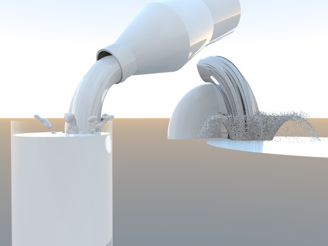

From: Tek
Date: 2 Dec 2002 16:39:09
Message: <3debd2fd$1@news.povray.org>
Johan Feyaerts <joh### [at] no_spamskynetbe> wrote in message
news:3debb9b2$1@news.povray.org...
I think the problem is the surface is too flat. I'll probably use a heightfield
or isosurface for them.
Obviously this isn't finished yet so I'll tweak everything more once I've got
the right materials in there.
Tek
From: Tek
Date: 2 Dec 2002 16:42:15
Message: <3debd3b7$1@news.povray.org>
Slime <slm### [at] slimelandcom> wrote in message news:3debc1da$1@news.povray.org...
Yeah I agree. I think part of the problem is there's too much water for the
angle the bottle's at, once it gets to that angle it should be almost empty.
It's a julia fractal at the moment, but I think I may have to go for a more
conventional technique like blobs or something. I'll keep experimenting :)
Tek
From: Aaron
Date: 2 Dec 2002 16:50:56
Message: <3debd5c0@news.povray.org>
Use 2halves.jpg.
But go and get a bottle or something and watch the water coming out.  Its
never that rounded or smooth.
Also the waterfal would tend to hug the rock unless you have a good
over-hang (unless its coming out of a pipe or something.  Also it'd be alot
flatter at the top as well.  Again looking at a couple of pictures of
waterfalls would be good.  :)
But otherwise I like it!
Suggestion for fluid... chocolate!   As in Charlie and the Chocolate
Factory... have an Oompahloompa (sp?) pouring the glass.
From: Tek
Date: 2 Dec 2002 17:24:28
Message: <3debdd9c@news.povray.org>
Aaron <aar### [at] ihugconz> wrote in message news:3debd5c0@news.povray.org...
> Use 2halves.jpg.
Woohoo! Yeah that's my favourite too, but no-one else seems to agree with us! I
like 3 quarters too so I'm going to keep refining it from both those views until
I can make a choice between them
Yeah I know. I was mostly doing water like this as a reference to my first (and
still my highest scoring) IRTC entry. (honourable mention in the topic "The
Sea", entered under my real name: Ben Weston).
Though in response to the comments from you and Slime I'm going to try something
new for it.
Well as you probably realised the squashed sphere that I'm using is going to be
replaced by a rock formation that much more closely fits the shape of the
falling water.
Woah freaky coincidence. I was just listening to a tune called "Oompa Radar" (by
Goldfrapp) when I read your message! But I think I'm going to be boring and try
a realistic scene (to juxtapose with the unrealistic symettry).
Thanks for your comments :)
Tek
From: Shay
Date: 2 Dec 2002 18:02:48
Message: <3debe698@news.povray.org>
> helpful. :)
I don't think that any of your current layouts will work. In order for your
concept to be completely realized, the bottle and the waterfall must not
only both pour, but also both pour into the same receptacle. I can imagine a
scene with the lip of a bar glass in the immediate foreground which becomes
more obscured as it curves to the opposite side in the background, where the
edge of the glass becomes the shore of an ocean or large lake. Fish visible
through the bar glass might also be interesting.
The absence of a hand holding the bottle will be pretty conspicuous in the
finished picture, so I would suggest a large pitcher instead with it's
handle out of frame. The line formed by the liquid still in the pitcher
could be aligned with the mountaintops in the background.
 -Shay
From: Tek
Date: 2 Dec 2002 18:46:28
Message: <3debf0d4@news.povray.org>
Hmm... it's an interesting interpretation, but the image isn't meant to be so
surreal as that. My idea is simply that there's an improbable amount of symmetry
to the things within the image, but that all of them remain possible.
I plan on adding a hand to hold the bottle. I had considered the idea of using a
jug (which I guess is the same as a pitcher?) but the problem there is that it
would be empty if it were held above 90 degrees, and at any angle below that it
will obscure most of the waterfall.
Tek

Shay <sah### [at] simcopartscom> wrote in message news:3debe698@news.povray.org...
> "Tek" <tek### [at] evilsuperbraincom> wrote in message
> > helpful. :)
>  -Shay
From: Tek
Date: 2 Dec 2002 18:52:46
Message: <3debf24e@news.povray.org>
By popular demand, here's a re-render of the 3quarter image. I've turned off the
glass in this image because it was making a mess of the radiosity (and I don't
currently have the time to do a save & load of the radiosity).
To me this looks somewhat off balance. The spacing is now the same as that used
in the 2halves image, but because we're looking down on things the glass looks a
strange shape.
I'm going to try a longer zoom (i.e. smaller camera angle) to flatten
perspective a little.
What do you think? Is this an improvement?
Tek
Download '3quarter2.jpg' (32 KB)
Preview of image '3quarter2.jpg'
From: Daniel Prien
Date: 2 Dec 2002 19:09:08
Message: <3debf624@news.povray.org>
I like it. Most the idea of using a juliafractal for the waterfall.
What about putting things together. I mean a waterfall ( or beer, coke,
whatever) filling the glass?
Think i saw something like that in an advert long time ago.
Daniel
From: Thies Heidecke
Date: 6 Dec 2002 13:02:02
Message: <3df0e61a$1@news.povray.org>
My favorite is 3Quarter,
nice image btw,
Thies Heidecke
