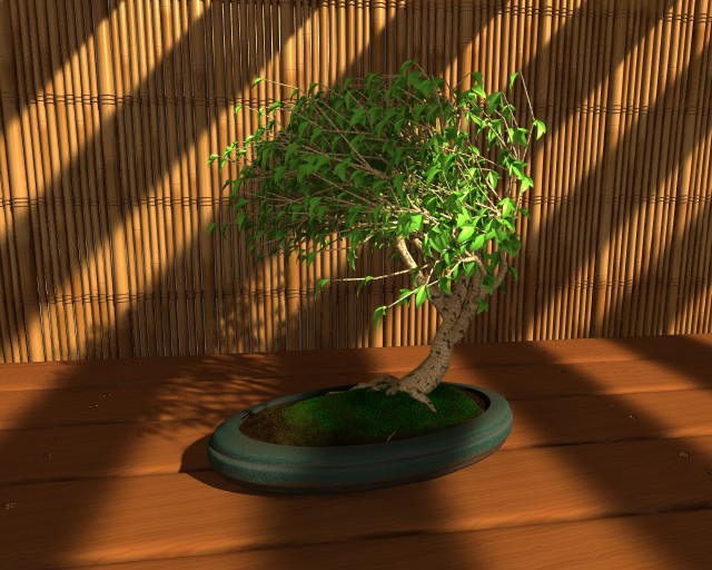

This is a bonsai scene I have been playing with on and off for a while.  I'd
like to add some media to create a slightly dusty/hazy look that would
highlight the light beams a little and maybe give the image a little extra
something.  Any advice on how to create a media that would do that would be
appreciated.
Patrick Dugan

Since you're using an area light, and area lights + media are a bad idea
when avoidable, I'd suggest this approach:
1. Put the entire scene you have right now (excluding the camera) into a
light_group.
2. Inside a separate light_group, create a plane whose surface coincides
with the backside of the bamboo wall. Make sure the tree and camera are
*inside* this plane. Make the plane hollow and transparent and give it an
interior something like
interior {
media {
scattering {2, .01}
// experiment with different scattering types (like type 1, or type 5 with
different eccentricity values)
// if the media is too heavy, lower the .01; if its too invisible, bring the
.01 up higher.
// if there's simply too much darkness for the lighting effects that are
created, then add "extinction .5" and fiddle with the .5 until it looks
good.
3. Put a light source identical to your area light inside this light_group,
but *don't make it an area light*. That way, the solid objects in the scene
will be lit with an area light, but the media will be lit with a point
light. This will speed up the render a *lot* and the difference probably
won't be noticeable.
 - Slime
[ http://www.slimeland.com/ ]

Nice...the bark and leaves look too brightly lit though, do they have a
high ambient?
Anyway, what you want is scattering media, without a density pattern,
and with a very dim scattering color. Type 4 (Rayleigh) scattering is
probably the best for this. If it is invisible, boost the scattering
amount, if everything is black or white, lower it.
http://tag.povray.org/

Okay, I'll show my stupidity here.  If I use a plane that is parallel to the
back wall won't it be flat?  How can the
tree and camera be inside it?  I could see a box since it would "fill" the
scene but I don't understand using a plane.

I think he means you'll have to create a plane and rotate it
so the +y axis of the plane points to the tree and camera.
Bye
Txemi Jendrix
http://www.txemijendrix.com

Planes have insides and outsides just like boxes or spheres. The
"underneath" part of a plane is considered to be "inside" it. So just make
sure the normal of the plane points *away* from the camera, so that the
camera is "underneath" it.
 - Slime

My only nit to pick is that the whole bonsai - even the leaves - seems
luxophobic. Shouldn't at least the leaves make some effort to point to
the light, instead of away from it?
Peter Popov ICQ : 15002700

Well the entire scene has all ambient turned off.  It might be caused by my
radiosity setting being too bright.

be
> > appreciated.
> high ambient?
> Christopher James Huff <cja### [at] earthlinknet>
> http://home.earthlink.net/~cjameshuff/
> POV-Ray TAG: chr### [at] tagpovrayorg
From: Txemi Jendrix

From: Andrew Coppin
Subject: Re: bonsai scene ~96k
Date: 9 Nov 2002 03:01:22
Message: <3dccc0d2@news.povray.org>
What a stunning little image... The colours, the sense of sunshine... The
tree looks cool... That moss is brilliant too... I _like_ this!
Andrew.
From: hughes, b
Date: 9 Nov 2002 09:14:29
Message: <3dcd1845$1@news.povray.org>
"Patrick Dugan" <pat### [at] netinsnet> wrote in message
news:3dcb12c3@news.povray.org...
I'd
be
> appreciated.
Not sure if that's a good idea, myself. Hazy air can be overused sometimes.
I think this looks nice and clean as is, like it's sitting out on a patio
outside instead of a closed space.
While looking at it here I couldn't help thinking that if I could see just a
little bit of a background landscape showing between the bamboo screen that
I'd feel more in the picture than out looking in. Just a thought. Not
anything but a little sky, vegetation, and building colors; with only very
slight hint of there being something back there. In fact, it almost starts
to look that way when I scrutinize it more. It's a fairly small image as
seen here.
From: Patrick Dugan
Date: 9 Nov 2002 12:46:29
Message: <3dcd49f5@news.povray.org>
There is a little background behind the bamboo.  It is more noticeable in
the larger version.  I didn't want anything obviously behind it only the
hint to avoid detracting from the main focus.
