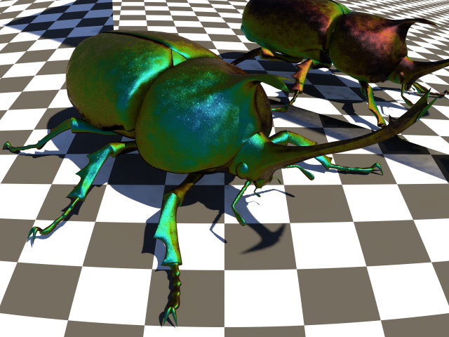

hi,
had some time and wanted to imitate the metallic look of an iridescent
beetle.
The beetle itself is a nice model from
http://www.renderosity.com/freestuff.ez?Form.Contrib=JTrout&Topsectionid=0 .
There is only one texture and it is far from being perfect.
But I have not seen a good texture for interference pigments on animals like
peacocks, some fishes, butterflies and many insects more so far.
Comments, tips?
Norbert
Download 'slope_pigment test.jpg' (107 KB)
Preview of image 'slope_pigment test.jpg'

This texture looks interesting. But I'm not sure what you're using the
slope pattern for? Aren't you just using it relative to the camera
location, in which case variable reflection might just as well do the
trick?
Well, I'm not at all sure of that, just curious...
Rune

hi Rune,
I admit, the effect can hardly be seen.
The bug seems to be blueish at parts perpendicular to the camera and yellow
at the other end.
I donīt think, it is physically correct, but Iīm not able to simulate a
photonic structure within Pov-Ray.
Norbert

Oh, I think it's very visible (and beautiful too). But I think it can be
achieved without a slope_pigment, by using variable reflection instead.
And then you don't have to keep track of specifying the camera location
correctly, and it will also work if you have mirrors in your scene etc.
Rune

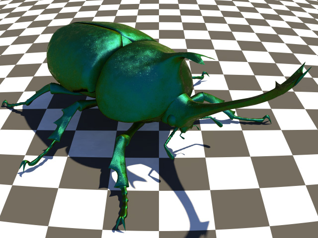

I see your point with the mirror.   :-(
But again, how can I get the color change with variable reflection? Wouldn´t
the same problem  exist as with a relatively simple slope pigment?
Norbert
By using different colors for the minimum and maximum reflection. This
however will only make the color of the reflection change, not the
pigment, but combined with heavy reflection blurring, this might look
good.
Here's some sample code, but it doesn't have blurred reflection:
sphere {
   0, 1
   pigment {rgb 0.1}
   normal {bumps 0.5 scale 0.15 turbulence 0.5}
   finish {reflection {<0.1,0.2,0.5>, <0.4,0.8,0.4>}}
light_source {<1,2,-3>*1000, color 1}
camera {location -4*z look_at 0}
background {rgb 1}
Another problem is that you can only blend between two colors with
variable reflection, but that might also not be a big problem.
Rune
> Comments, tips?
Have you seen:
Subject: insect shader (50ko bu)
Date: Mon, 15 Jan 2001 09:59:57 +0100
Newsgroups: povray.binaries.images
From: gemelli david <d.g### [at] xlstudiocom>
news://news.povray.org/3A62BC0D.C65F3E08@xlstudio.com
http://news.povray.org/3A62BC0D.C65F3E08@xlstudio.com
Subject: Exoskeleton 1.5 (61 ko bu)
Date: Tue, 16 Jan 2001 09:04:53 +0100
news://news.povray.org/3A6400A5.98BB433A@xlstudio.com
http://news.povray.org/3A6400A5.98BB433A@xlstudio.com
Last updated 02 Nov. 2002 _____./\/^>_*_<^\/\.______
From: Norbert Kern
Subject: Re: slope_pigment test
Date: 3 Nov 2002 12:59:24
Message: <3dc563fc@news.povray.org>
I haven´t made anything with shaders and Pov-Ray versions using them up to
now. But it sounds interesting. thanks!
A big disadvantage is the fact that only two colors can be used. The
"metallic" looking insects have a nanostructured chitin hull and the effect
comes not from a pigment but from structures between interference pigments
and photonic crystals.
So some beetles show many colors dependent on the angle of the surface to
your point if view.
Norbert
