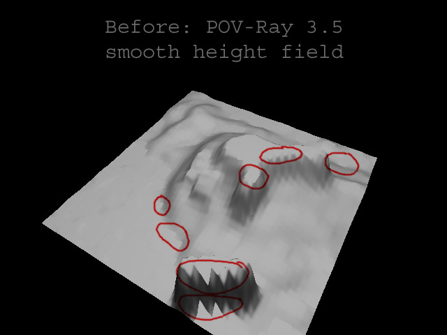

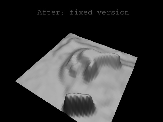

See the thread in povray.programming for an explanation.

This is great! Magnificient!
I still remember all those long discussions about
reworking the entire code etc... I guess it was just
in the nature of the bug that everyone assumed it
to be working correctly, and that some calculation
discrepancies were the cause, and checking these
would surely mean that the code would have to be
redone in an entire different way...
I mean, think about: Calculate the normals, normalize
them, done... Who would expect that there's a mistake
in that assumption?
Very good job. Everyone's slapping their heads,
telling themselves: Why didn't I come up with that?
I don't blame anyone. Its just good that we get a
fix for this.

Hee hee, thanks =) I was *very* glad to find the solution after 2 days of
frustration.
I guess that conversation was back during 3.1, I wasn't here for it...
> in that assumption?
Yeah, and in fact, there isn't really anything wrong with it. The reason for
the artifact is that interpolating normals isn't really an exact science. It
just happens to create a nice effect when done linearly. The transformation
after interpolation was causing it to be nonlinear, sorta, but it was still
interpolated. Just not quite like we wanted it to be. It's one of those
cases where the algorithm is doing exactly what you intend it to, but the
final result isn't exactly what you expected.
At first I thought it was a problem with the loss of data when typecasting
from double to short, but it turns out that that's hardly noticeable.
(however, since most of the normals tend to have a Y value that's extremely
small, it's not entirely unnoticeable, and I'm going to look for a way to
store the data differently so that there's no visible difference between
doubles and shorts. The screenshot I showed used doubles to store the normal
vectors.)
