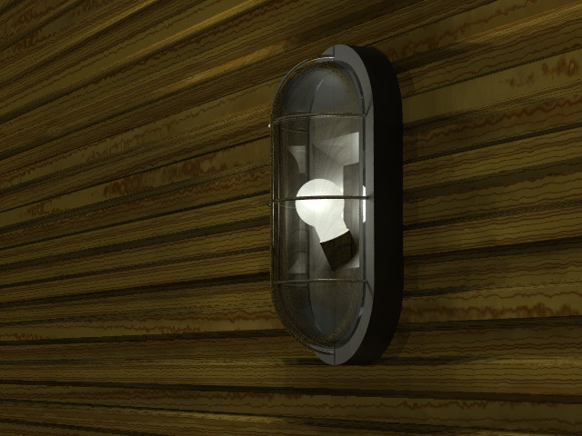

Hi, this is my first post and first serious attempt to make a POV-scene. It
will be a complete sauna but i have only made a macro to make the walls and
the lamp so far.
What do you think about the lamp?
I'm not sure about the metall wires that holds the glass thing, should there
be two vertical instead of one? How many horisontal? I have no reference,
I'm just modeling from memory.
Daniel Nilsson
Download 'lamp.jpg' (92 KB)
Preview of image 'lamp.jpg'
Subject: Re: WIP lamp for a sauna (92kb)
Date: 12 Sep 2002 20:38:57
Message: <3d8133a1$1@news.povray.org>
It looks great- except for one little thing.  This bulb should be either a
SOR or a blob to get rid of the abrupt CSG "sphere to cylinder" transition.  The
wood looks more like "butcher block" Formica, but I don't have a complaint with
it.
Cheers!
Chip Shults
From: Martin Magnusson
Date: 13 Sep 2002 04:33:54
Message: <3D81A2F1.66E31F2D@student.uu.se>
The wood is fine, IMO, but I think the glass should be less transparent.
Maybe some sort of semi-opaque plastic, to make it more of a lampshade.
/ martin
From: Sebastian H
Date: 13 Sep 2002 07:23:23
Message: <3d81caab@news.povray.org>

Looks good, but Sir Charles may be right with the CSG bulb thing.
The lamps in our cellar look very simillar, but they have two parallel
vertical "glass holders" (ok, actually our one's are made of plastics  ;-) )
Sebastian H.
From: Daniel Nilsson
Date: 13 Sep 2002 11:00:13
Message: <3d81fd7d$1@news.povray.org>
"Sebastian H." <seb### [at] webde> wrote in message
news:3d81caab@news.povray.org...
Yes, I know. I just did the csg bulb for this render. I will make a better
one...
I discussed this with a friend and he said that there are two also. I will
change this.
/ Daniel Nilsson
I also think that there is something missing with the glass but I think it
shouldn't have a smoth surface. I'm thinking about making sort of ridges.
I'll experiment a little...
/ Daniel Nilsson

Do an http://images.google.com search for "bulkhead light" - you'll get some
great examples very similar to your own design...

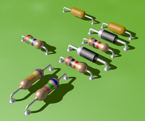

Date: 14 Sep 2002 16:25:50
Message: <3d839b4e@news.povray.org>
Yes, I use the cylinder/torus difference trick for other things as well.
Very useful.  Check out the solder joints on some parts here- also done with the
cylinder/torus difference.
Cheers!
Chip Shults
Download 'Parts4.jpg' (21 KB)
Preview of image 'Parts4.jpg'

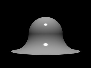

From: Ib Rasmussen
Date: 15 Sep 2002 05:09:11
Message: <3D844E25.6060903@ibras.dk>
Well, where would we be without it. Couldn't do much neoclassical
architechture without it :)
It does have it's problems, however. If you combine it with an concave
shape like on the attached image (code below), the shading looks
strange. I don't know if it is a problem with pov's shading model, or I
just have wrong expectations to how a shape like this should look, but I
don't think it looks right.
/Ib
--- code start ---
camera {
    location  <0, 10, -100>
    angle 30
    look_at   <0, 10,  0 >
light_source { <0, 500, -250>, colour White*2}
union {
    sphere { <0, 10, 0>, 10 }
    difference {
       cylinder { <0, 0, 0>, <0, 10, 0>, 20 }
       torus { 20, 10 translate <0, 10, 0> }
    texture { pigment { Gray50 } finish { Phong_Shiny } }
--- code end ---
Download 'testshading.jpg' (5 KB)
Preview of image 'testshading.jpg'

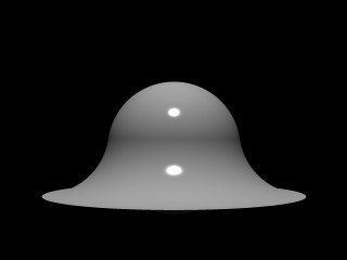

Date: 15 Sep 2002 13:35:27
Message: <3d84c4df$1@news.povray.org>
Hey, you're right!  Perhaps we could use a slightly different sized sphere-
like just a hair larger- and move it downward a bit to compensate so the
intersection is the proper size?  It would be a real pain, but it could be
tried.
Cheers!
Chip Shults

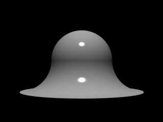

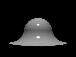

From: Ib Rasmussen
Date: 15 Sep 2002 16:24:34
Message: <3D84EC6F.7080109@ibras.dk>
> tried.
It helps, but it takes more than a hair to get rid of the effect.
The attached image shows this variant:
union {
    sphere { <0, 7.1645, 0>, 10.2 }
    difference {
       cylinder { <0, 0, 0>, <0, 8.5963, 0>, 20 }
/ib
