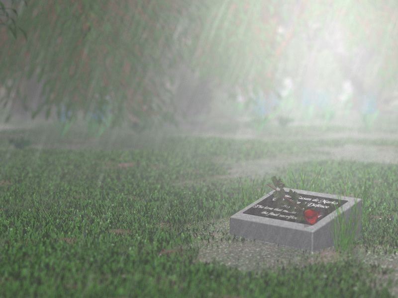

Another WIP of my loneliness pic. I took some of the flowers out (felt it
was too cluttered)
and added some rain. I've done a few variations and put them on my website
http://rucus.ru.ac.za/~gail/Raytracing/Variations.html
Gail
#macro G(H,S)disc{0z.4pigment{onion color_map{[0rgb<sin(H/pi)cos(S/pi)*(H<6)
cos(S/pi)*(H>6)>*18][.4rgb 0]}}translate<H-5S-3,9>}#end G(3,5)G(2,5.5)G(1,5)
G(.6,4)G(.5,3)G(.6,2)G(1,1)G(2,.5)G(3,.7)G(3.2,1.6)G(3.1,2.5)G(2.2,2.5)G(9,5
)G(8,5.5)G(7,5)G(7,4)G(7.7,3.3)G(8.3,2.7)G(9,2)G(9,1)G(8,.5)G(7,1)///GS

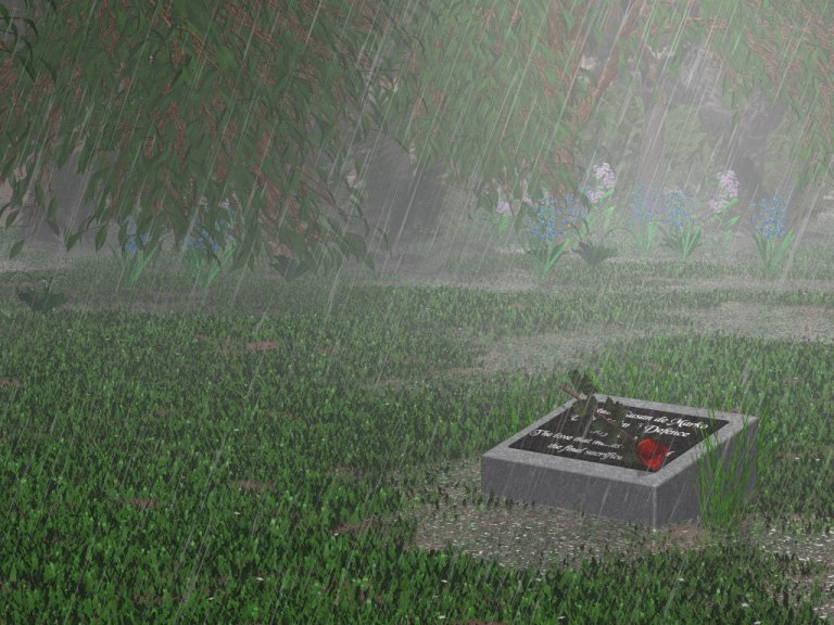

Here's a version with focal blur. Just need to get the rain to behave <g>
Gail
> was too cluttered)
That rain is great, care to explain how it is done?  Does it look good
with a larger render too?
I think the 'Different textures' version is very nice.
This version is a lot nicer than the one without...
May want to decrease the ambient of your stone to make it look
wet...also, I can't make out the name, partially due to the
font used...for the name on a grave, a block, easy-to-read
typeface is used.  Everything else is up for grabs, but the
name should be easy to identify from a distance.
Good rain, the whole image looks wet. Looking at the angle a which the
rain is falling, some motion-blur on the tree leaves would be a bonus.
Of all the versions I'd prefer the one with the text diffrent textures,
it's a bit darker and thus shows the contrast with the rose better.
Something I would certainly look into, is the brightness of the wall (and
the fog?). Its brightness makes it appear closer than it is. Toning down
the wall or actually the whole backgound would add more depth.
Last, the rose's position. I think when you arrange it differently,
starting bottom left and the flower top right on the stone, the image
becomes "easier / more comfortable" to look at.
Ingo

news:3D5E77C3.3BCB2ABC@gmx.de...
it
> > was too cluttered)
I cheated. It's a plane with a partially filtering, partially transparent
spotted texture
> Does it look good
If you tweak the scale
> Christoph
Ooops, checked while I was still updating it <g> You're too fast for me
The different texture has been included in the current version.
New page is up now
Gail
> spotted texture
Well, now that you say it - this technique has the disadvantage that the
rain density does not increase with the distance.
Last updated 13 Aug. 2002 _____./\/^>_*_<^\/\.______

"Gail Shaw" <gai### [at] mwebcoza> wrote in message
news:3d5e768c@news.povray.org...
    I had a feeling that this was goign to go somewhere. It did. I regularly
visit our local graveyard to tend an unattended gravestone. No that the
groundskeepers aren't doing their job, but they don't scraper off the little
bits of moss or waipe off the rainstains. They also don't stop to think
about who Shelby MCadams and her un-named newborn child (1953) were. I don't
imagine that they are there, under the dirt, but their marker is all I have
to stand next to. It is, as far as I can tell, their only mark on this
world. Over the last 20 years that I know of, I am the only one that has
brought flowers.
>> spotted texture
  And that the focal_blur shows there is not any drop on focus... I was
just about to complaing about this on the second image, now I understand
why. Perhaps both problems can be solved with some more planes...
  Anyhow, this is going to be a very nice scene, Gail. I feel rain scenes
are specially suited for focal blur, and on your scene it seems to enhance
the theme.
Jaime Vives Piqueres

"Timothy R. Cook" <tim### [at] scifi-fantasycom> wrote in message
news:3D5### [at] scifi-fantasycom...
<g>
> wet...also,
I'll look into that
OK thanks
I know. Without the blur the rain looks like it's at various distances,
especially in
a scene like this where there isn't much in the foreground.
Gail
It can to a degree, the texture needs to be adjusted every time a plane is
added to
keep the number of droplets more or less constant
> the theme.
Thank you.
Gail

I like the one with focal blur best. I also think you should maybe add some more
headstones or put tiny, paler versions of the flowers back in, particularly to
the left. Just something to add some balance to the picture without competing
for viewer attention.

Gail,
I prefer this version.   I actually think the image would be more poignant if
the rose were in the water - as if the hard rain had washed it off the stone.
We'd have a better shot a reading the inscription too,  if you mean for it to
be read.
Finally, I expect it is intended, but why is this grave stone alone?  My answer
- It is a relatively new grave in which case perhaps the grass whould be a bit
less developed over the grave site?
Bill

"William F. Pokorny" <pok### [at] attglobalnet> wrote in message
news:3D5FC204.5D0050EB@attglobal.net...
> Gail,
if
stone.
to
> be read.
I tried that yesterday and it liooks very nice. Thanks for the idea
answer
bit
There's a story behind this, I'll post the story when I post the final
version, Next week sometime.
Gail

"Batronyx" <bat### [at] alliancecablenet> wrote in message
news:3d5fb8be@news.povray.org...
That one does seem to be the most popular, and the longest to render (15hrs)
particularly to
competing
I'm going to add a few small flowers scattered in the grass
Gail
