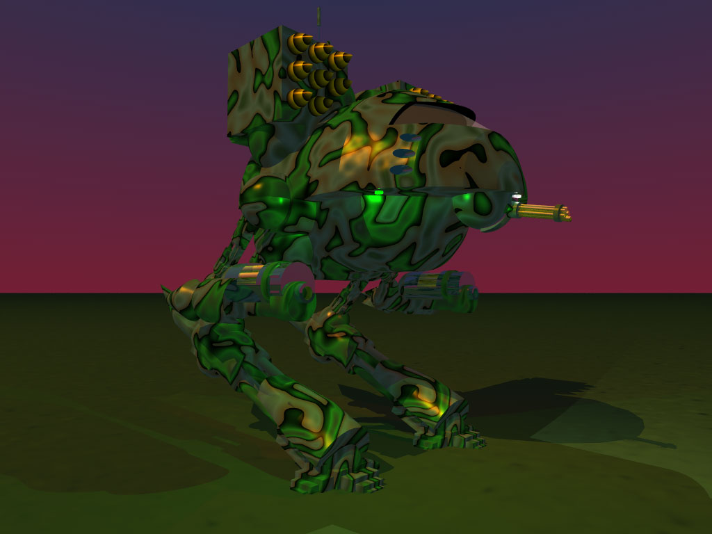

Hello Again,
I'm trying to give it a more *worn-out* look, does anyone have any
suggestions? I also added some ship-like position lights, and I've still not
started to work on the background, but I think its gonna be some kind of
midnight/desert theme.
f00
From: f00
Subject: Re: Battlemech WIP *used* look ?
Date: 12 Aug 2002 13:22:55
Message: <3d57eeef@news.povray.org>
Again,  forgot the pic 8-)
f00

Agree. It could use a been-in-battle look. Right now it looks more
like a mech on LSD or something.. ;)
I'm a Moray user so I don't know if the same textures exists in
Povray but I've got some rusty iron textures that look quite good
if you tweak them a little.
Another way is to use imagemaps.
The modelling is coming along good. Keep it up.
/Stefan

The first thing I'd say to you is that it looks too uniform.  It looks
like you have one union, and the texture assigned to the whole thing.
 Try subdeviding it, and applying the texture seperatly, maybe even
having slight differences in the texture applied to the left arm, say,
as opposed to the right leg.
Also, your texture is too shiny... play with the settings and see if you
can get a more matte surface.
Maybe a spot of bondo or two?
Some rust?

Actually, I build the whole structure step-by-step, by now its about 26
previously declared objects with loads of CSG at about 1600 lines of code,
and I'm starting to get confused ;-)
I had something like this in mind, thanks anyway, I'll post another pic with
some of those alterations later, as right now I try to add some more details
to the model rather than mess with the texture to much.
I'll try to reduce this, thx
What is "bondo" ? not the same as "phong" I guess ?!
> Some rust?
I have not figured out yet how to make a camouflage texture with some rusty
areas /spots in it, I think that woud be nice. Any suggestions ?
Anyway, thanks alot for the response,
f00
Sometimes, the right texture can make all the difference.  Dropping a
color map, a bump map, or even an image map onto a metalic texture can
change the whole look of an object.
/laugh/
Bondo is a putty compound used to fill dents and dings on automobiles.
 When it's sanded, primed, and painted, it looks the same as any other
surface... but in the American South, you often see good ol' boys
driving around in old jalopys with either spots of raw bondo, or sanded
and primed, but not painted bondo.
I figure, if a 'mech got into a dust-up, got some dings on it, the
maintenance boys'd probably use something like bondo... and if they mech
had to go out again the next day, they might not have time to paint it
before it went out.

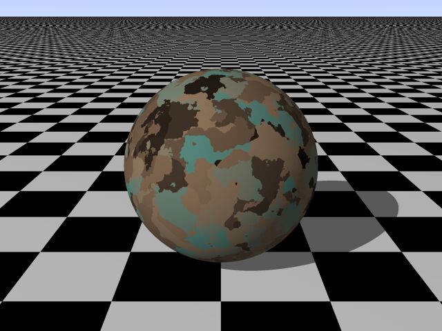

Well this is somrthing about your request on a camouflage texture.
I came up with this texture while I was making some experiments on a texture
that someone posted here in this news group.
(It was a texture used in the ground, but I can't remember the name of the
author.)
So while playing with its values I achieved this texture. Its no big deal
but its a starting point.
Best regards.
teste04.pov-----------------------------------------------------------------

Thanks alot for this, I think I can make some use of it ;-) I'll post a new
WIP pic later today.

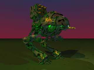

JPGargoyle's eks is fine but u might want to try a tweak
#declare T1 = texture {
     pigment {
         cells
         turbulence 8
         color_map {
              [0 color rgb Black]
              [0.8 rgb SemiSweetChoc]
              [1 rgb HuntersGreen]
this is rust -some color pathes added to this surface or maybe a¨reflection
like from a wet surface could look wornout and used
regard krus
