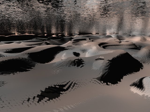

Ok, I have the scene set up, but I want to get a good media for the water.
It should be slightly green and I want to see light rays casting down from
the sun.
I have tried, but I just can't get the hang of it.
Download 'undersea.jpg' (66 KB)
Preview of image 'undersea.jpg'

Nice water, by the way. What happened to your height_field, though? It's
got some strange artifacts I haven't seen before. What color depth did
you use when making it?
I used a GrayScale TGA and I agree, I am NOT happy with it.

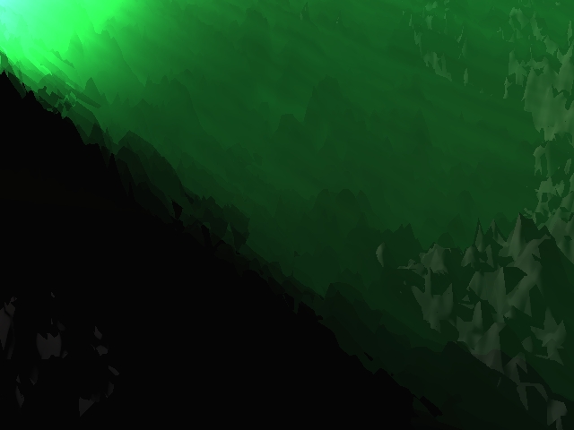

From: Bryan
Subject: Re: Undersea (80K)
Date: 1 Aug 2002 02:08:57
Message: <3d48d079@news.povray.org>
This is much better...
    interior{
        ior 1.33
        media{
            samples 1,1
            scattering{3,rgb<0.5,3,1>*0.001 extinction .01}
            method 3
"Bryan Valencia" <bry### [at] 209softwarecom> wrote in message
news:3d481ada$1@news.povray.org...
> Hmmm I tried that (media{ scattering{5,.01 extinction .001} method 3 })
and
> the image took 2 hours to render and was totally white. :(  I tried
changing
> the media settings, but  I just don't get it.
Download 'undersea.jpg' (81 KB)
