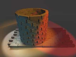

on disk i found a piece of a scene i made long time ago. it is a macro
which makes a floor, a wall and a well. the well part of macro is buggy as
everyone can see. that is because i have no solution for the question: on a
defined stone and a nearly given radius how many complete stones can be
positioned to fill a circle and how great is radius then? is there a
formular i can use? for help i would be appreciated. for comments on the
pic, too.
Download 'well.jpg' (50 KB)
Preview of image 'well.jpg'

I'd attack it like this:
The interior faces of the bricks form a regular N-gon with the side
equal to the length of the brick. Determine the sizes of regular N-gons
with unit size and pick the one that most nearly matches the given
radius.
Let's call the distance from the centre of the circle to the midpoint of
an edge "R". (It's not a true radius, particularly in cases where N is
odd).
We know that the sum of the angles at the centre is 2*Pi, and that the
N-gon is regular, so each edge subtends an angle of 2*Pi/N at the
centre.
Lets draw a right angled triangle connecting the centre of the circle,
the centre of an edge and an adjacent vertex. We can see that the angle
at the centre is Pi/N, and it's tangent is 0.5/R (opposite over
adjacent), so
        tan(pi/N) = 0.5/R
i.e.
        R = 1/(2*tan(pi/N))
So
#declare N=3;
#while (1/(2*tan(pi/N)) < given_radius)
  #declare N=N+1;
#end
#declare R = 1/(2*tan(pi/N));
Mike Williams
> pic, too.
>    well.jpg    Type: JPEG Image (image/jpeg)
>            Encoding: base64
From: marabou
Subject: Re: well [49.7kb]
Date: 28 Jul 2002 05:42:44
Message: <3d43bc94@news.povray.org>
Lawrence Winstead wrote:
> How did you stagger the bricks from row to row?  I'm trying to do my own
> well, and so far I've the rows repeating, but I can't seem to figure out
> how to get each row to be rotated a little more than the last, i.e.
> staggered.
you set one row of your well. then you rotate it with a randomly generated
angle. then you do the same with next row. simple, isn't it?
