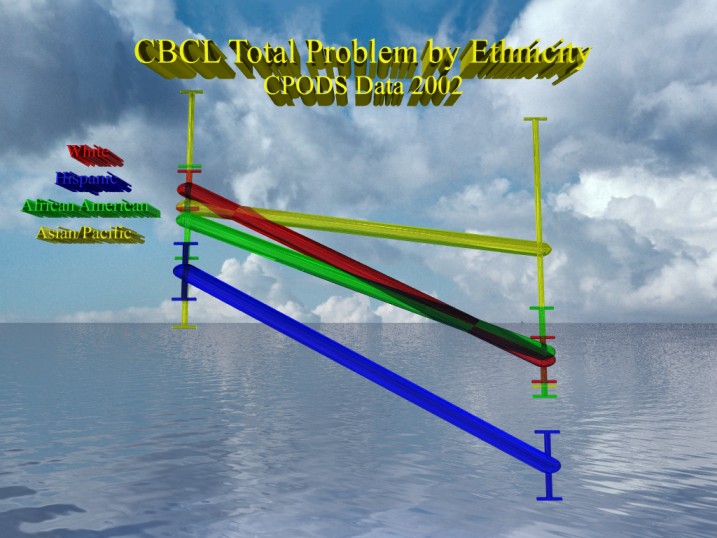

Hello friends.
I'm playing with POV-Ray as a rendering tool for
SPSS. This is a chart looking at change in mental
health scores for children by ethnicity. The slope
lines are drawn with sphere_sweeps.
Problem...
There is a "cross-hatch" artifact where two of
the sphere_sweep bars cross. The red and green
ones. Anyone know why?
TIA,
Harold
Download 'GLMslopechart.jpg' (92 KB)
Preview of image 'GLMslopechart.jpg'
Subject: Re: Statistical chart with artifact
Date: 10 Jun 2002 20:37:08
Message: <3d054634$1@news.povray.org>
You are using cylindrical bars, pretty obviously.  This "artifact" also
shows up in the red/yellow crossing.  Ask yourself a question- what shape is
generated by the merging of two cylinders that are nearly parallel?  That is
your answer.
Because in some parts, the green is in front of the red, and in other parts,
the red is in front of the green. The sphere_sweep that's closer for any
pixel is the one that will dominate the color of that pixel.
 - Slime

Other have given you some good answers on how this is caused. If it
were me, I'd simply move the different lines slightly closer to, or
farther from the camera, to put them on slightly different planes.
That should cure this "fight for dominance"issue.

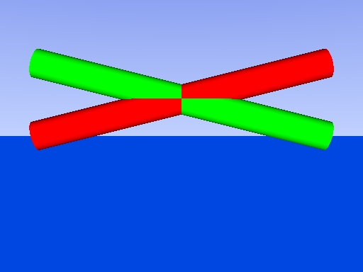

Following what Sir Charles said, this is what two solid cylinders
intersecting look like.
-tgq

Yeah, now i recognize that I just expected it to
behave differently. Expected a smoother transition.
HB

Don't use cylinders/sphere sweeps, sharp edged rectangles, then you'll
get a merged colour at the intersections, just round the ends off with
a macro or something.  And like others said make the text flatter.
