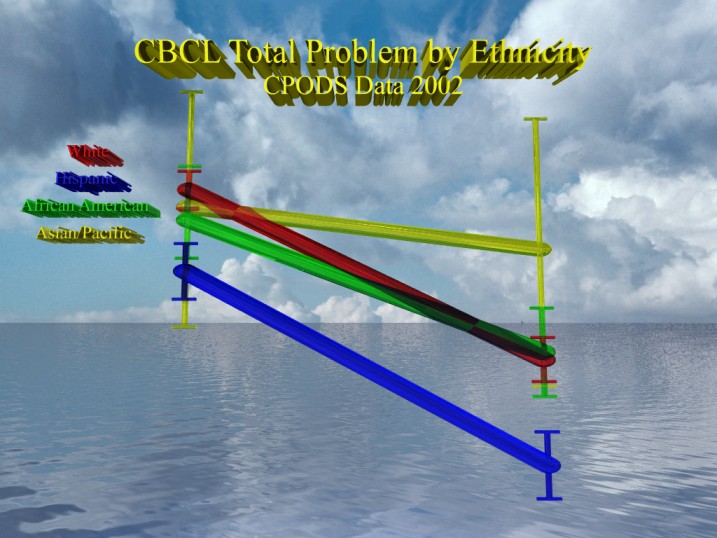

Hello friends.
I'm playing with POV-Ray as a rendering tool for
SPSS. This is a chart looking at change in mental
health scores for children by ethnicity. The slope
lines are drawn with sphere_sweeps.
Problem...
There is a "cross-hatch" artifact where two of
the sphere_sweep bars cross. The red and green
ones. Anyone know why?
TIA,
Harold
Download 'GLMslopechart.jpg' (92 KB)
Preview of image 'GLMslopechart.jpg'

You are using cylindrical bars, pretty obviously.  This "artifact" also
shows up in the red/yellow crossing.  Ask yourself a question- what shape is
generated by the merging of two cylinders that are nearly parallel?  That is
your answer.
Cheers!
Chip Shults
Because in some parts, the green is in front of the red, and in other parts,
the red is in front of the green. The sphere_sweep that's closer for any
pixel is the one that will dominate the color of that pixel.
 - Slime
[ http://www.slimeland.com/ ]

Other have given you some good answers on how this is caused. If it
were me, I'd simply move the different lines slightly closer to, or
farther from the camera, to put them on slightly different planes.
That should cure this "fight for dominance"issue.
However, I might be even more concerned that some of your 3-D type is
very hard to read.
Later,
Glen
7no### [at] ezwvcom     (Remove the numeral "7")

This is my opinion, too. A conventional 2D diagram and - if you insist -
a 3D background would be easier to read. Apart from this, the information
is missing what the left and the right bars signify.

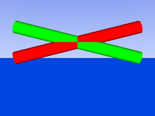

Following what Sir Charles said, this is what two solid cylinders
intersecting look like.
-tgq
Download 'TestIt.JPG' (44 KB)
Preview of image 'TestIt.JPG'

Yeah, it is not finished, just experimenting. The 3D titles and
legends work better when viewed stereoscopically. Of course
none of that contributes to clarity of communicating data.
It is just for fun. Sometimes I wish the data that I work
with could benefit from a three dimensional representation.
HB

Yeah, now i recognize that I just expected it to
behave differently. Expected a smoother transition.
HB

I suggest reducing the extrusion depth to a readable level.
-tgq

Don't use cylinders/sphere sweeps, sharp edged rectangles, then you'll
get a merged colour at the intersections, just round the ends off with
a macro or something.  And like others said make the text flatter.

You could also try making the sides of the extrusions a different
color than the faces. That would make it much easier to read the face
of the type, without sacrificing the 3-D look.

You could use blobs to make a smoother transition.
Corey
